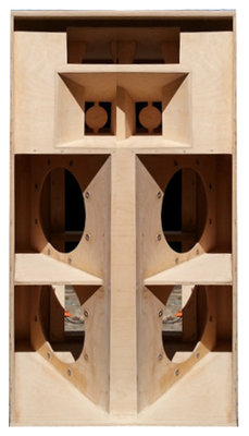

draehn! I like it! Now we need a front view (thanks for tolerance Bill):
The Omni 15 BigBoy in the 4-12 configuration :lol: . Would that thump or what?
--aeolos
Readers please note: this IS NOT a real photograph of a real cabinet, nor does it depict an actual Bill Fitzmaurice cabinet design. We havin' fun is all.
Although I must say, looking at it, it's interesting :) .
Well, either it will work, or it won't.

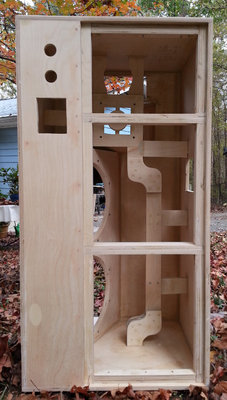

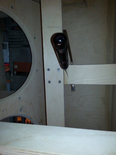

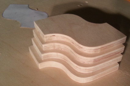

The fix operation begins. First, the extensions to move the brace back 2.5":
Cutting the old-and-in-the-way brace out:
more shortly
--aeolos

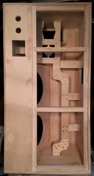

#67 Post by aeolos »

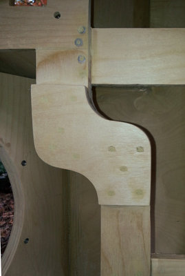

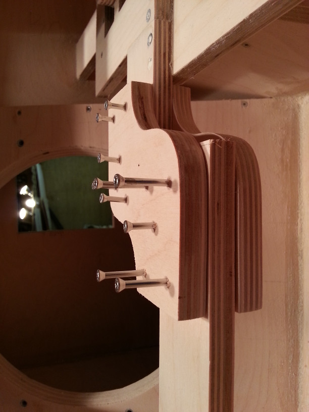

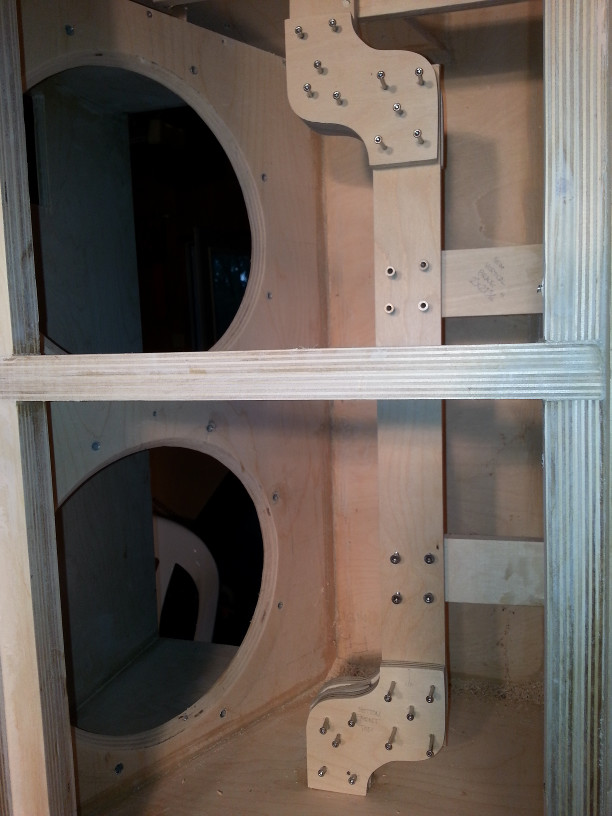

draehn, I adopted your suggestion for a simpler fix than the one originally proposed. Many thanks!
Readers please note: these ARE real photographs of a real cabinet, that diverges slightly from Bill Fitzmaurice's Omni 15 TallBoy design... but only by a little bit.
The camera on this Samsung Galaxy Note II introduces a lot of pincushion and other lens distortion that resists easy correction, but such correction as was easily performed has been done.
Photographs of the dry fit for the fix to the "I mounted the vertical brace incorrectly and so could not fit the speakers in the cabinet" issue:
(at increasing closeup)
and a photograph that I like just as a photograph
Was in a tearing hurry as usual, so some of the screws could have been better aligned for visual appeal, but functionally this fix gets it done and is structurally sound.
In fact I like it so much that I'm going to build it into the second cabinet as well. Makes plenty of room for the woofers and doesn't take long to implement, once you've got the pattern for the brace extensions, or whatever you want to call them, those curvy things :D .
Now back to work work, and eventually to complete this cabinet (and someday the other one too, that will go much faster of course). Getting close to turning the first cabinet on, hard to take time to earn a living with this left undone, but oh well.
Will of course post photos with the parts PL'd together and sanded down when possible.
best
--aeolos

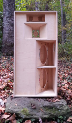

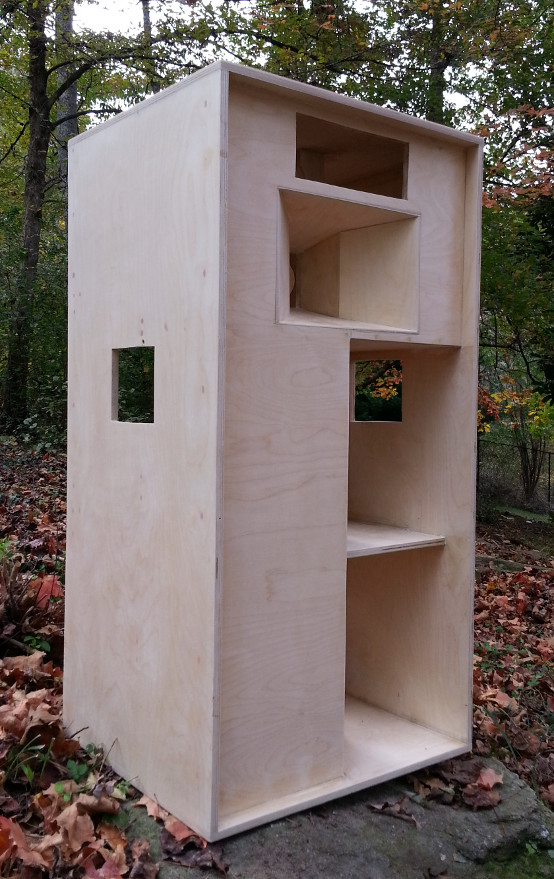

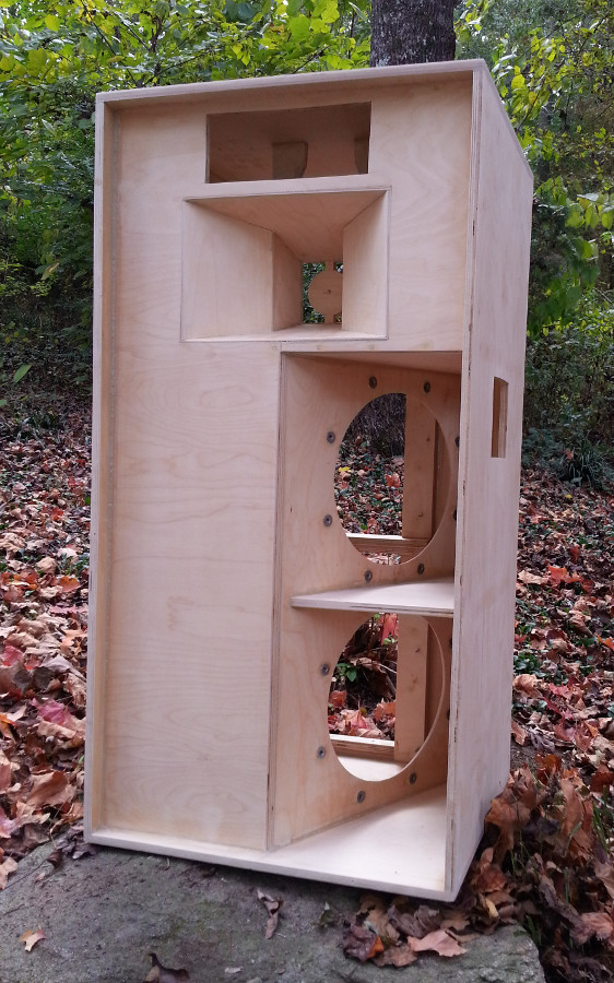

Milestone: the first cabinet is major-woodwork-complete :hyper: ! Vertical brace fix glued&screwed, all holes filled (and I really like auto-body filler for that job, it sets fast and hard, thanks Bill), external sanding through 220 grit complete. Have cut the baffle restrictor plate but not yet installed it, need to put in the T-nuts for that and for the 12" steel grilles for the woofers, and run one more PL fillet along one seam between the lower woofer horn brace and the side of the cab, and it will be ready for finishing/cladding.
Today's photographs:
and one more pic, bb won't let me put it in this message...
--aeolos

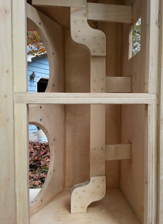

#72 Post by aeolos »
And the final photograph from today. Lots'o'pictures for a little Omni 15 TallBoy but maybe it will help somebody, somehow... perhaps to avoid my bonehead mistakes eh.
Closeup of the top brace-curly-thing-extender-pieces installed:
And that new vertical brace assembly is strong lemme tell ya. The whole cabinet is strong, as noted in the plans. DuraTex and Formica and aluminum and steel next. Then stuff it, and plug it in. Getting down to it, mighty fine, mighty fine.
Thanks again gentlemen
