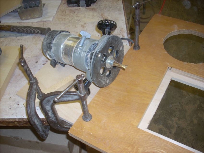

Now for the tools...

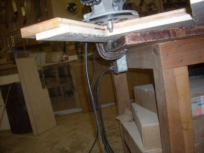

This is a Porter Cable router with a 1/2" guide bushing installed. If you noticed, the router I used for the 22.5° cut was a Bosch. We like those a little better than the Porter Cable, but only the PC has a base that takes these bushings.

Had to change the straight bit- the first one was too long.
Put the router up on the guide board and adjust the cut depth to half way - pretty easy to eyeball with the nice plywood. This is not super critical, the other piece is the one we will work hard on to fit this one.

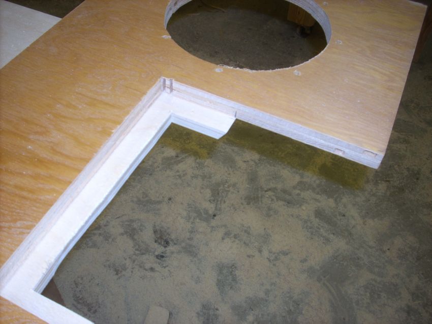

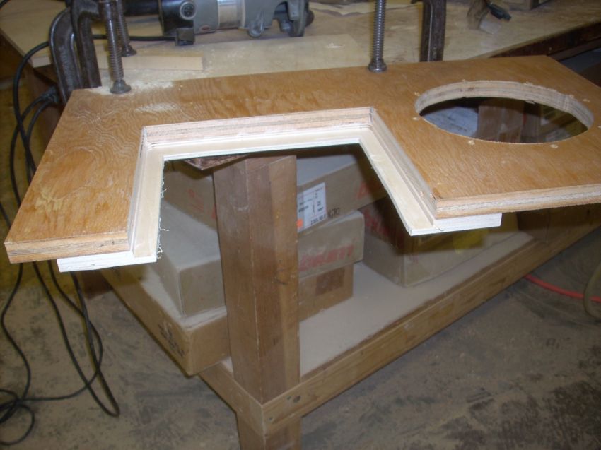

Take small passes around, keep your attention on keeping that router base flat on the guide. Make the last pass with bushing up against the guide board edge.

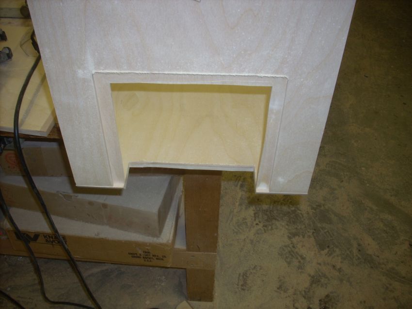

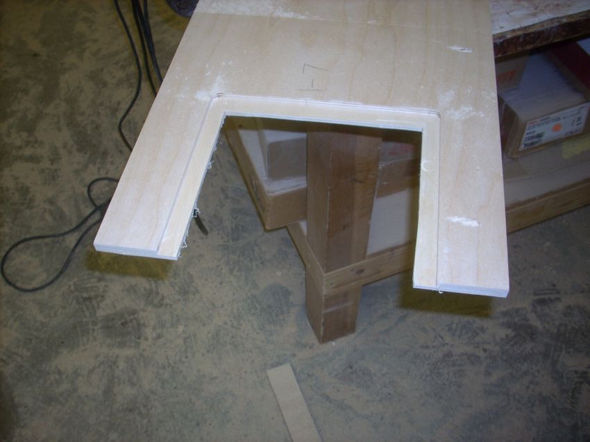

Notice that the notch you cut out is a bit smaller than the size of the guide board opening.
Here is what it looks like without the guide board.

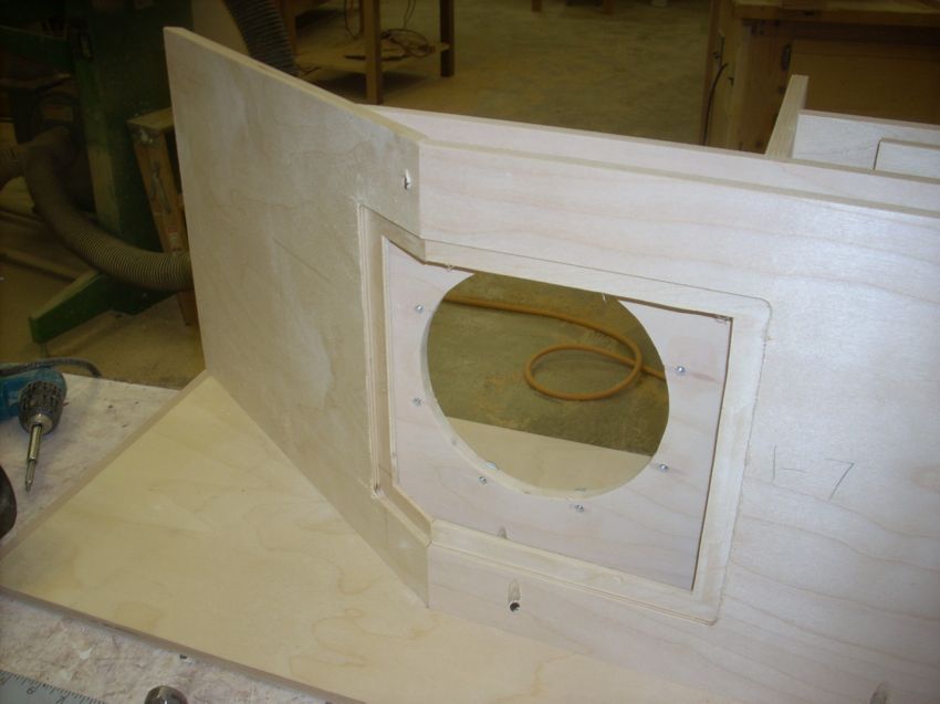

So, when you have this panel routed too, it is time to see how it came out.
Use the pocket screws to put the pieces back in.
Not too bad.
That is all for today.
Looks like it is just about time to get the PL Premium out...
Not too bad.

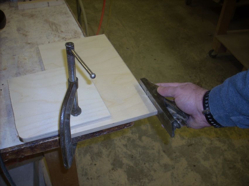

I also staged a little photo showing how the hand plane can be used to bevel the panel edges.

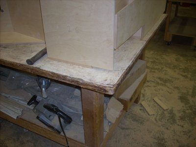

And in the interest of full honesty, I did not use that hand plane to dial that panel in just right - I un-clamped it and slapped it up on the edge sander. I love that thing! (I have done plenty of hand planing on job sites thinking about the nice edge sander sitting back at the shop with every stroke.)

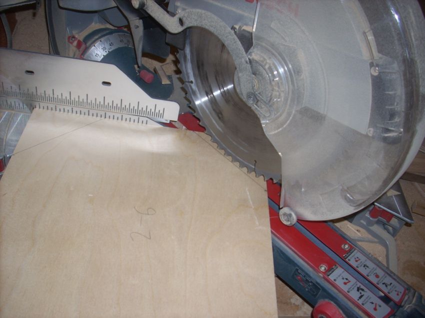

The next thing I decided to do was get the top pieces cut out. Put the front up against the cabinet as it was sitting and marked where the angled edges were.
publicIdaho
- Posts: 259
- Joined: Wed Nov 07, 2012 3:56 am
Re: Davids for Tom

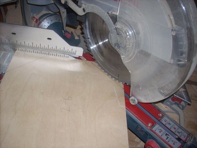

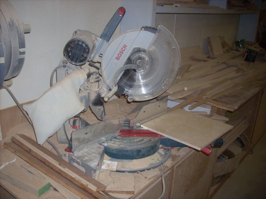

Then it was over to our newest big toy.
This baby is sweet - it has the articulated arm that comes out to extend the cut.
publicIdaho
- Posts: 259
Re: Davids for Tom
Did not have to unlock the arm, it could handle the cut as a regular chop saw.

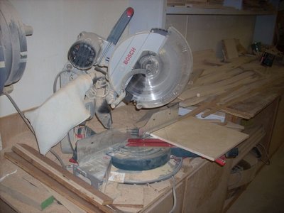

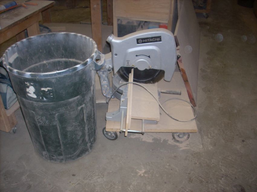

Here is what the new saw replaced. It is a monster and can handle some things even our fancy new saw can't do. Unfortunately, the motor armature winding is messed up and destroys brushes. We could have fixed it, but it was a good excuse to buy the new saw we were lusting after.
Now we need to get rid of it. It is a monster to ship, but I am planning on heading from Idaho to Southern California after new years to deliver the new speakers and I might be able to haul the saw down too if there is anyone out there who is on the way and would like to get a good deal on a fixer upper saw. It is a 14" Hitachi.
