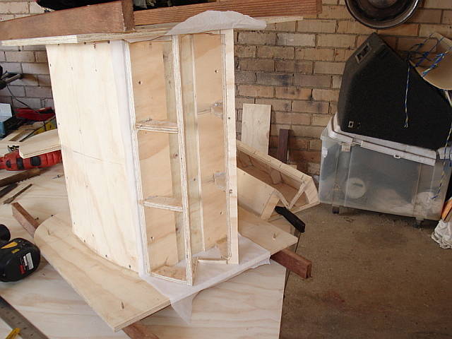

I cut and assembled the framework for the module on Cab 1. I decided I would dub it scaffolding.
I had everything cut and PL'ed in place in 2 hours.

Cab 2 with the module "scaffold" completed and set, and ready to put sheaths on:
Sheaths installed on second module, removed after PL set:
Middle side braces installed on cab one, with a side view of module 1:
And looking down into the tubes:
Pardon the mess, that's bog (= bondo) over the module face and tubes
