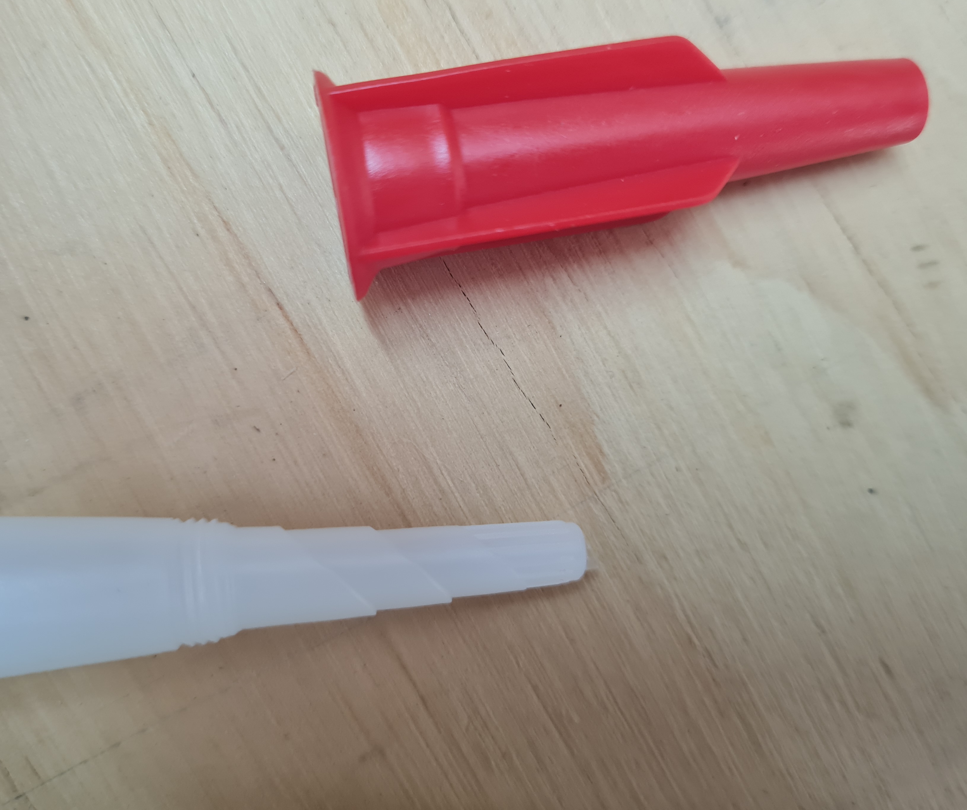

Ok, so this is Unobond. The first impression was it continues to ooze out all over everything like PL, though the tube has a great cap, properly threaded. I'll be keeping it in the fridge too, a Loctite rep told me this tip recently

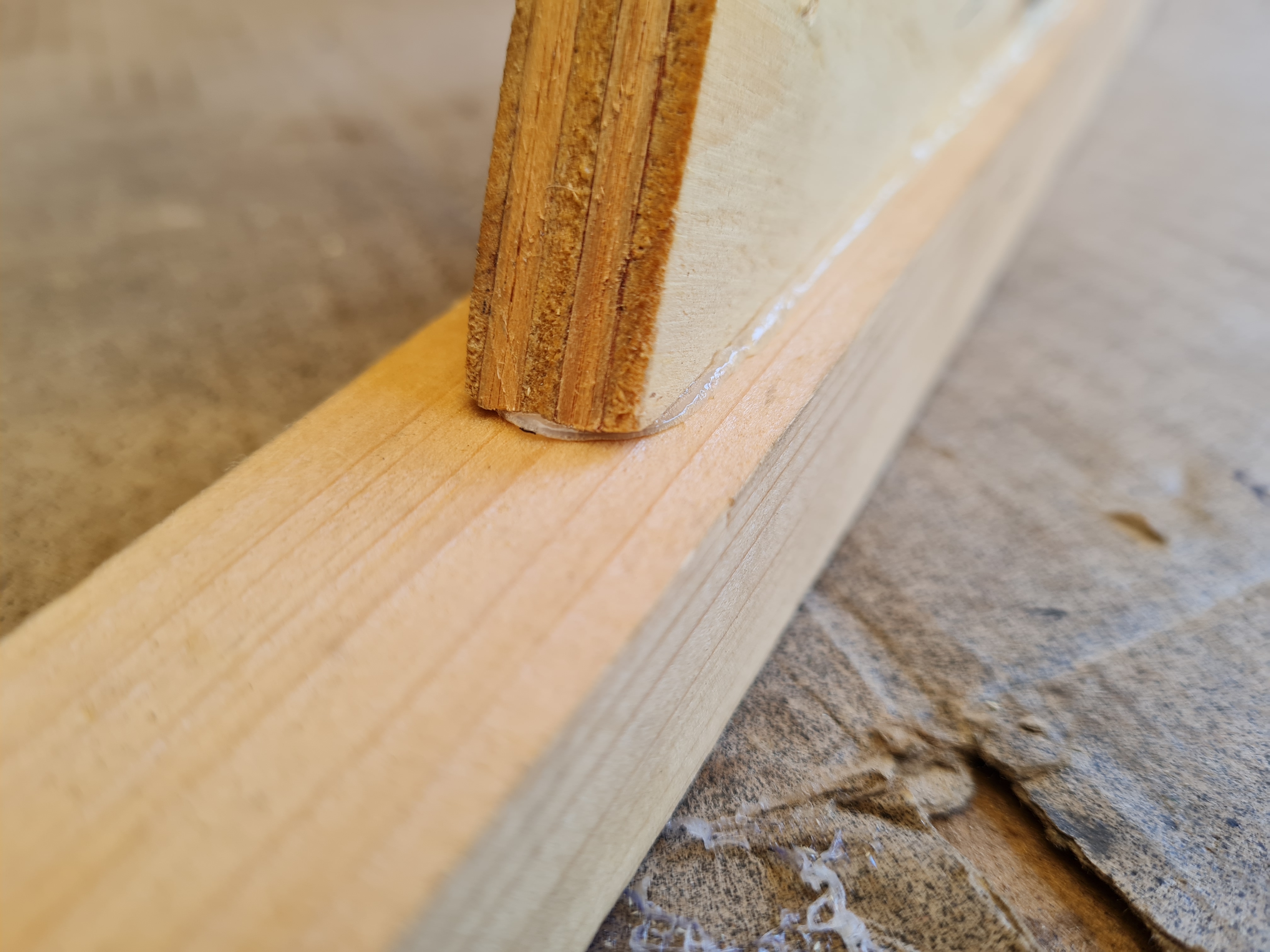

Initial fillet

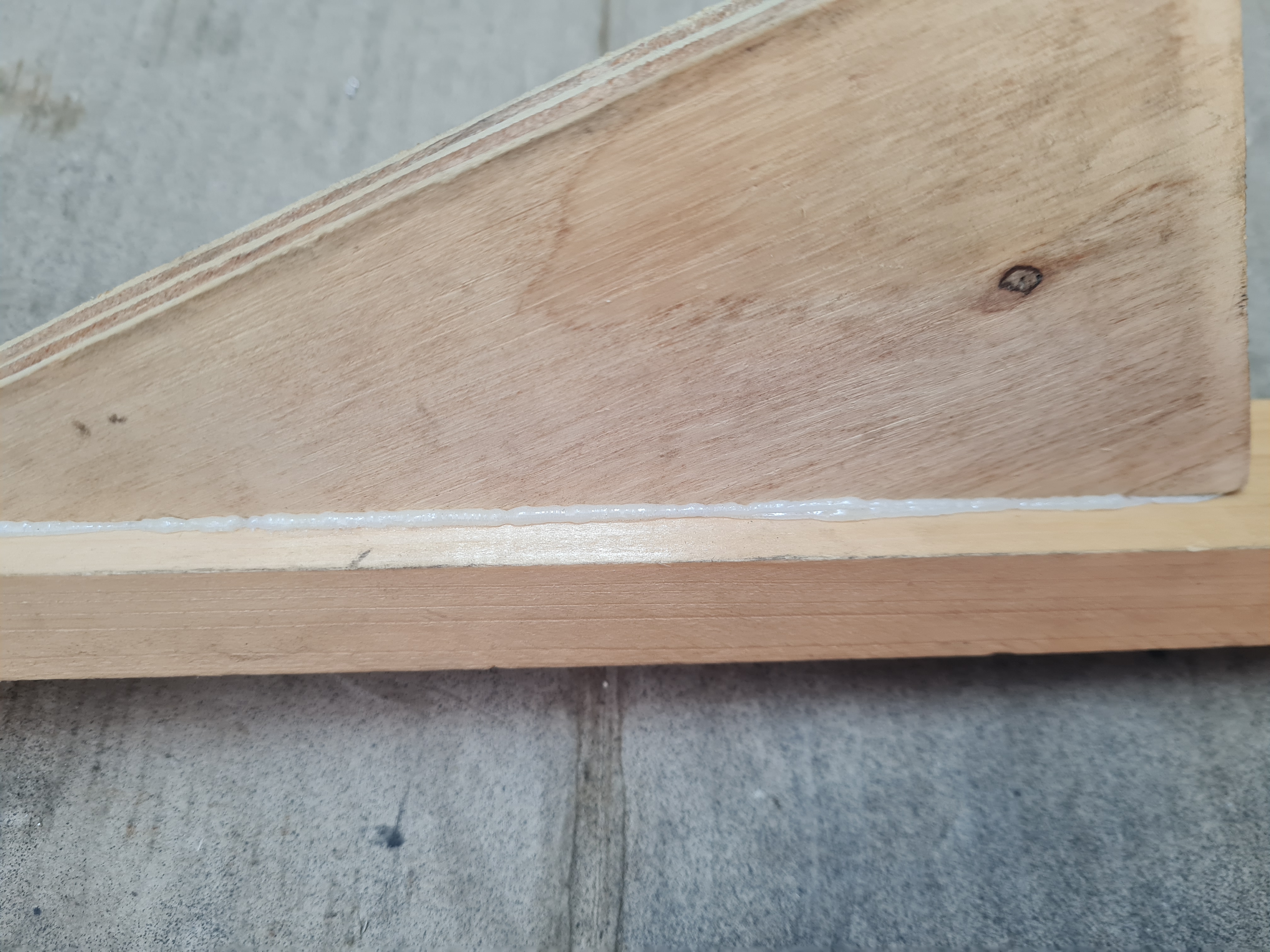

Screws up from underside, initial squeeze out.

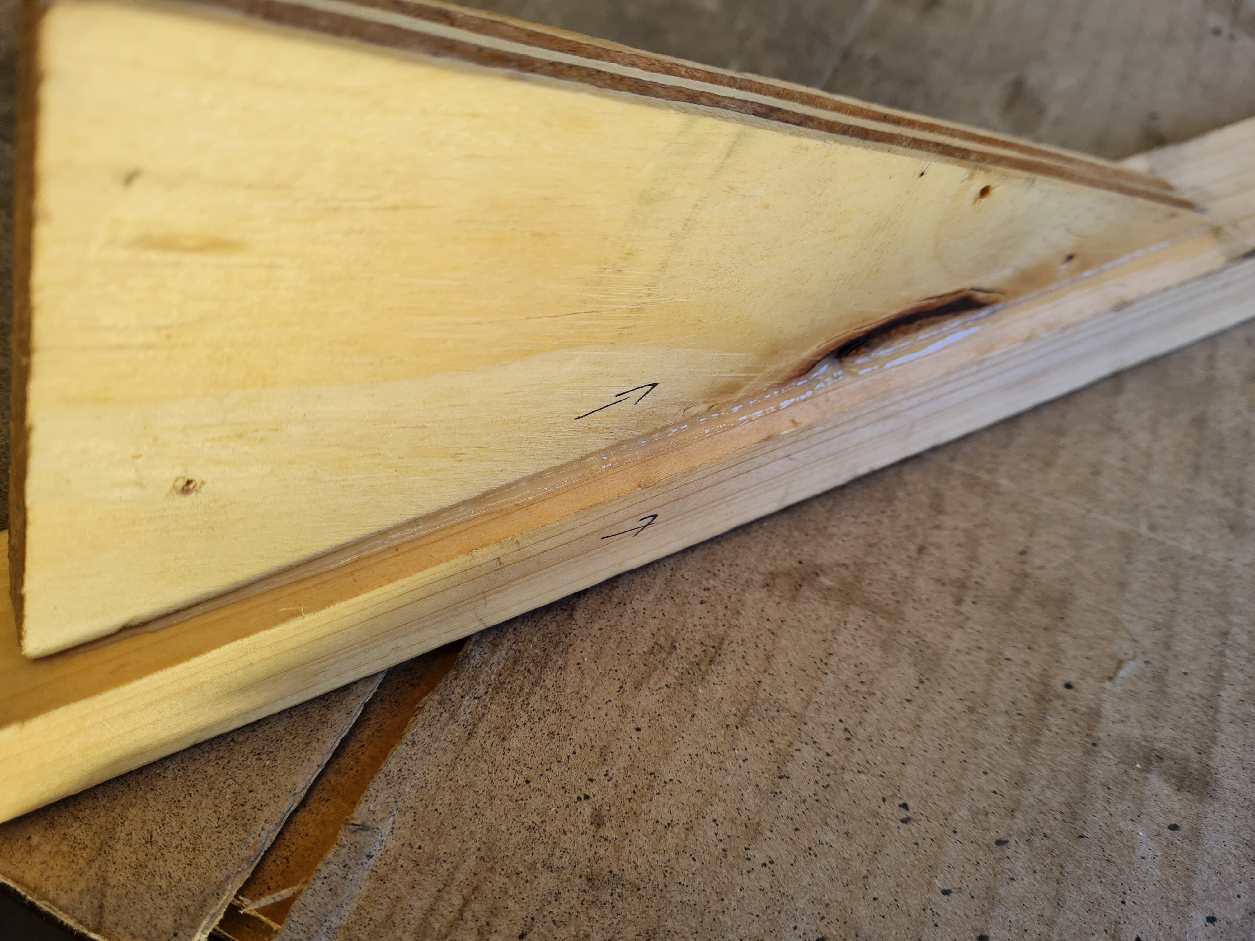

1mm gap sanded off at the end to see how far it expands.

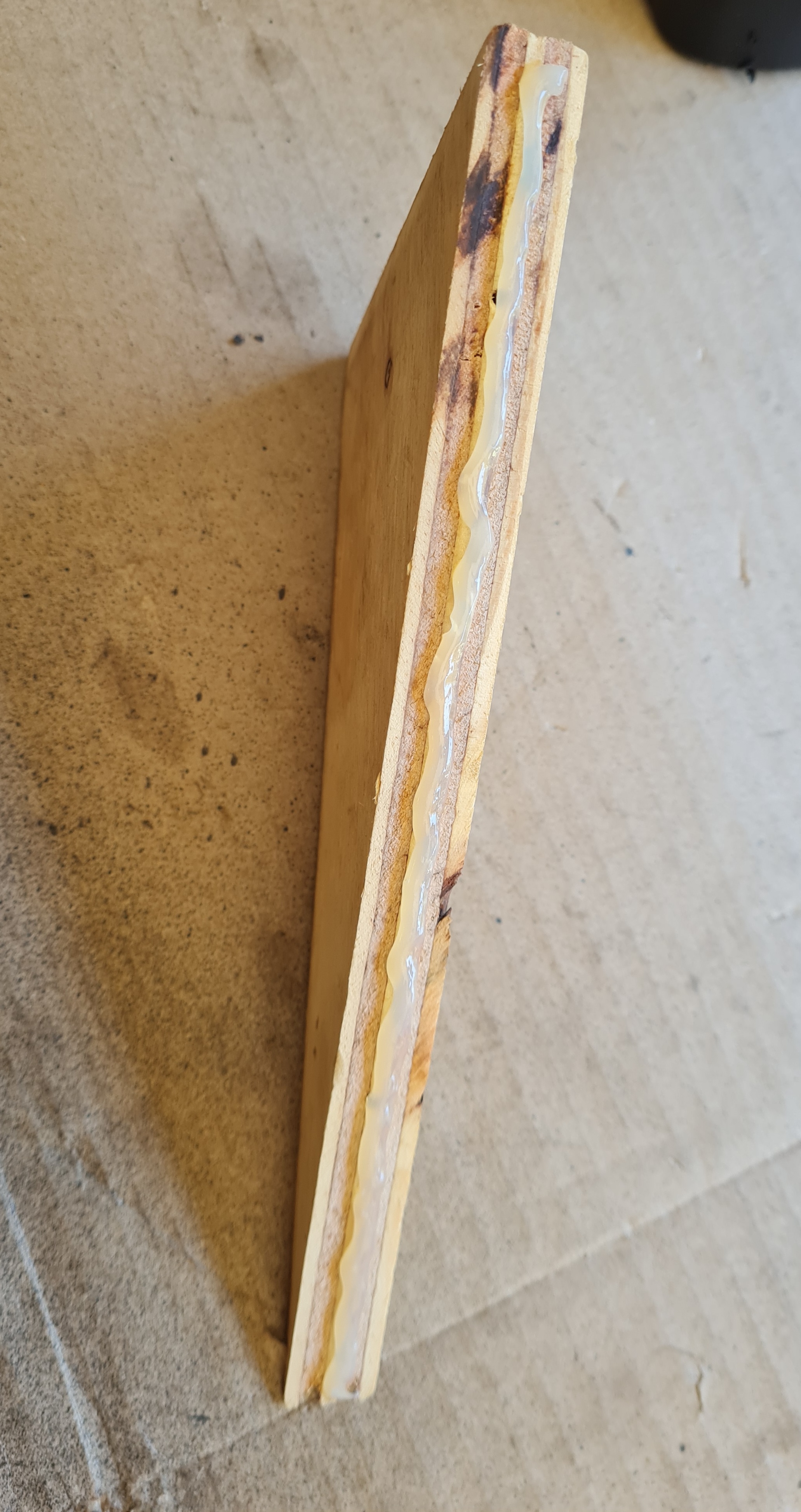

After 2 hours, I'll chisel off one side and leave this for 24 hours.

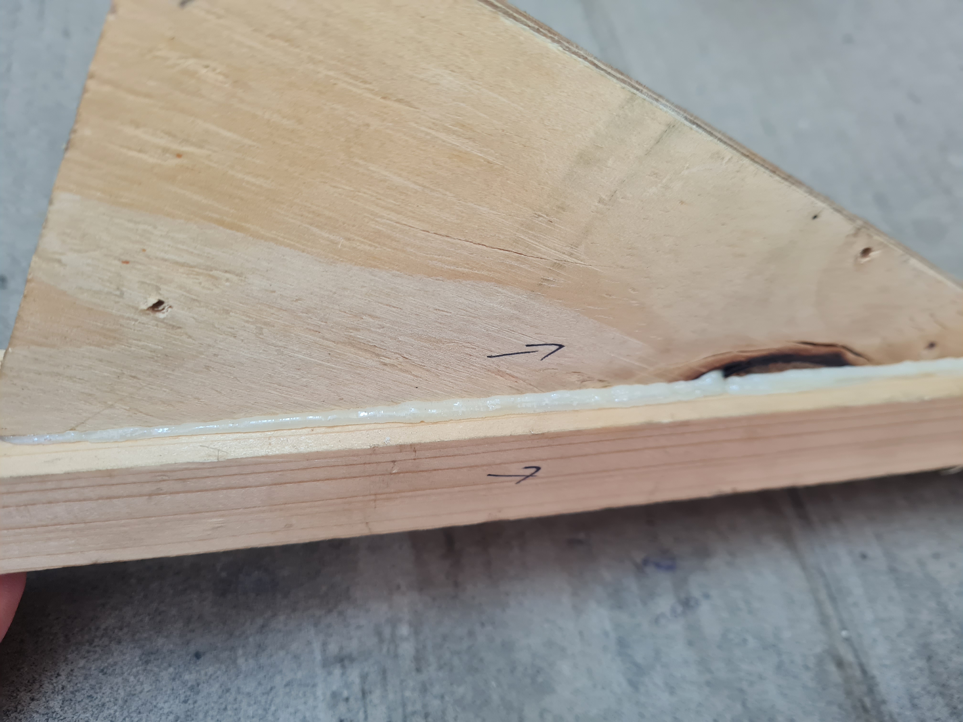

No further noticeable expansion after 24hrs. Very strong bond though, hurt myself trying to break the join in a vise!
