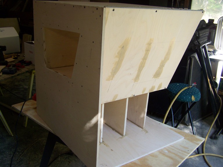

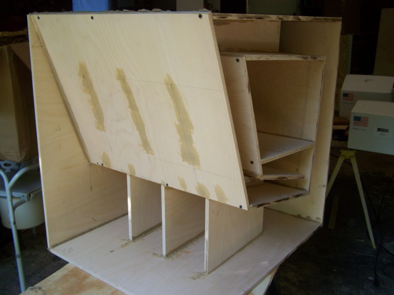

#71 Post by doncolga »
shawn_g wrote:A clean shop always makes a big difference for me, it doesn't usually stay that way very long though.
Have any recent pics of your progress that you can post?
Don't know why I was thinking 27". These are 26". Working on the last little bit.

shawn_g
Posts: 386
Location: Logan, OH
Re: Lab12 T30's
#72 Post by shawn_g »
Looking good! :clap:
