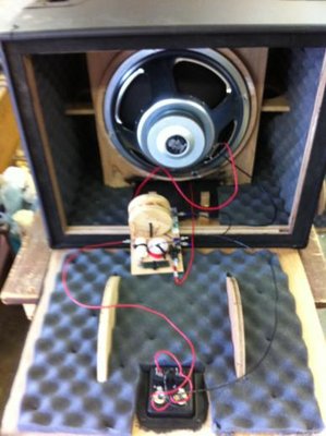

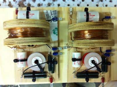

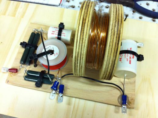

The cross over filters I made with the assistance of a good friend of mine.
Doing the final wiring
Ta Da!! :-) :-)

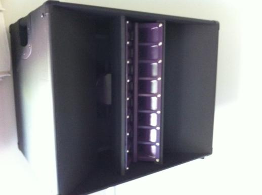

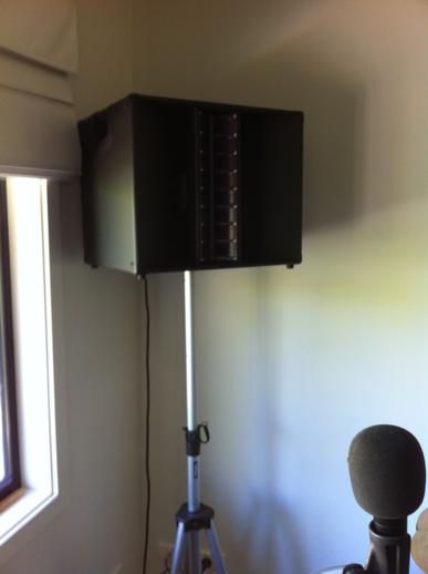

Finally got around to taking the jacks out for a ride on the weekend so I though I'd post the final photos.

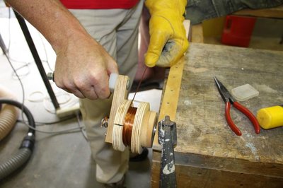

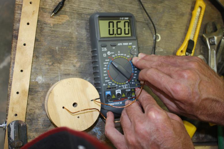

Winding the inductors
Looking for 0.6!!

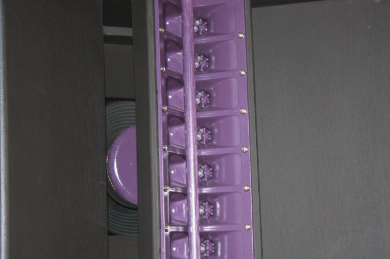

Closeup of one of the Melded Arrays

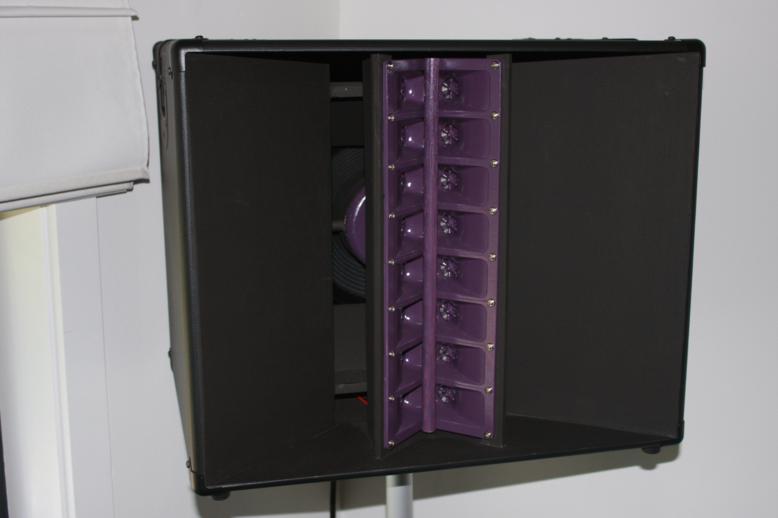

Finished, up and running

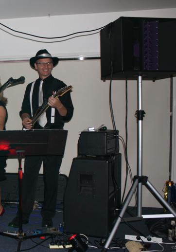

Being used in a hall in front of 120 people (Yes, that's me)

Final comment after the gig. Wow these jacks are loud and clear.
The hall had 120 people in it and would probably hold 250 max. We ran just the two Jack12s and a Jack12 for bass guitar. All guitar amps were used as monitors and mic'd through the jacks for front of house. The sound was great.
Everything well worth the effort.
If you don't use neo drivers just beware that a Jack12 is probably too heavy for one person to safely put it on a stand. With a neo, no problem.

Quick update. One of the "fins" I added to hide the back of the arrays did end up getting a buzz vibration in it. Took a while to find it cos it only does it at G# !!
Easy fix though, just shoved a small wedged in between the fin and the array. All good now.
