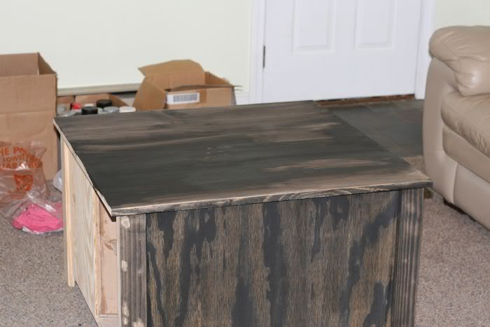

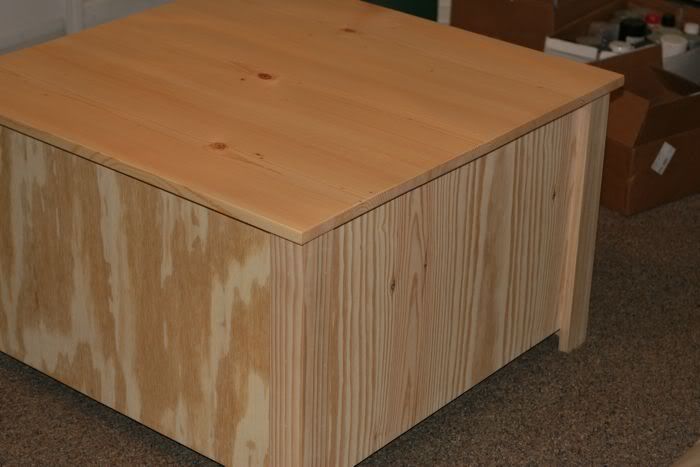

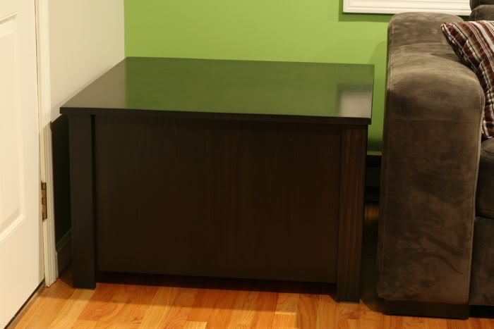

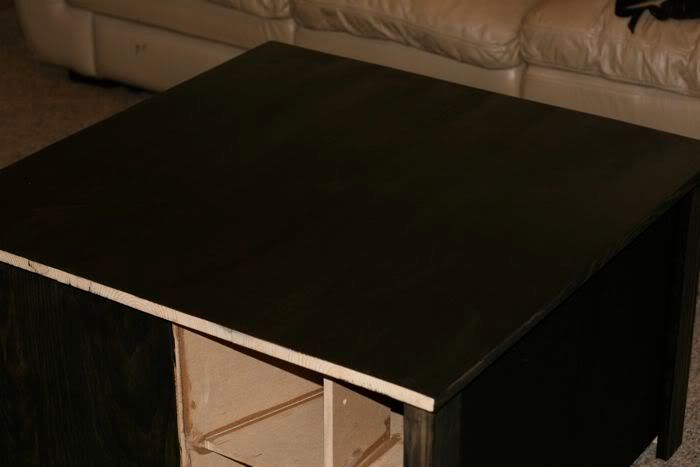

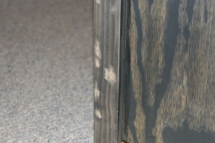

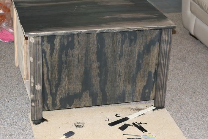

#67 Post by digital_chris »

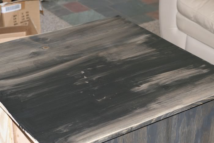

Ok, here are some pics of my staining journey to the finished product...
First coat of stain when I messed up the top :-/
Here is where I didn't sand down the putty enough...
Almost done...

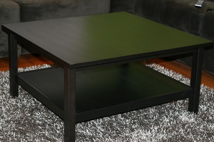

And the Final Result along with a picture of my coffee table to show that they match pretty well, the cab appears lighter in color in the the photo but in person, it matches the table quite well...
