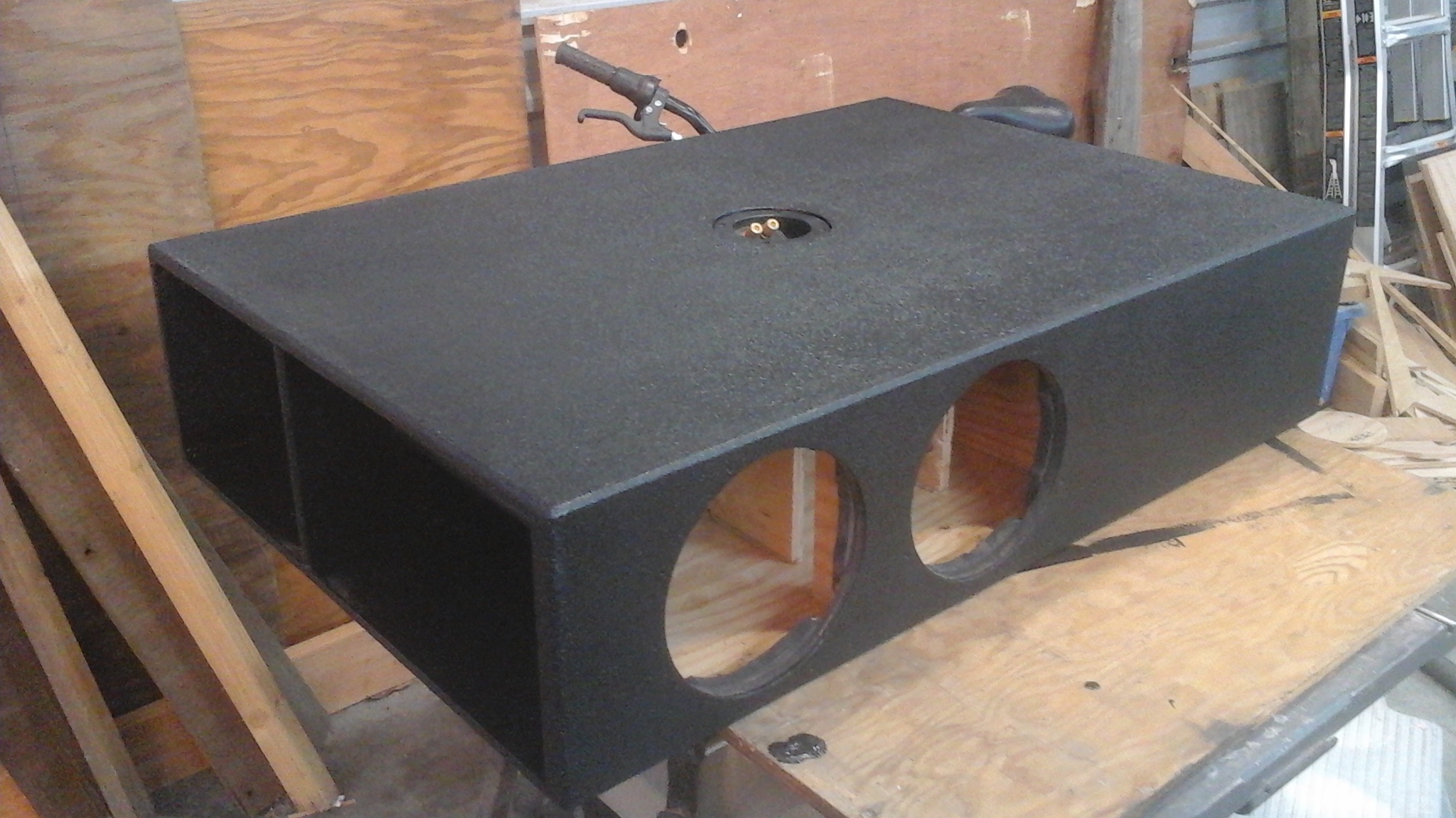

David, other than any touch up's and final details, it's all ready for final assembly in the morning. I'll put it on a scale afterward and let ya know.

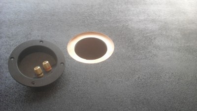

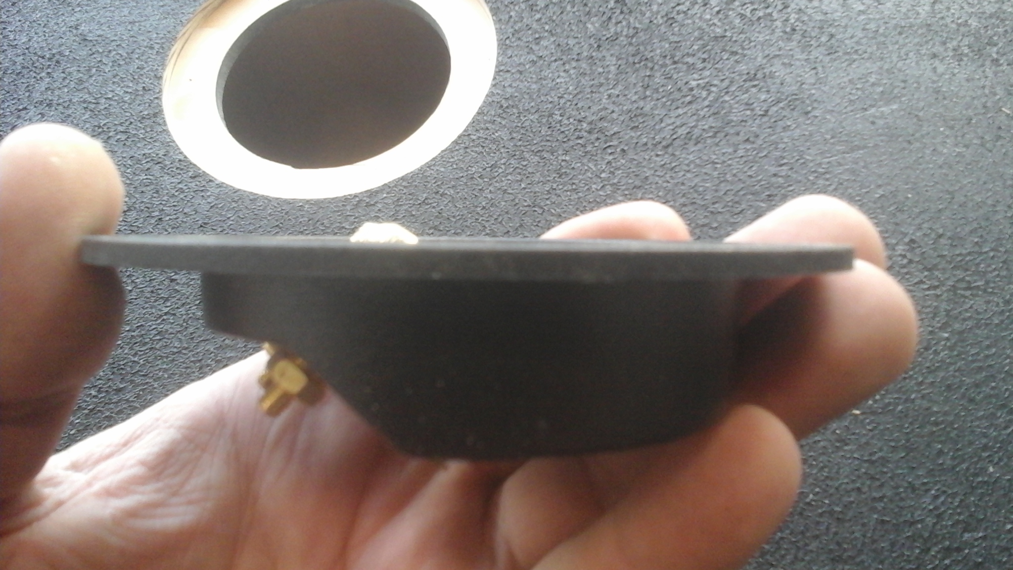

The terminal dish I have has the nuts proud of the dish surface

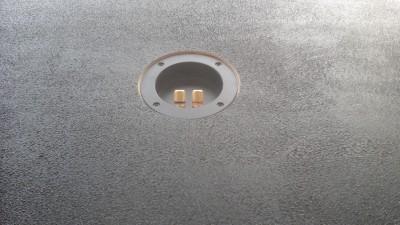

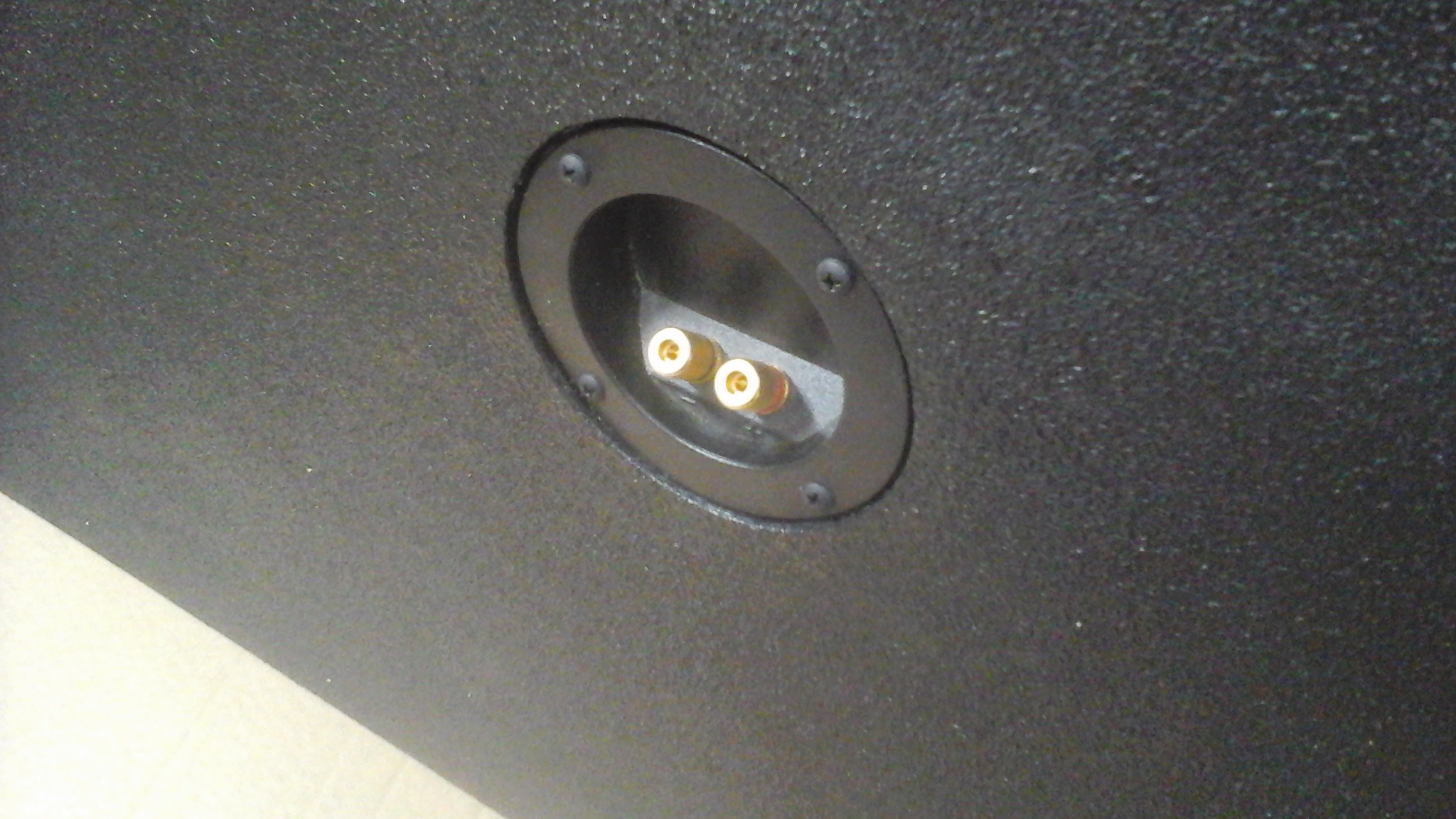

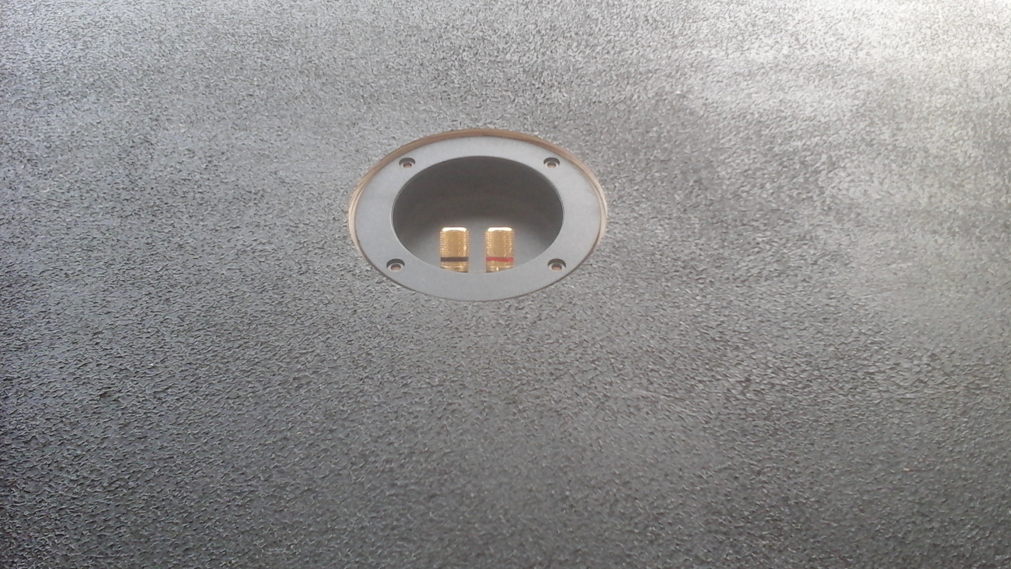

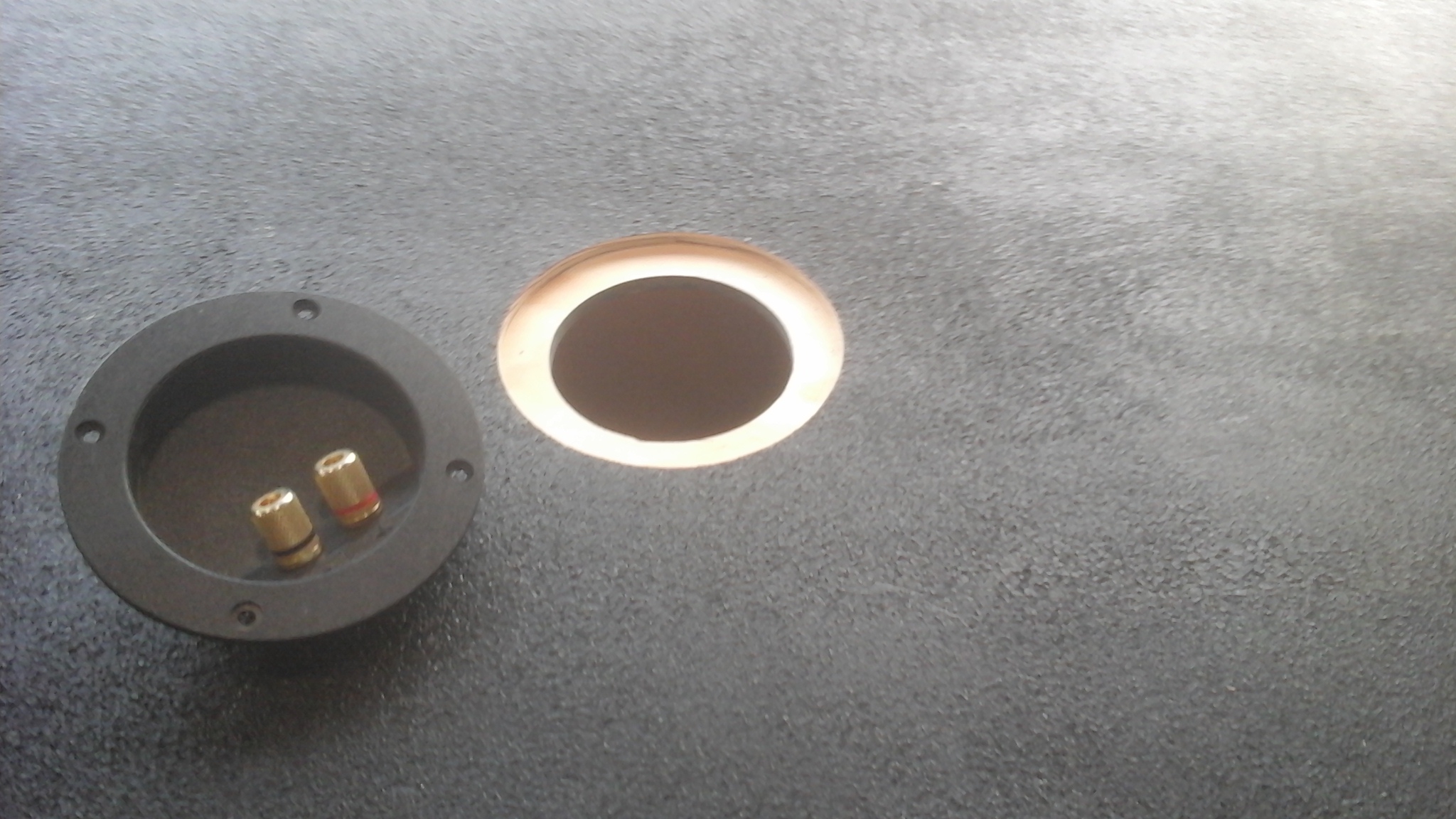

The dish is going on the down side/bottom of the cabinet and to avoid potential issues with them breaking or cracking the plastic dish, I decided to inlay it below the cab surface.

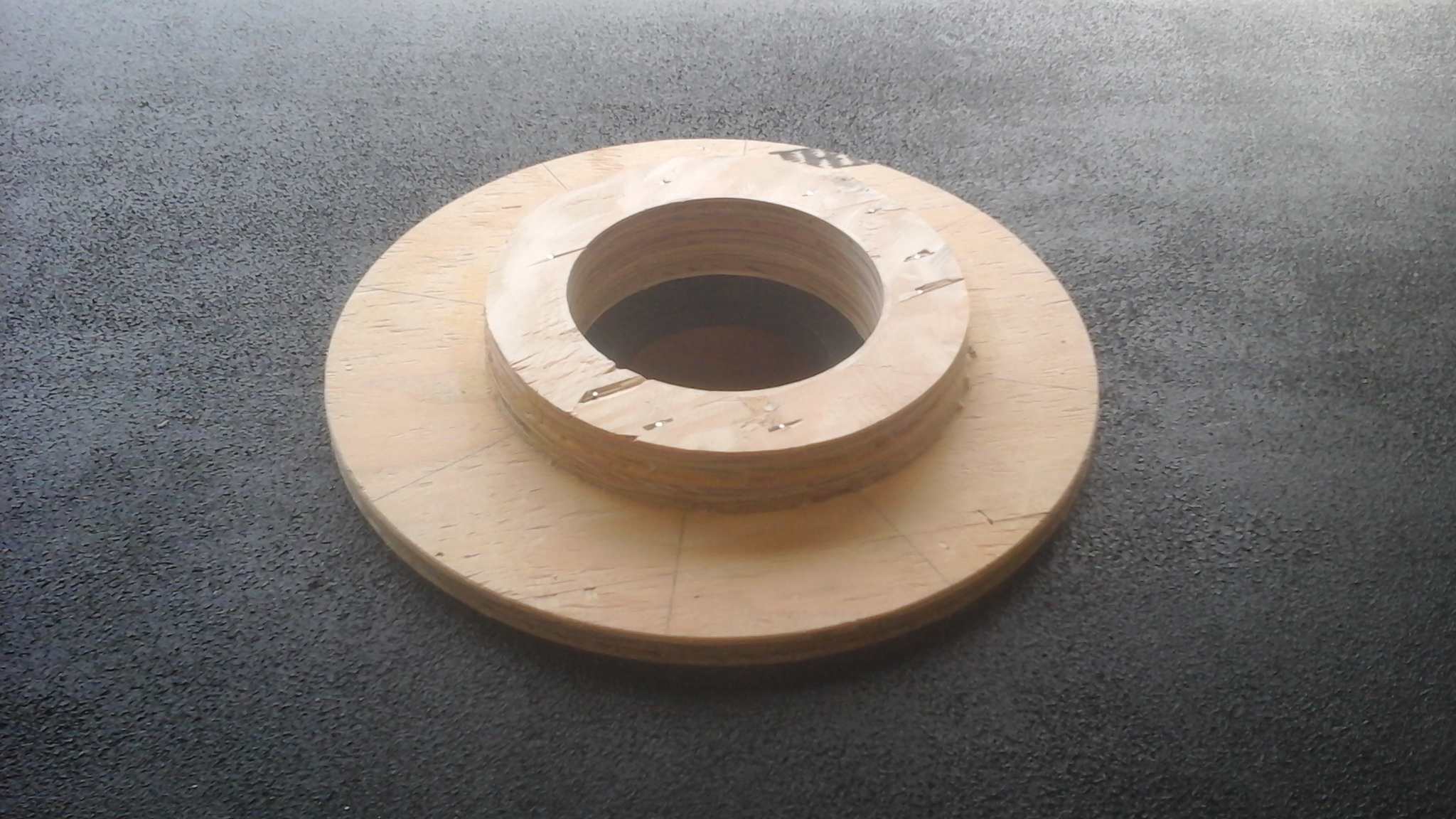

I have a flush cut bit, but didn't have a pattern bit with the bearing on top. The only one I could find in town had a 1" deep cutting surface. I would have preferred half inch, but anyway... I had to laminate 3 layers of scrap for the "pattern" circle in order to accommodate the length of the bit and not cut too deep. I kept track of cut depth with the depth finder pokey out dealeo on my digital caliper. Depth of cut was just under a quarter inch, at 0.225". The location of the dish is essentially triangulated and very near panels 2,6, and the mounting flange of the old driver location. I'm not concerned about the remaining flange thickness. Although I may add some anchor blocks for the screws.
Made the bottom layer bigger so I could tack and hold it in place with 23 gauge pin brads
This is the side that had the driver hole in it. Can't tell at all.

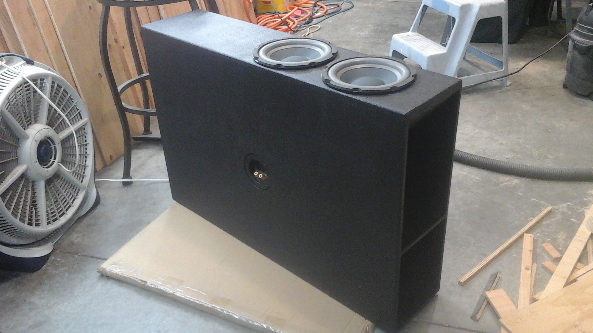

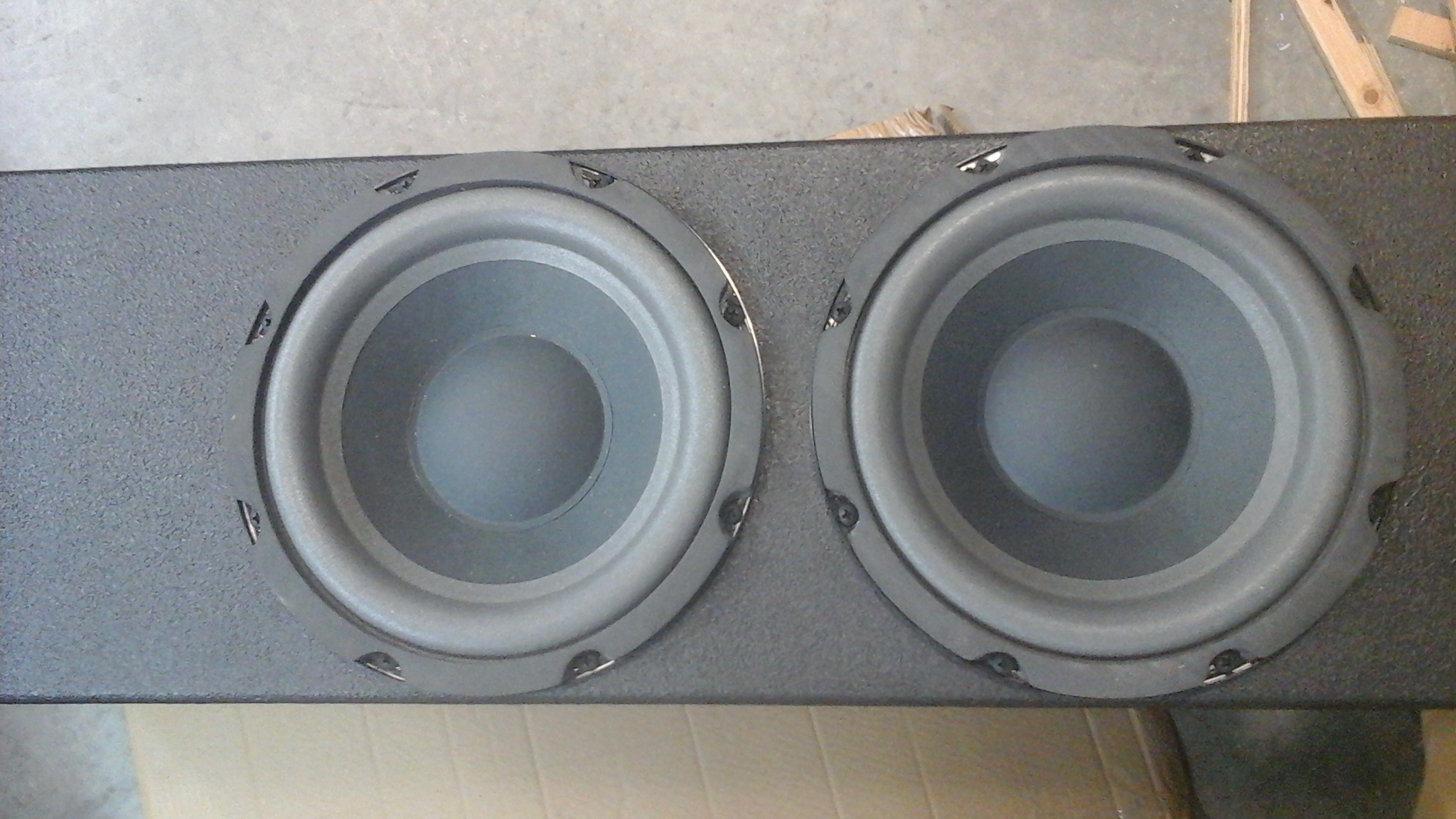

Decided to go ahead and put it together tonight. According to my $10 bathroom scale its 54lbs./24.5kg fully loaded.
. . Drivers haven't been broken in yet. I'll put them on the bench tomorrow. Gonna need to put an amp in the car too.
