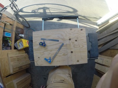

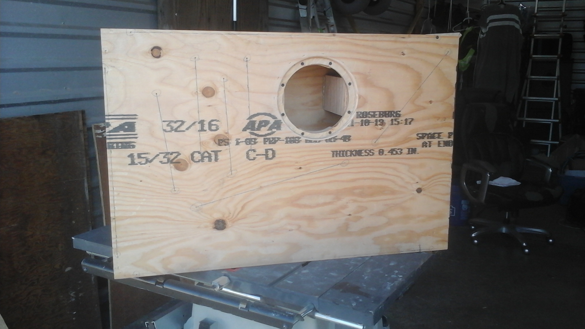

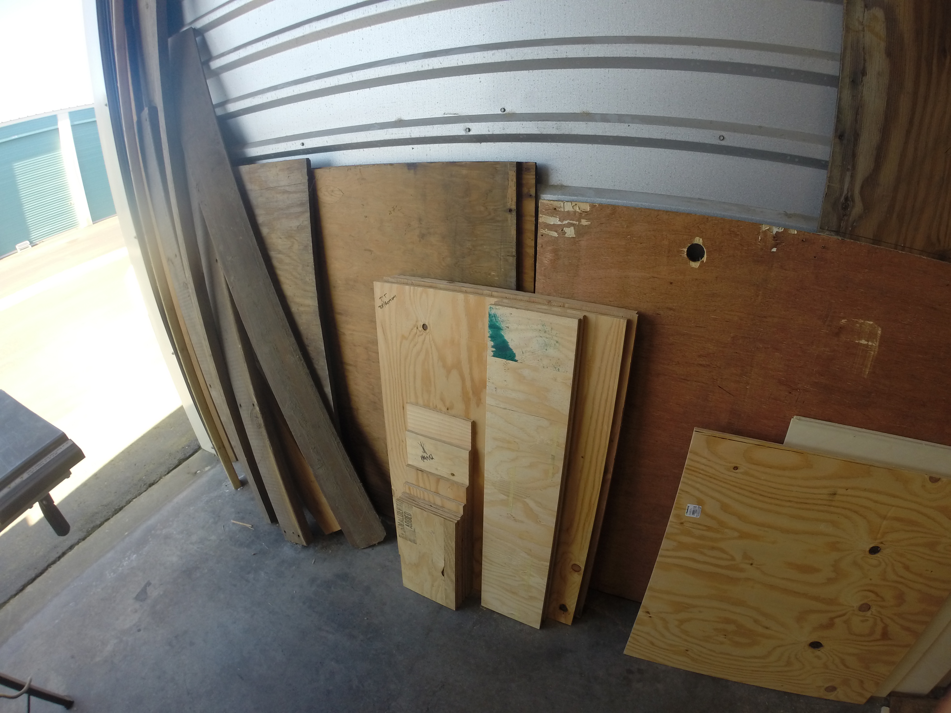

I was looking at the pile of lumber I have that's supposed to become four 30" T39's and thought that I'd better get to it before it becomes one of those things "I'll do tomorrow". So I started pre-cutting everything and got all the pieces done for all four and pretty much ready to start step one, drawing out panel locations.
But then I took a look at the leftover lumber and thought to my self, "I bet I could make a whole TruckTuba with that and still have enough scrap to do all the bracing in the T39's".

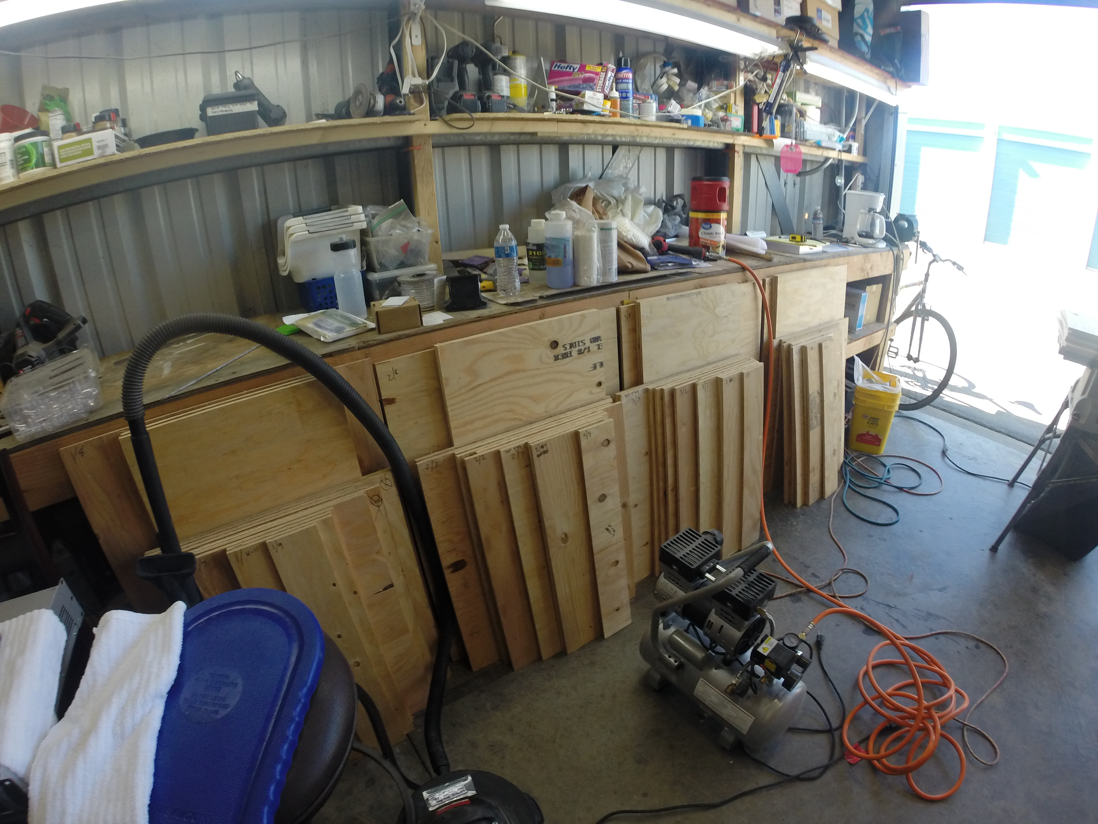

So, I cut up all the pieces for a TruckTuba, 7½" panel width, 8½" cab width, 9½" overall on 1" stand off's/feet (driver will be down firing).
I glanced through the plans... seems like a really easy build.
Let's lay it out.
Here's where I ended up. Had I started before noon and not taken so many sit down breaks, it would have been an easy 1 day build.
It's interesting where action taken on a whim leads sometimes.

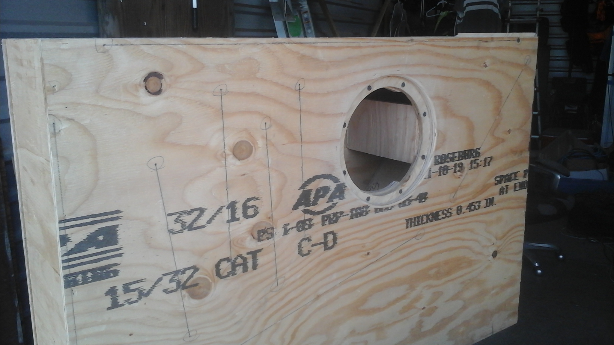

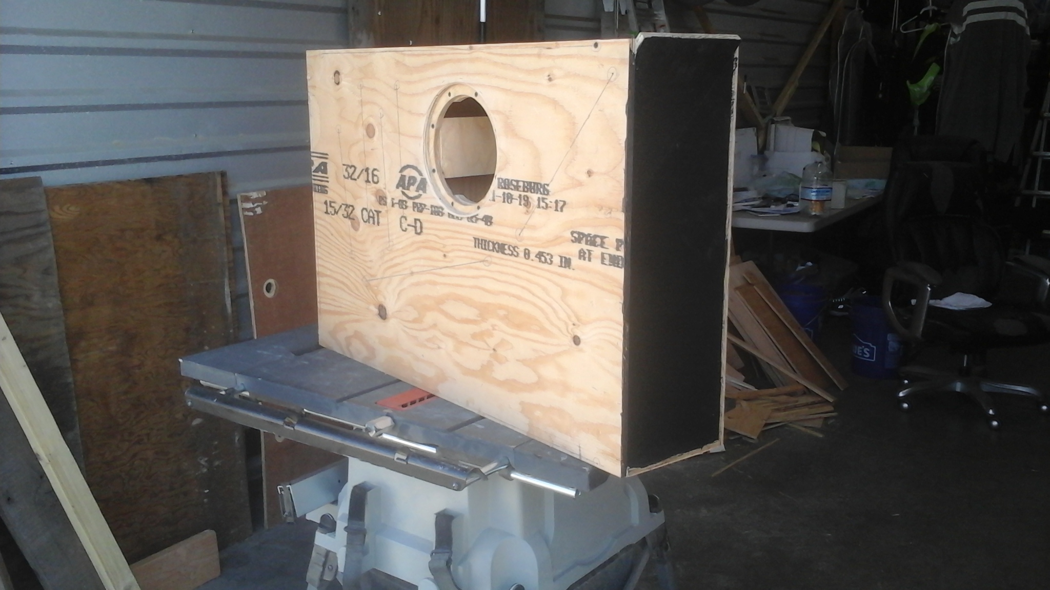

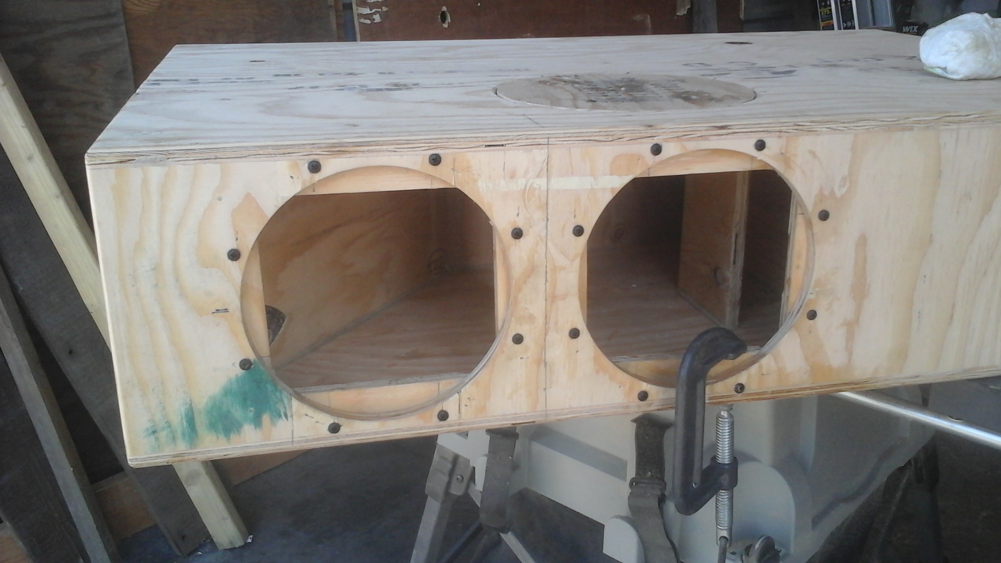

TruckTuba all buttoned up. Just have to trim the tongue off panel 7 and put a jack in. Well... all the finishing work too.
If Bill says it will work okay, I'm going to fill the existing driver location and put two drivers in the side instead.
Since the cabinet will be laying flat, it would put the drivers rear firing on the passenger side, instead of down firing.

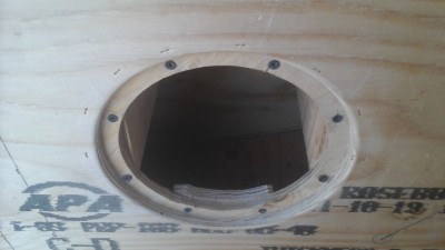

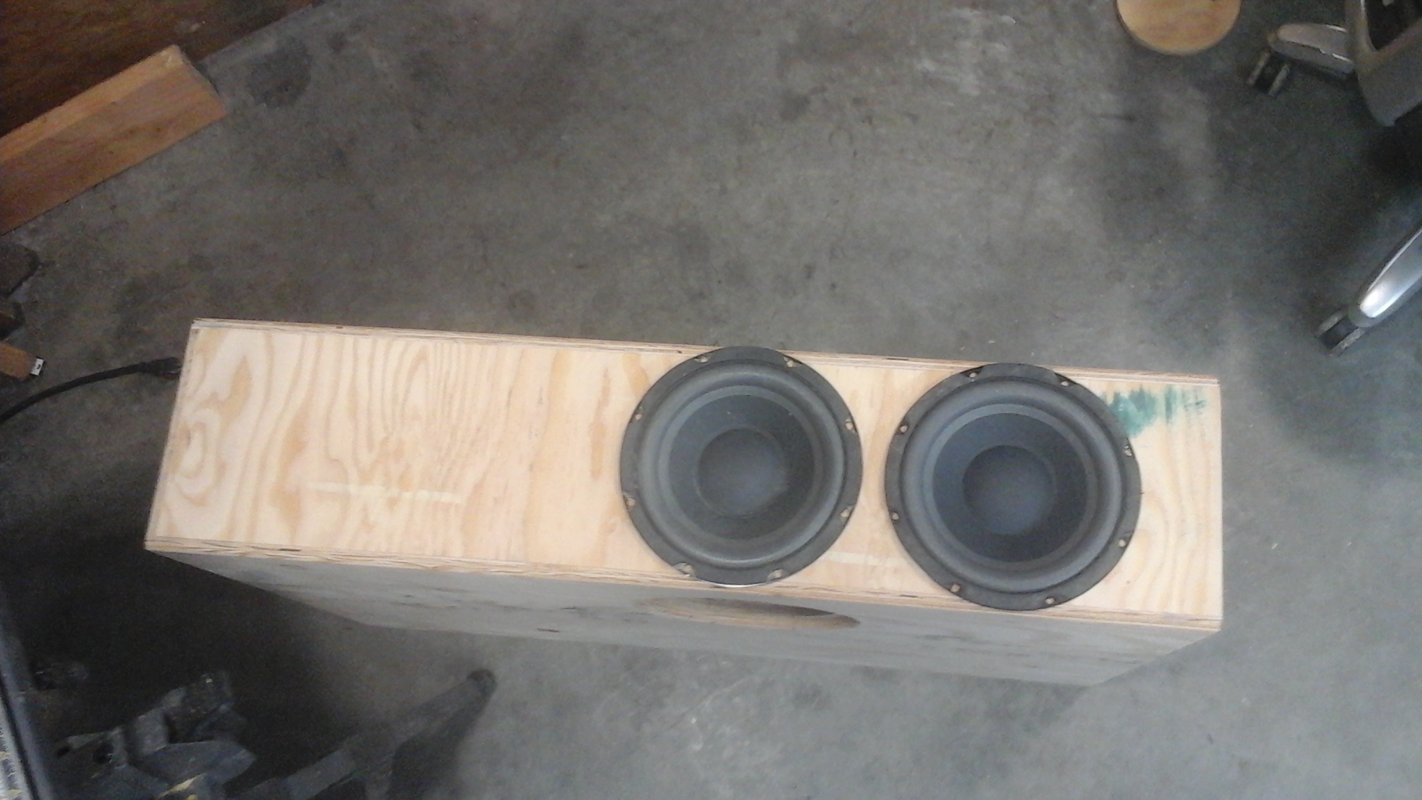

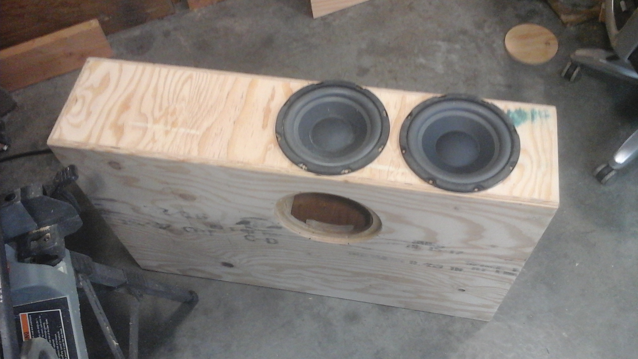

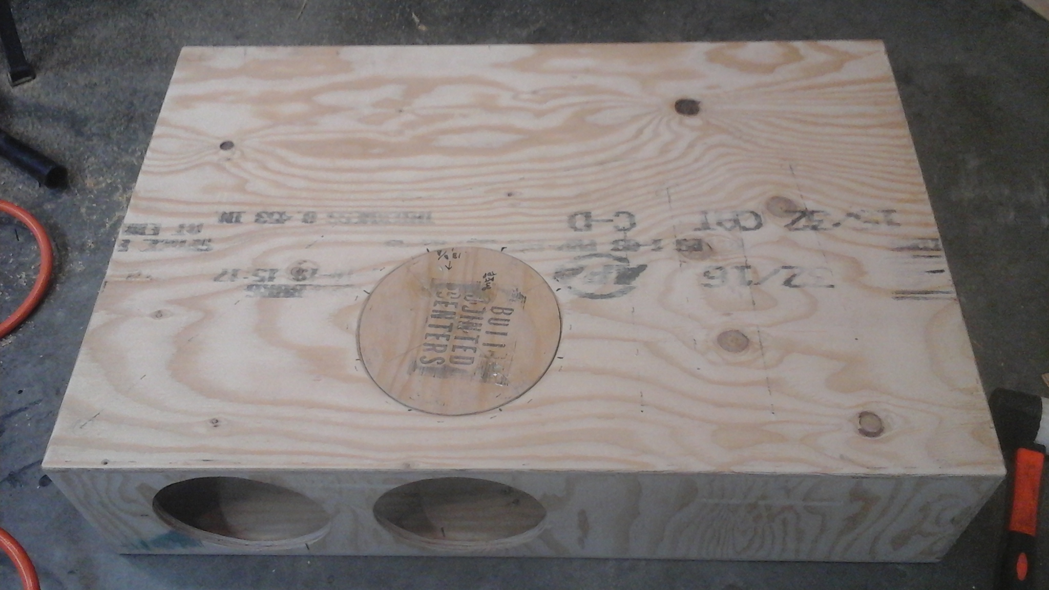

Cut the tongue off (would have been to the right of the new speaker location below), ran the flush cut bit around, and rounded the edges. It always looks so much better after that. Like a clean shave.
New driver location is coincidentally a perfect fit. I'm liking this option. I wont have to put feet under the box now. Hind sight; could have made it an inch wider now that I don't need to lift the box an inch to allow room for a down firing driver. Note to self if I do it again.
I cut a plug from one of the cutouts left over from the T39 build, glued it in place, and tacked it down. I'll get it blended in and no one will ever know it was there.

No reason why you can't do it that way, provided the depth is enough.
Re: What's to chat about?

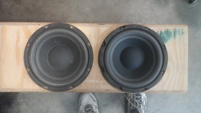

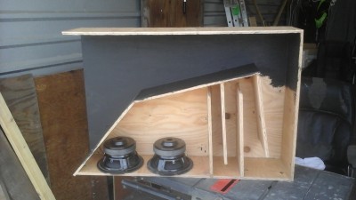

OD of the driver is 8.25", cab width 8.5"... Just barely. I had to be careful with the placement because the drivers are deep enough to interfere with the original driver location bracing. It worked out pretty well and each driver is about the same distance from panel 1's intersection with panels 2 & 7 (3.25 & 3.5").

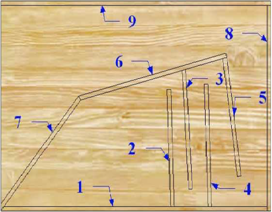

Per your recommendation, I'm going to add a 3-4" gusset/brace between the drivers tying panel 1 into the sides and I'm also adding a 6/9 brace, 7/9 brace, and brace across the mouth similar to how the 10" sketchup indicates.
Just so everyone else isn't in the dark...
(Image skewed and no longer to scale)

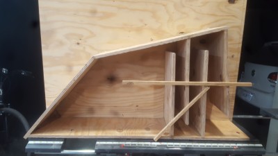

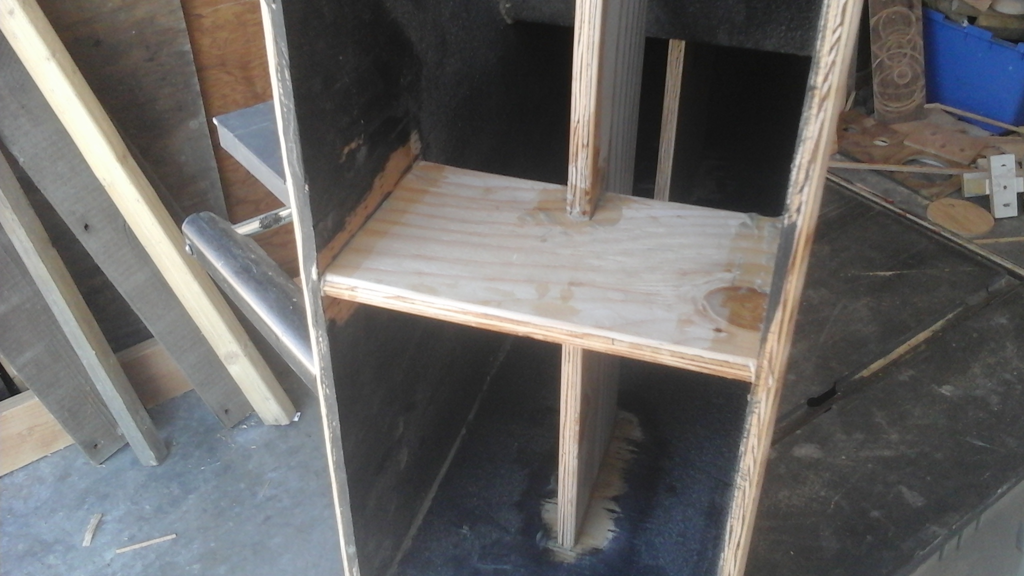

6/9 brace installed. I didn't put one way down in there, but made this one longer than the one in the plans to span as much of the driver chamber as possible.
Sanded away the paint to let the PL bond directly to the wood.

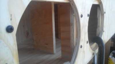

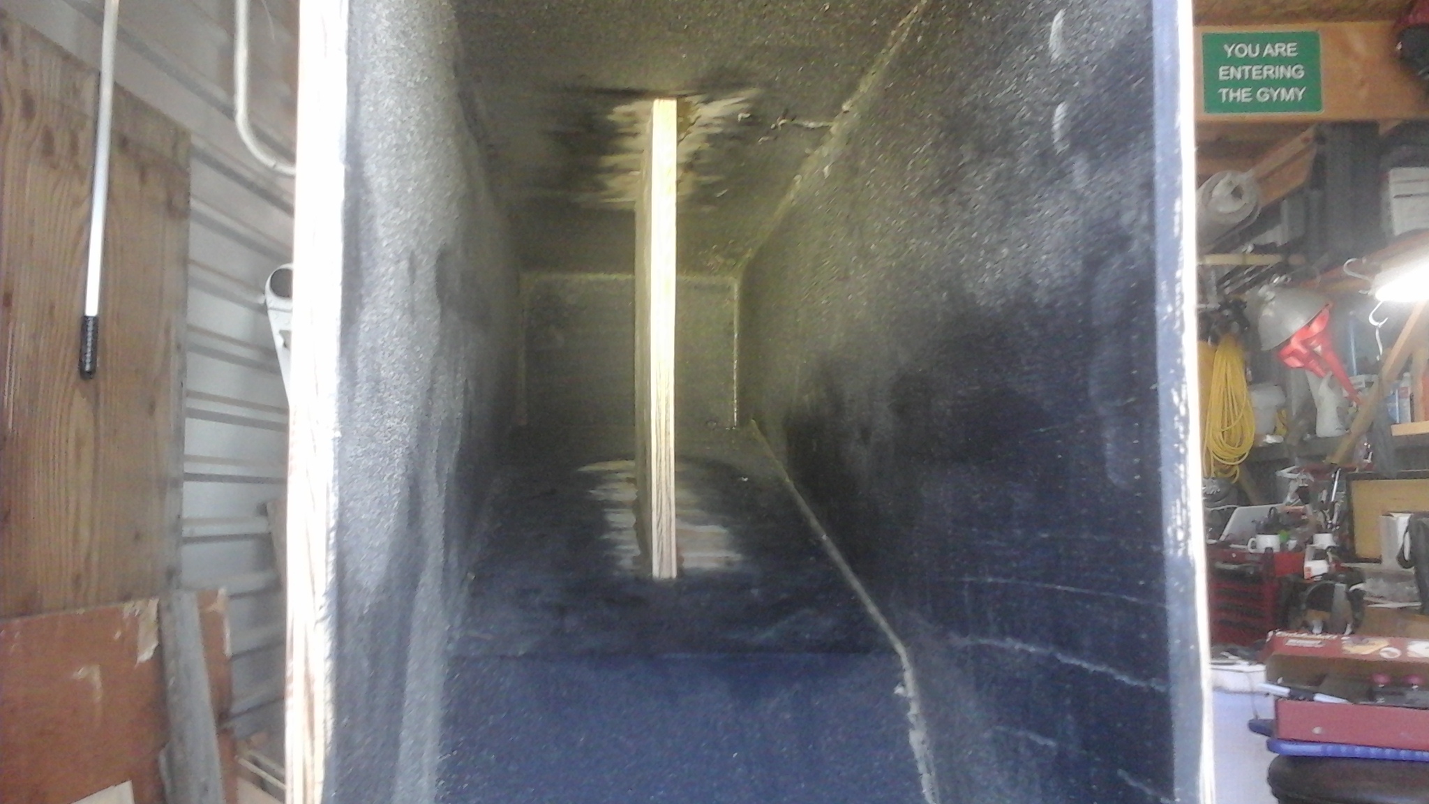

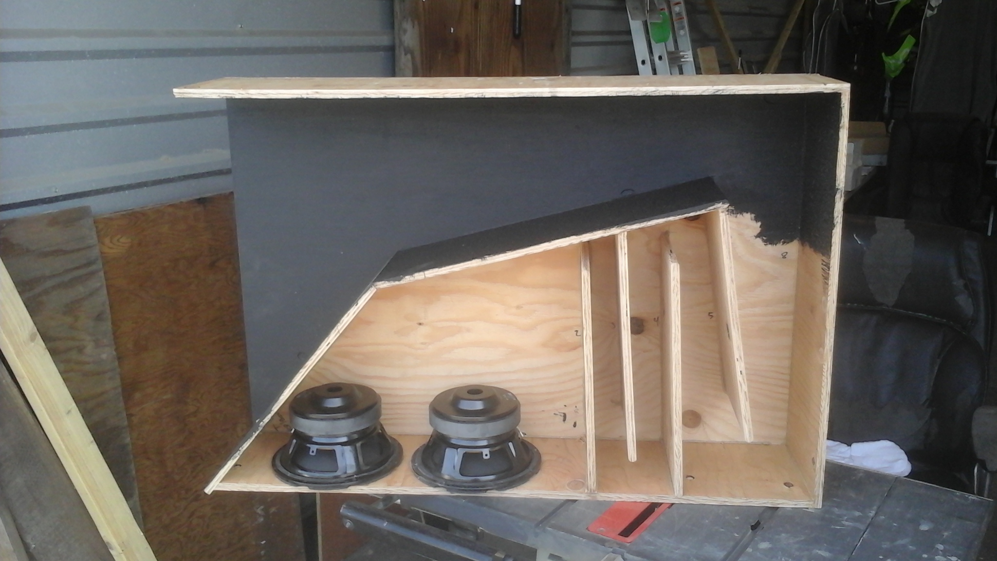

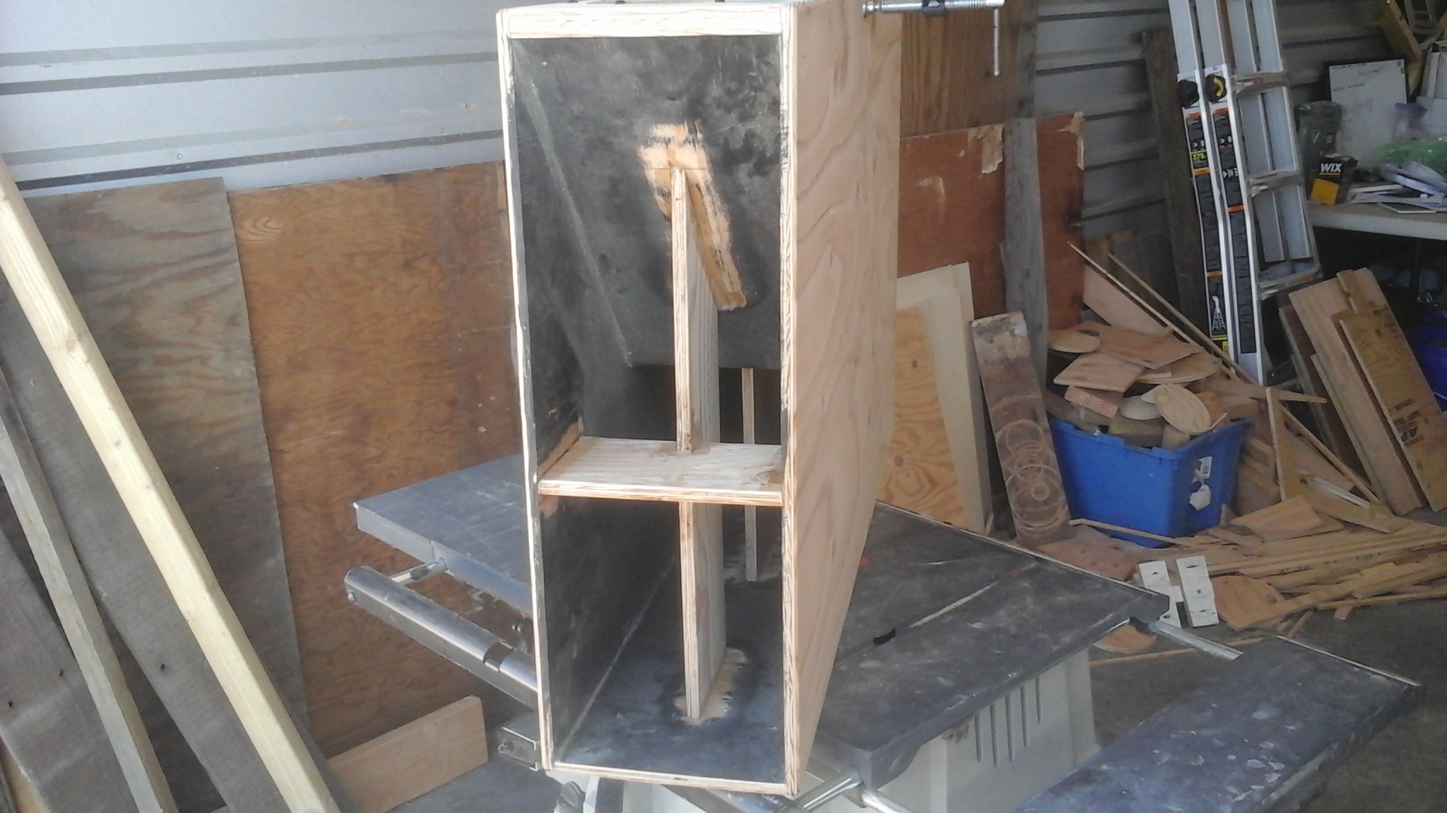

7/9 brace and mouth brace are in. I decided to have them intersect. I went back and forth in my mind about whether or not to put a fancy arc in the mouth brace, or a handle, or just keep it simple and not do any of that stuff... I took the simple route.
Tough to get a photo, and really it's not that interesting of a feature, but here it is anyway... Panel one's added support gusset/brace. Not the one alone on the left. The one to the right of that, between the drivers. .
Screw anchors are in. I'll have to trim them with a jig saw once the PL dries.
