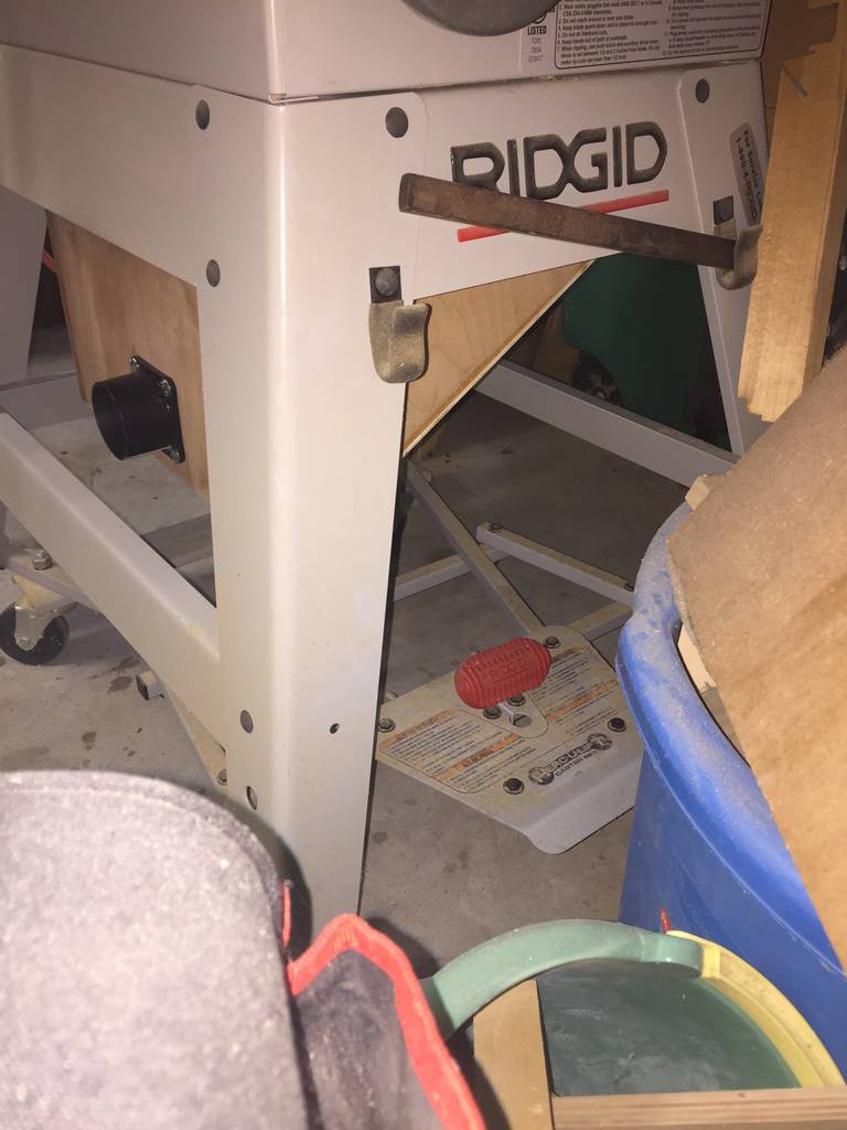

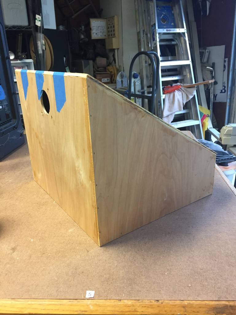

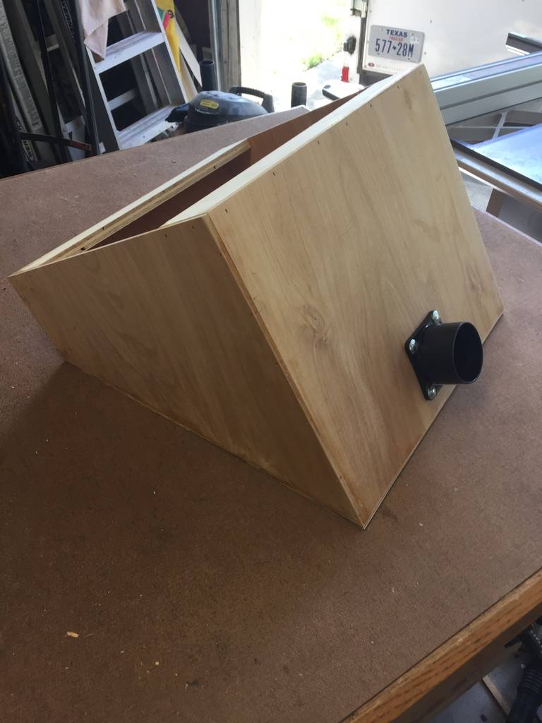

Ok, let's chat about this.....
For years I've thought about trying to do a better job of sawdust control on my table saw....always getting sawdust all over everything.
I've have a cardboard tray resting on the leg support braces for 20 years...at least. Well, today I threw it away.
Grabbed a bunch of scraps from the woodpile and made a quick trip to HD for a vacuum hose fitting.
Did a little quick measuring and drawing and came up with a design to hang under the saw and catch the sawdust and hopefully get enough suction from the shop vac to keep more of it coming that way.
Built a box out of 1/4" scrap with a a rail on each side for connecting to the saw case. Was going to just build it square, but then decided a little help from gravity would be a good idea...why not make it just a little more complicated. Hell, I don't have anything better to do while we wait out this virus thing.
Got to use some 5/8" brads for the first time in .....uh.....years? Maybe forever? But, I had some - perfect for 1/4" ply.
Cut a hole on the low side of the box for the hose connection.
Let the glue dry overnight, then attached the outlet connector and gave it a quick sanding....
Forgot to take a pic before I put the saw back in it's home among the wood pile......
Had to take off the backside leg brace to fit it in. There were already some holes in the metal case of the saw, so just pre-drilled some screw holes and installed it with some wood screws.
Hopefully there will be a little less clean up now after turning big pieces of wood into smaller ones.
