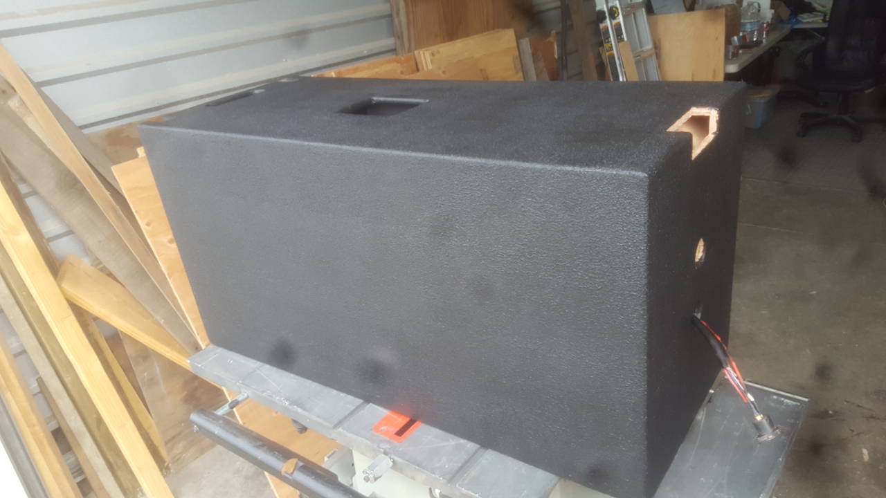

So, I don't know if you guys can see it well enough in the photo. But, there are lines down the side in the DuraTex, left by the roller. And other areas that are a little patchy with less texture on the back. I'd like to do something so that there are no lines or patches showing. Any thoughts on how to do that? Do I need to put on another thick heavy coat, or a light coat, or thin it out, or ??? What's the trick?
Posts: 8596
Re: What's to chat about?
#494 Post by Bruce Weldy »
It's just a matter of touch.....once the duratex is spread, keep going over it both directions and at an angle, then finish with very, very light passes in a straight line overlapping...
Posts: 3066
#495 Post by Seth »
Bruce Weldy wrote: Sun Mar 29, 2020 10:36 pm It's just a matter of touch.....once the duratex is spread, keep going over it both directions and at an angle, then finish with very, very light passes in a straight line overlapping...
So, do you think I should sand the existing texture down first or just go right over the top of what's already there?
