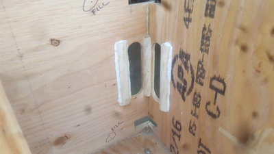

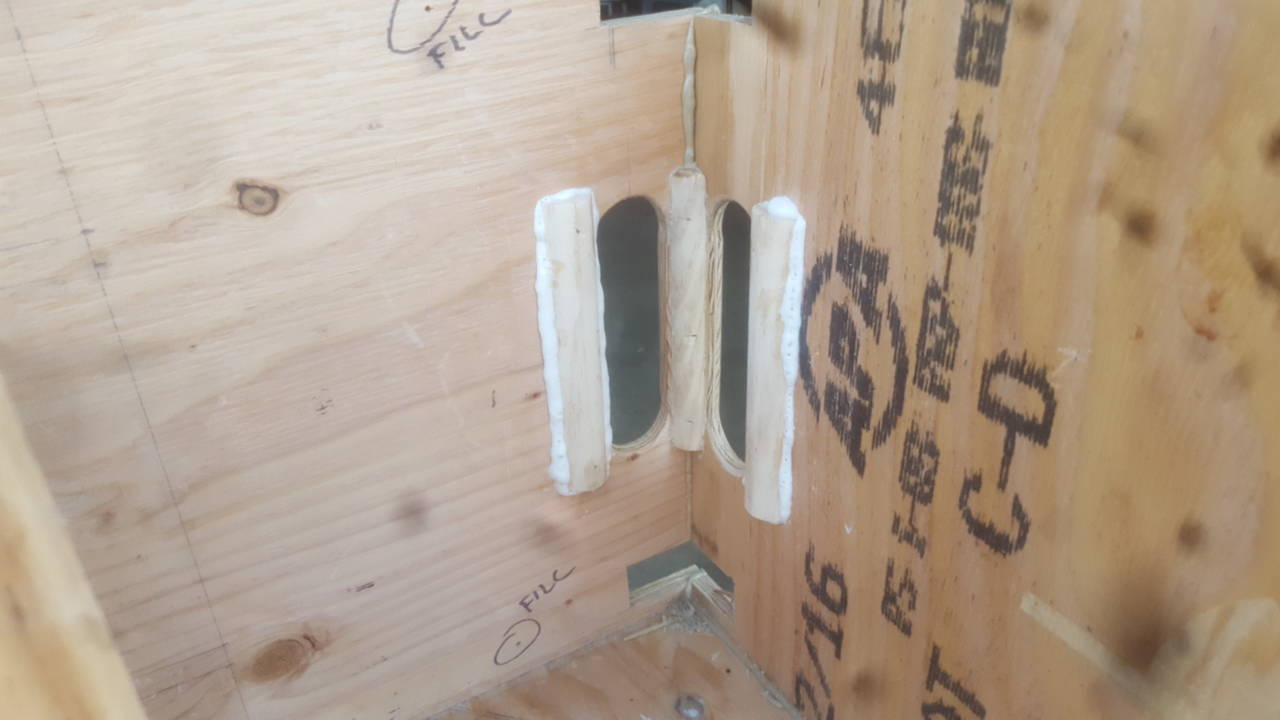

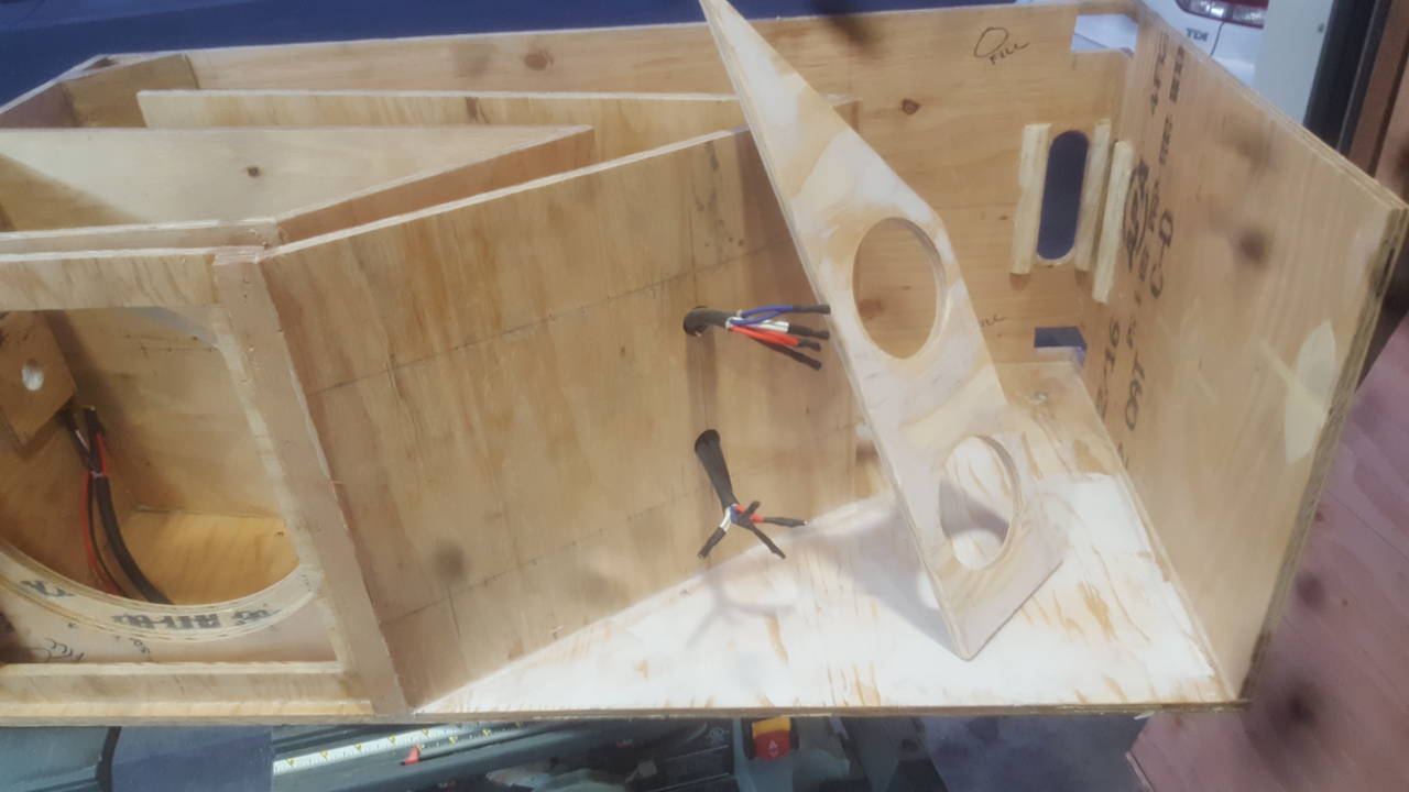

Panel 10 installed. I also put quarter round between the hand hold holes and bonded 2 pieces to make half round which I glued to the opposite side of the hand hold for a comfortable handling experience. I cut the 6/10 mouth brace and decided to skin it with bondo now while it's easy to get at. Also, laid some bondo down in other various places. Additionally, I filled in voids in the ply with PL.
Getting colse!

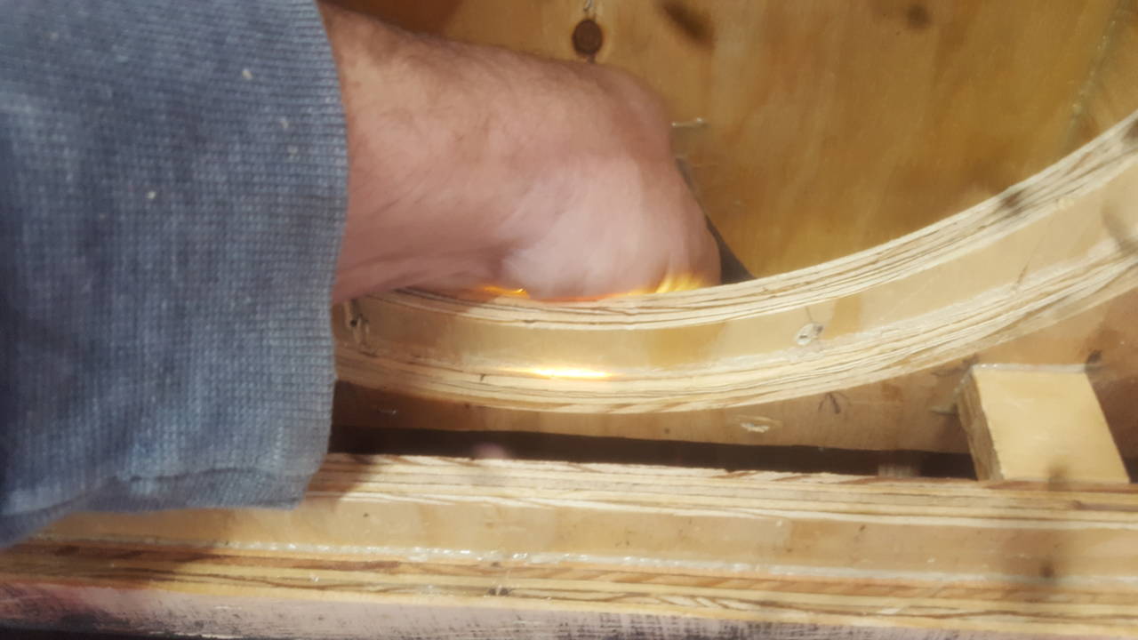

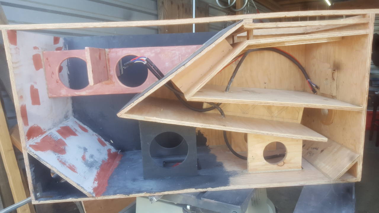

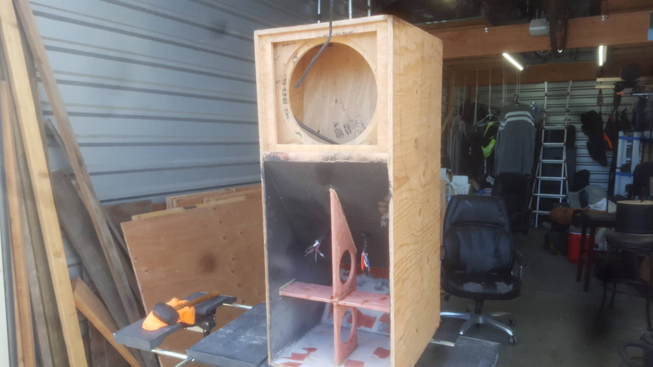

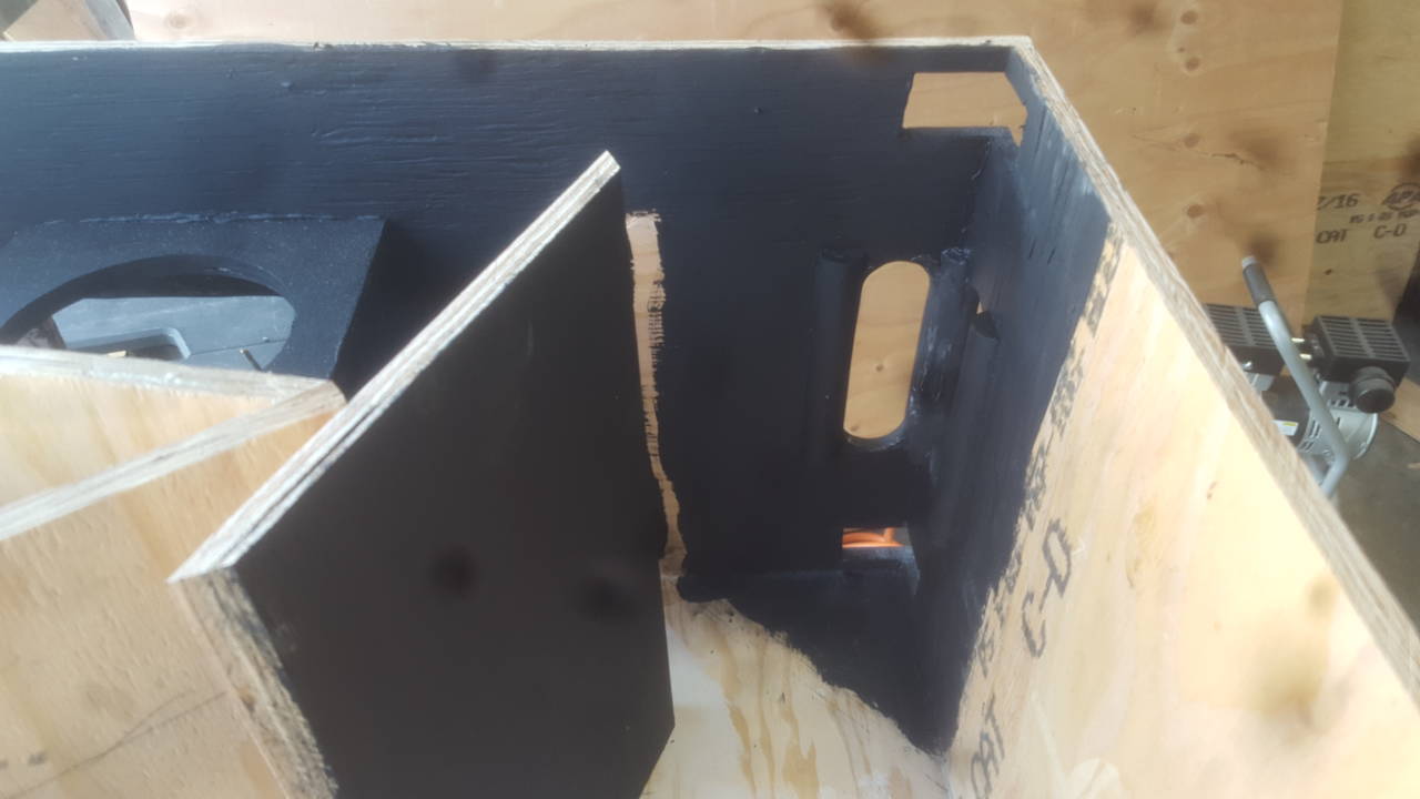

I thought I'd have the mouth brace installed today and maybe even the side attached. But, I chose to do some bondo work, filling knots and deep grain in the mouth area while I have easy access to sand and paint the area.
I put bondo around the quarter round in the hand hold and got a real nice comfortable in the hand blending-in. Painted that area and also the back side of panel 11 before installing panel 11.
I had never used the bondo spot putty in the tube before. I know someone here mentioned it's what they like to use. I found that it shrinks a little and didn't fill the deeper wood grain grooves in my crappy wood adequately. But using it as a final skinning after a coat & sanding (or two) of standard bondo gave a good result filling the little blemishes without overly building up too thickly anywhere.
I haven't ever used DuraTex. I don't know how much it will or won't hide. I do know I've seen pictures here where I can see the grain. I'd really like to not have any visible grain, except for maybe the back of the mouth I wont worry about too much. You can see the deep grain I'm talking about in the pic above. So anyway, trying my best to get everything skinned and as smooth as possible.
Oh! I also took a little time and put a nice rounded edge on the lower peak of panels 5 and 6. I figured curious people may reach into there for whatever reason and I'd rather they feel nothing instead of squeeze-out and sharp corners... and brads popping out. I snipped the brads that wouldn't pull through and ground the nubs down yesterday. It's nice now. Nice smooth corner and nothing to feel except the angle of panel 5.

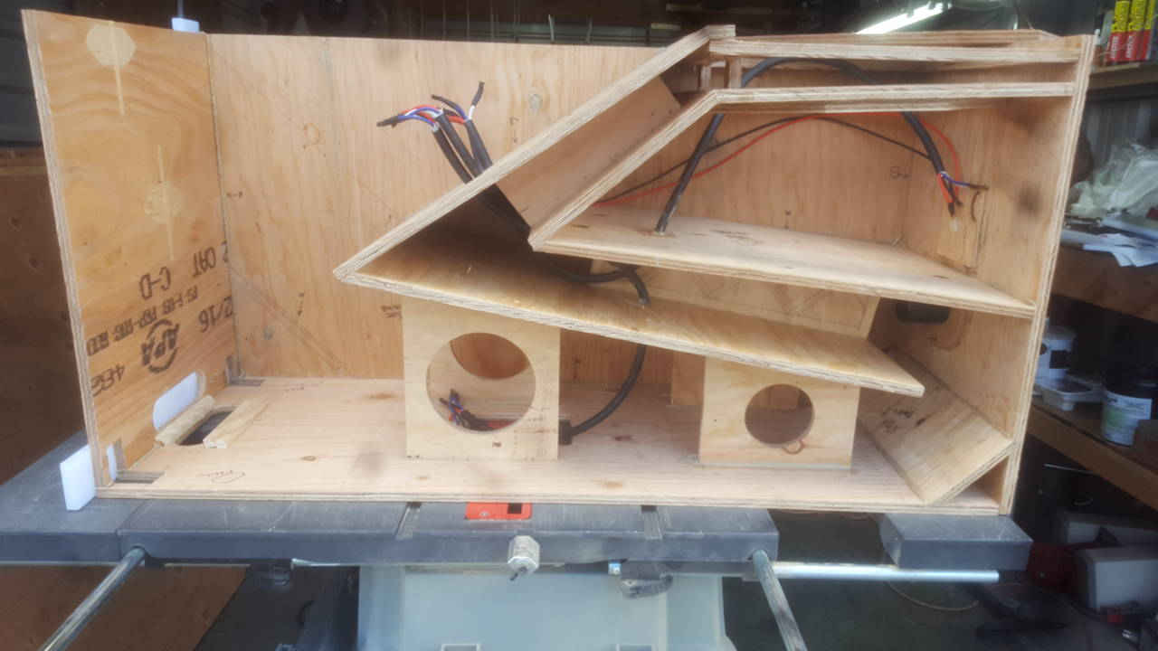

Got the mouth braces all sanded and installed.
Was gonna call it a day, but thought, welllll shoot... I'm nearly there, let's get the side put on.
Got that all put together. Pretty fulfilling. But you know what would be REALLY fulfilling? Hear some noise out of it. So I slapped in all the connectors, top hat, and a 3012LF. Ran a 30 Hz sine and I have at least one good size leak around the speaker. Decided to tackle that tomorrow.

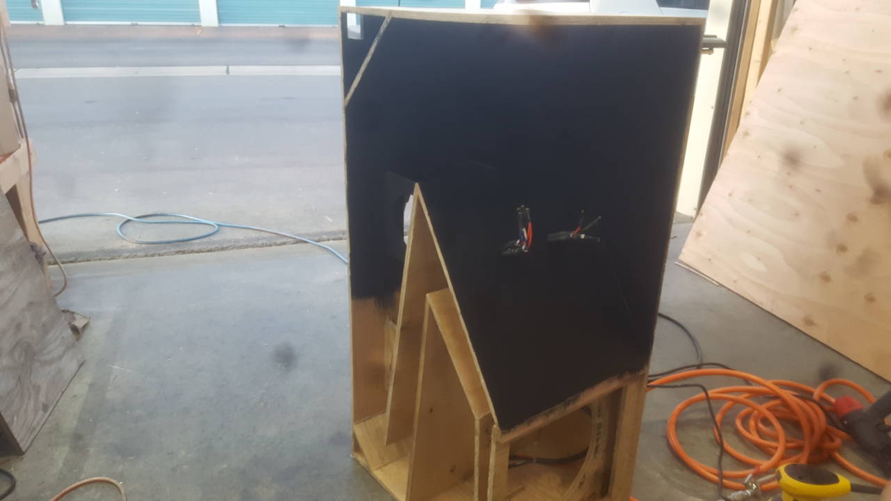

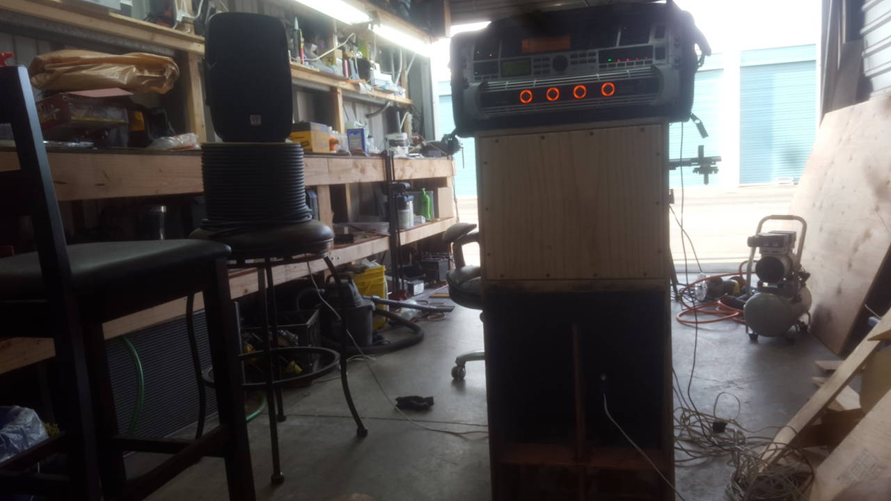

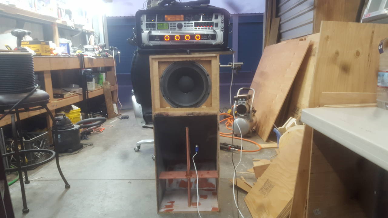

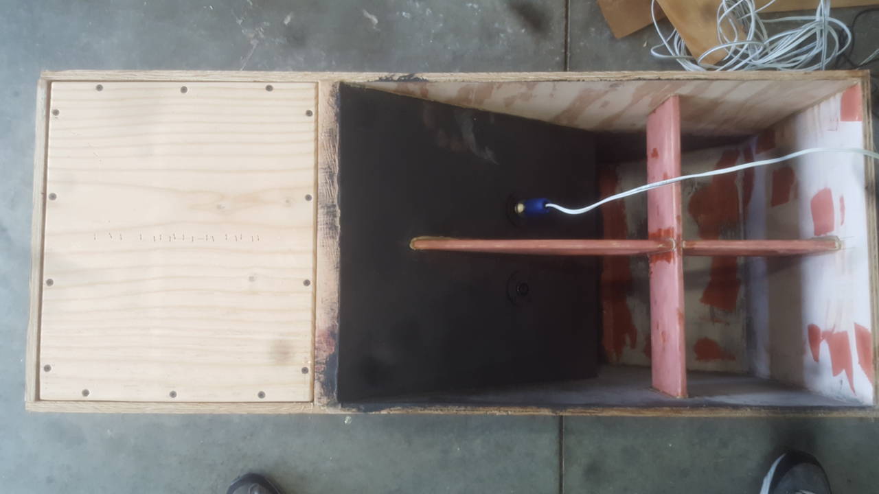

So, anyways... took yesterday off. Had some things to do mid day that just dominated the day. Today I put new gasket tape on the driver but that didn't fix the issue. Still blowing wind at the same spot it was before. Took the driver out and took a closer look with a flashlight. Ah hah! I remember worrying about the minimal overlap in that area.
I put some CA glue in the crevice from the front and put some PL in from behind. Voilà. No more leaks.
Took a little time going over some options for access cover screw placement and did my best to put them in as straight of a line as possible. I'm pretty happy with the result.
Spent the next couple hours giving it a listen. First I ran it with the DEQ/DCX/NU 4-6000 set-up. Then I became curious how different it would sound running on the Ashly ne800pe, limited to 35 volts to simulate what it would be like if I put a Basslite S2012 in it. I'll tell ya... I'm impressed.
Just need to finish sanding and painting and it should be done.
