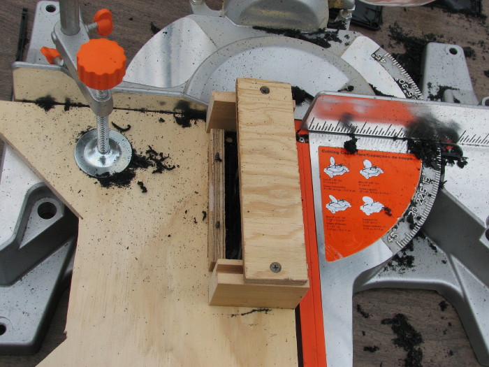

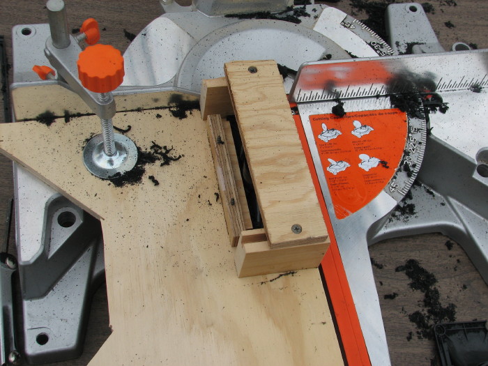

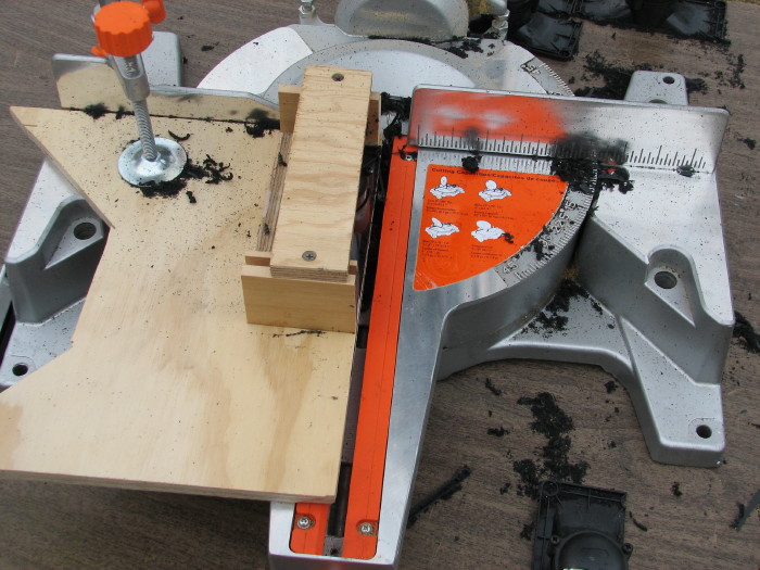

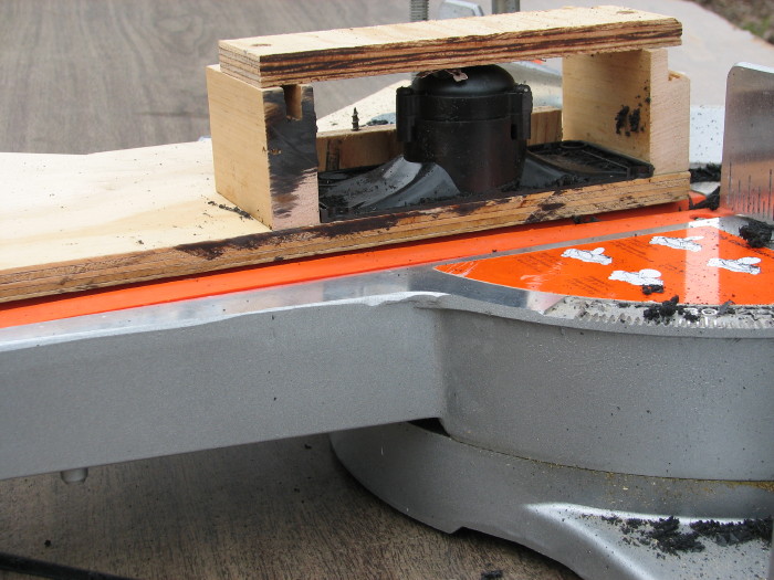

I've made a jig for myself for use on a mitre saw. I took out the toothed blade and installed an abrasive blade. The jig is placed against the back fence, and then moved over to the right to meet the blade when it's dropped. I ended up with a near-perfect 2" wide tweeter! A spacer is installed when cutting the second side (can be seen in the second vs the third photo) Oh, and all made from scrap.
