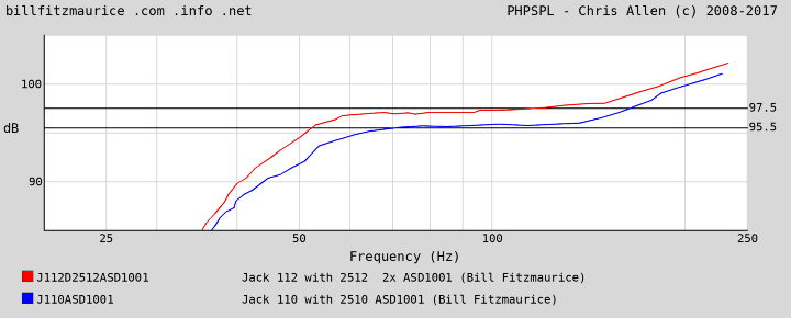

Jack 10 vs 12 with ASD1001
Code: Select all
[spl]J112D2512ASD1001,J110ASD1001&dbmin=80[/spl]
Low end comparison
