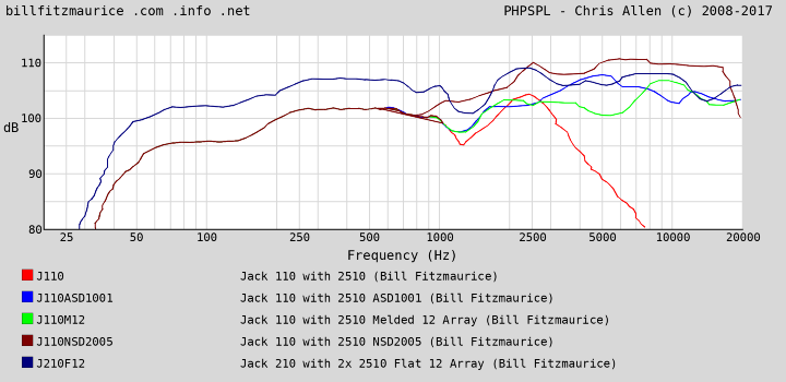

Re: Introducing SPL Chart
#55 Post by Chris_Allen »
Code: Select all
[spl]J110,J110ASD1001,J110M12,J110NSD2005,J210F12&dbmin=80&dbmax=115[/spl]

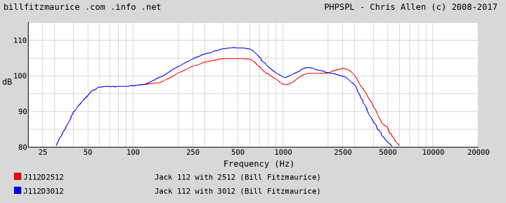

#56 Post by Chris_Allen »
Code: Select all
[spl]J112D2512,J112D3012&dbmin=80&dbmax=115[/spl]

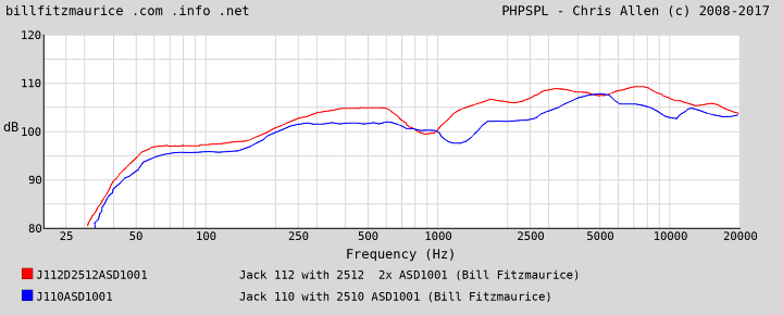

#57 Post by Chris_Allen »
Code: Select all
[spl]J112D2512M16,J112D2512ASD1001&dbmin=80&dbmax=115[/spl]

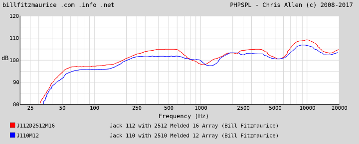

#58 Post by Chris_Allen »
Jack 10 vs 12 with melded array
Code: Select all
[spl]J112D2512M16,J110M12&dbmin=80[/spl]
Jack 10 vs 12 with ASD1001
Code: Select all
[spl]J112D2512ASD1001,J110ASD1001&dbmin=80[/spl]

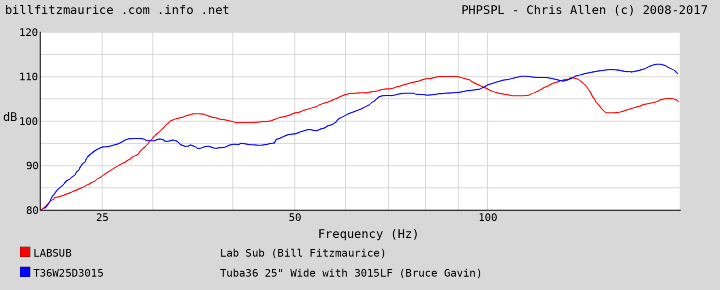

#59 Post by Chris_Allen »
The Lab Sub and a 25" wide T36
Code: Select all
[spl]LABSUB,T36W25D3015&dbmin=80&fmax=200[/spl]
