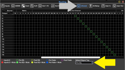

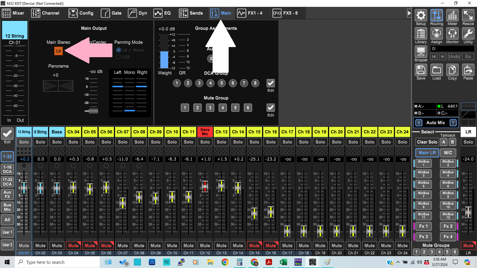

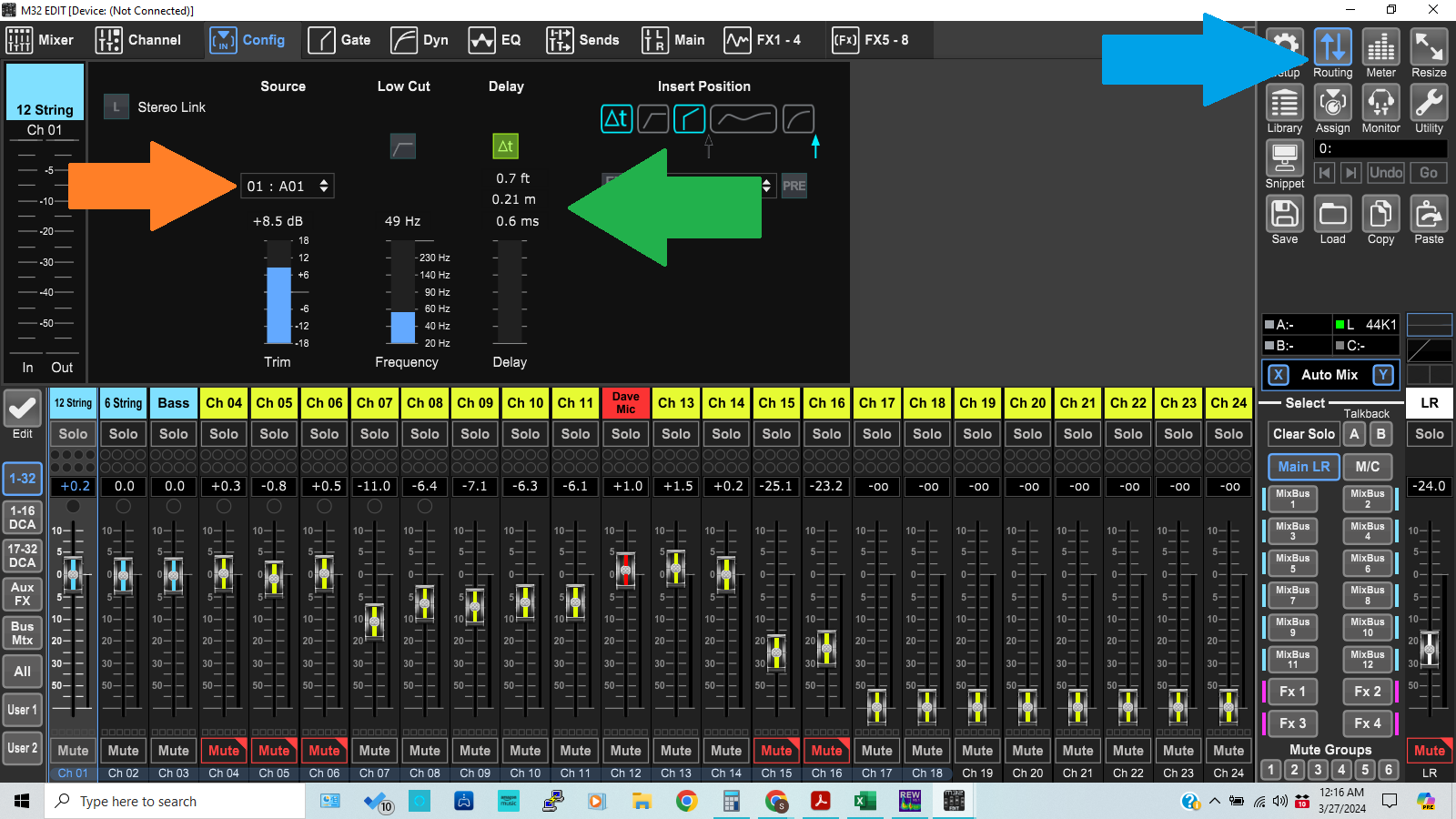

Do I understand correctly, that you had crossover filters engaged in both the M32 and Driverack simultaneously?
Do you have access to any of the measurement data? A screenshot or saved jpg RTA/response graphs, or anything like that, which would show the systems final tuned response?
Some people tune the system flat, +/-3dB on RTA and EQ the source channel to taste. And others tune the system with the lows bumped up and the highs slightly attenuated, which requires little to no source channel EQ for playback of commercial recordings. If you don't have the REW graphs, can you tell me a little about the target response the system was tuned to?
Do you happen to have the M32 configuration file saved to your PC? If so, you can email the file to me and I'd be happy to look everything over.

I would do all of the systems primary crossover, EQ, and limiting in the Driverack and not do any of it in the M32 except for small incidental tweaks here and there, little things. I'm not sure if you have already or not, but if you connect the ethernet port on the back of the PA2 to a router you can operate it from a PC or tablet, the GUI is far more intuitive, way easier, and quicker than fumbling through the menus and functions from the front of the unit.
Not only is it the primary function of the Driverack to handle these tasks, if your M32 takes a dump, you can just plug your DJ controller (or playlist on your phone for that matter) directly into the Driverack and you'll be all set to go on a tuned system. You guys are brave. I wouldn't even think to bring an expensive mixer with motorized slides out into those conditions unless it was 100% enclosed and vented with filtered air. Although, if you guys are using the M32C, thumbs up, good choice.

No, they were not engaged simultaneously. The Midas was primary (M32LiveR), and the Driverack was backup. Both had the same settings, though.
