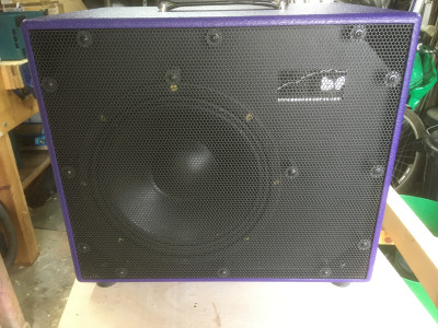

Cabinet completed.
Replaced the pieces of bicycle inner tube with tap (faucet) washers.
Now awaiting a cover, on order from Hot Covers, U.K.

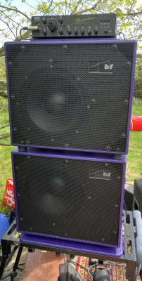

Latest picture at an outdoor event.
Video link at bottom of this post.
Amp settings show it easily coped with band in the open.
Sound was warm, full and clear.
Audio/video clip on YouTube. - Amp only through cabs - no DI - only vox into PA.

Re: Simplexx 1x12 Build - Woofer only
Posted: Tue May 06, 2025 9:39 pm
by Tom Smit
That's a good-lookin' stack!
Thanks for the gig report, as well!
Posted: Wed May 07, 2025 1:22 am
by Strange Kevin
Loving the purple and well everything about this!
Nice that you have them up on a stand at ear level too!
Can I ask for another photo of the top? Looks like amp is sitting on another board to clear the top handle maybe? I'm curious about what's going on there! :)
Thanks for sharing these great looking cabs with us.

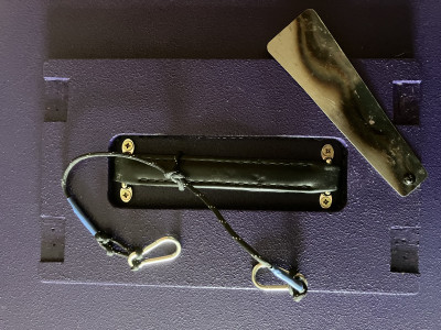

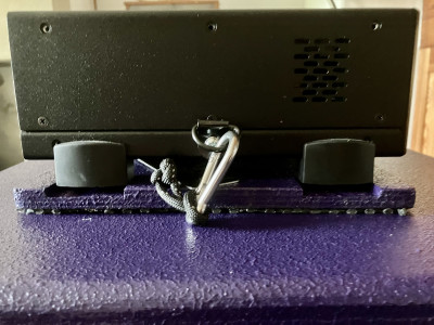

Photos? Certainly.
Here you go... plus a YouTube video clip
https://youtu.be/bpODU2ub1e0
The purple paint is Tuff Cab from UK supplier Blue Aran - applied by roller, dries to last wet texture in about 30 minutes at 20º Celsius
The stand is a keyboard stand with a plywood board attached by simple swivel cleats.

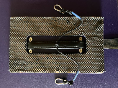

The amp sits on a board, which has rebates for the amp's feet and a hole to:
a) clear the handle
b) prevent the head sliding sideways if tugged by a lead (which is tucked under the head anyway).

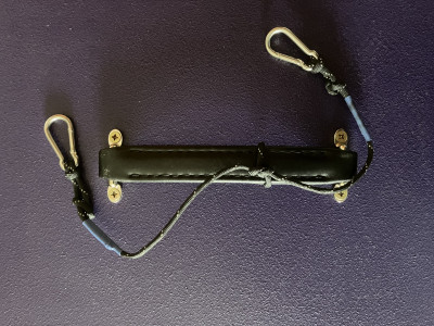

Subsequently attached D-rings to the head (using bolts designed to attach rack-ears to the head) and a paracord tether with clips to the top cab handle.
The tether also helps identify the top cab before putting it onto the stand.
The amp board has rubber anti-slip kitchen drawer lining glued to the underside.

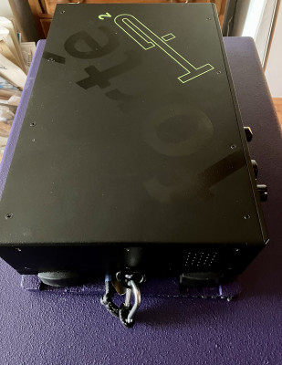

Attached a piece of an old saw blade that swivels out to allow me to attach a magnetic-based LED lamp for dark venues as I discovered the amp case is non-magnetic alloy.
(BTW I noticed in the photos that the amp isn't seated properly in the rebates - it's much more snug when in use.)
Now, at least, the lead won't ever pull the head off the top and if someone toppled the entire stack I'd hope the amp would hit the ground after the top cab.
(A tilt test got to about 20º off vertical before it looked like falling)
Tether and clips attached to top cab handle
Amp board in place showing saw blade lamp platform
Amp head with tether clipped onto D-ring (top view)
Amp head with tether clipped onto D-ring (side view)
Underside of amp boad showing rubber anti-slip material
