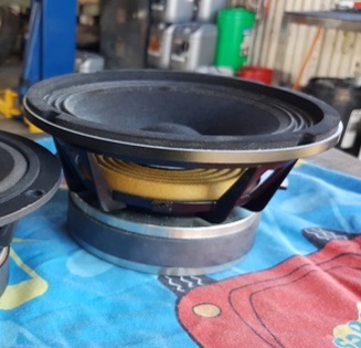

Are those Alpha 8 drivers?
Re: DR build questions
Posted: Sun Dec 10, 2023 11:54 pm
by Keryn O'Shea
Seth wrote: Sun Dec 10, 2023 5:15 pm Are those Alpha 8 drivers?
They are an "Fs" brand, rated at 180w. VFM Audio here used to import their range and they were great, though VFM dropped the speaker side of their operation. I tried to dig up specs.. no luck. I've never thought l needed more midrange with these, one thought was to add 4x compression drivers.. they'd be bolted to the side as there's no room in the cab.

They are 8 inch drivers, correct? Not 6 inch drivers
Posted: Mon Dec 11, 2023 2:46 pm
by Keryn O'Shea
Yes, 8 inch drivers
