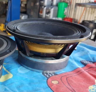

Seth wrote: Sun Dec 10, 2023 5:15 pm Are those Alpha 8 drivers?
They are an "Fs" brand, rated at 180w. VFM Audio here used to import their range and they were great, though VFM dropped the speaker side of their operation. I tried to dig up specs.. no luck. I've never thought l needed more midrange with these, one thought was to add 4x compression drivers.. they'd be bolted to the side as there's no room in the cab.

They are 8 inch drivers, correct? Not 6 inch drivers
Keryn O'Shea
Posts: 634
Location: Brisbane, Australia
Re: DR build questions
#50 Post by Keryn O'Shea »
Yes, 8 inch drivers

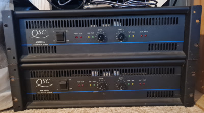

I use 2x QSC MX3000a for anything l use outdoors,
they're beasts, and quite heavy! I hardly lean on them for the tops, whenever l get the shits moving them around and look to replace them, l see the price of lighter quality amps with the same output.. then just close the laptop and walk away!

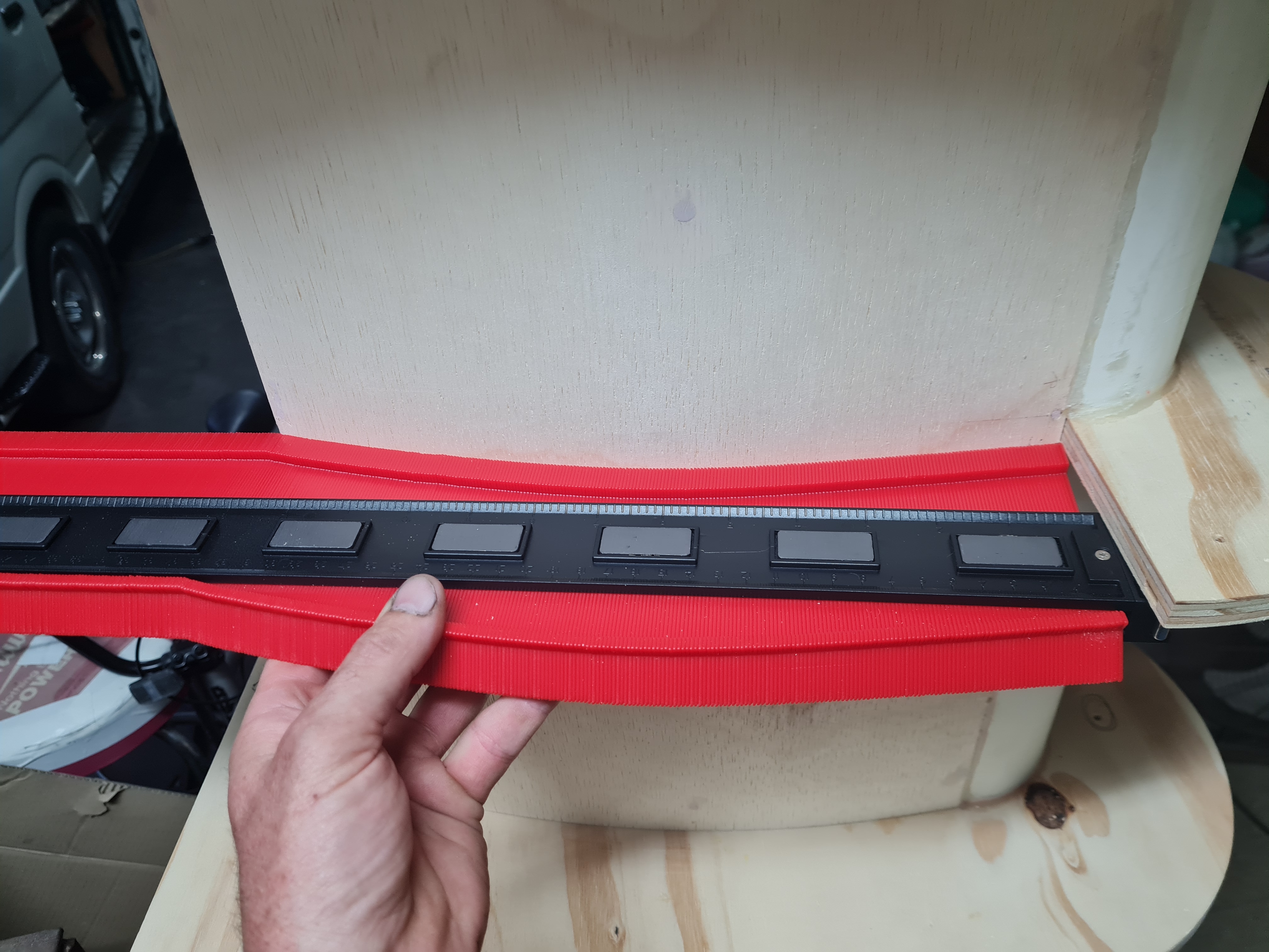

Hey this contour gauge allowed me to make just one cut with the side braces, the pencil method wasn't working for me as the bendy ply l had to use on cab one wasn't the greatest & it's come in handy with a few other cuts too.

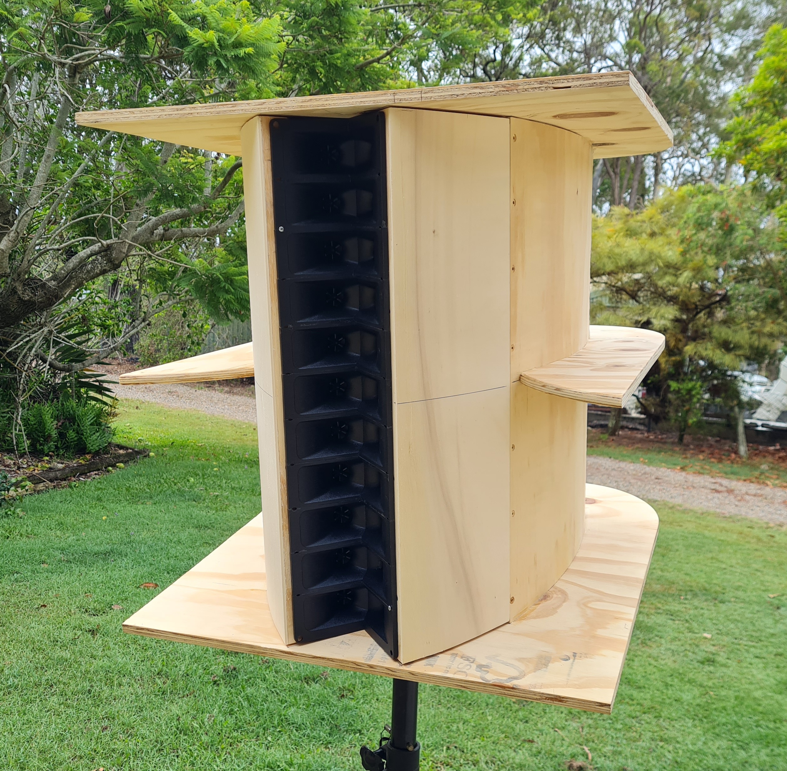

That's me out of build time for this year..
All the best to you good people, have a safe holiday pondering your builds for next year, cheers 🍻
The J10Lite would be a sweet cab to build after these..
