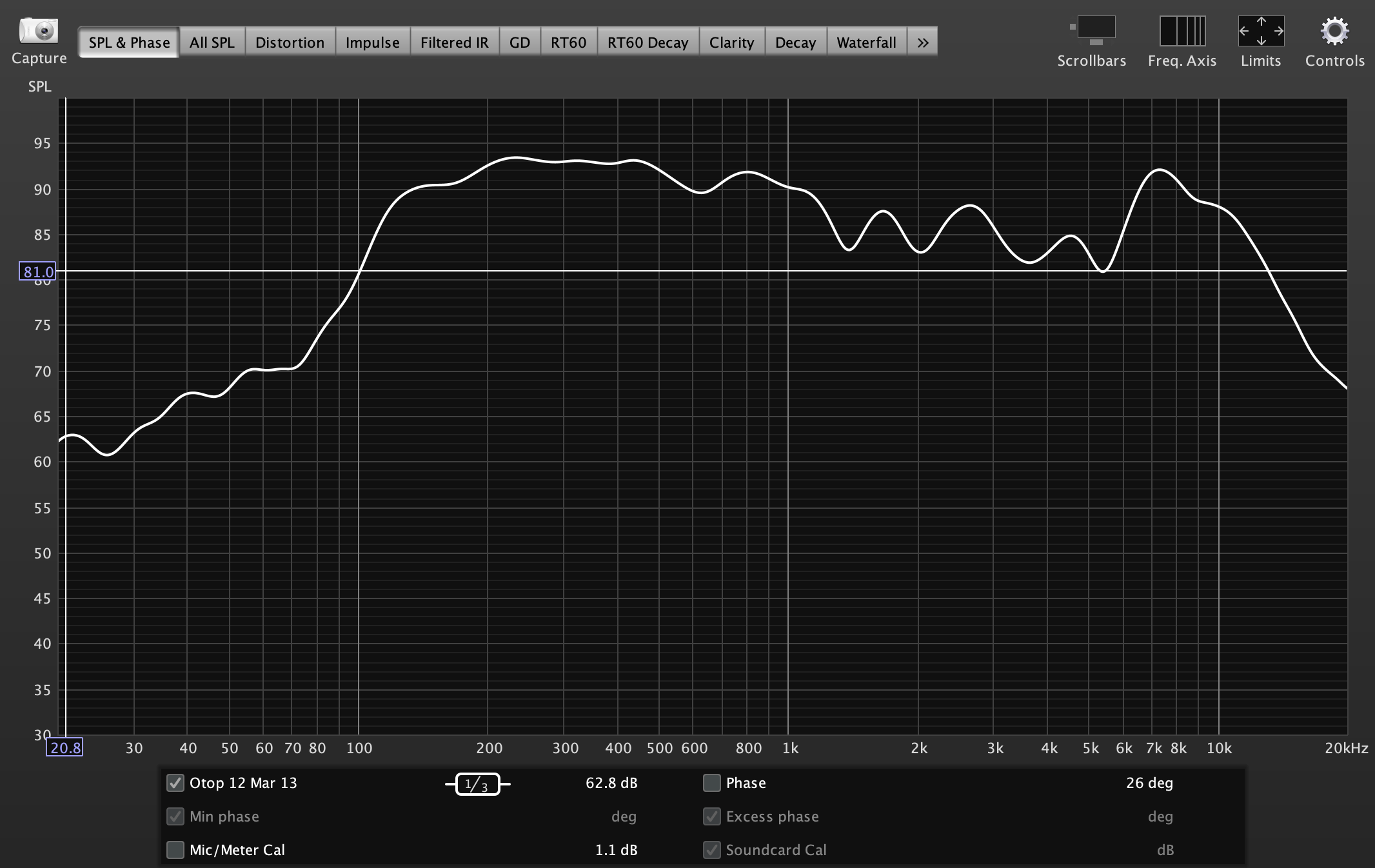

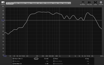

I couldn't find how to change the background but I switched the trace to white and it shows up a little better. I'm looking forward to building the second one....there are some things I hope to do a lot better on #2!
- Posts: 29119
Re: OmniTop 12 build
Those peaks and dips above 1kHz may indicate floor bounce and/or measuring with the mic too close to the cab.
The mic was pretty close so maybe that is it. I’ll give it another try someday….in the meantime it’s moved into the garage with the tweeter array for the second one helping out

- Posts: 29119
For a good result with a vertical driver array you want to measure from at least three times the array height, preferably more.
Ah ok I’m sure I wasn’t that far away. How about the distance away from buildings and walls….are there any guidelines about how far away from the house I should be?
- Posts: 29119
At least two wavelengths. That's 25 feet at 100Hz. The absolute best method is to take two measurements. The first is with the cab on the ground, the mic an inch or two above the ground. The second is with the cab on it's back, the mic suspended above it, the same distance away as with the ground plane measurement. With the second measurement you'll see a notch, where the reflected wave off the ground and the original wave meet 180 degrees apart. Just above that notch the two measurements will have the same SPL. Splice them together at that frequency. This gives a true half-space anechoic result, just like in a $100k anechoic chamber.
Awesome information, thanks

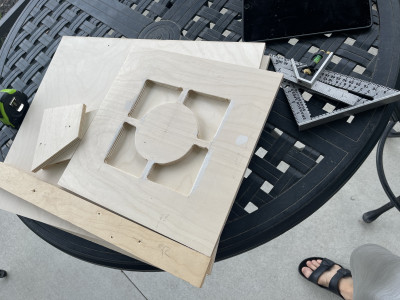

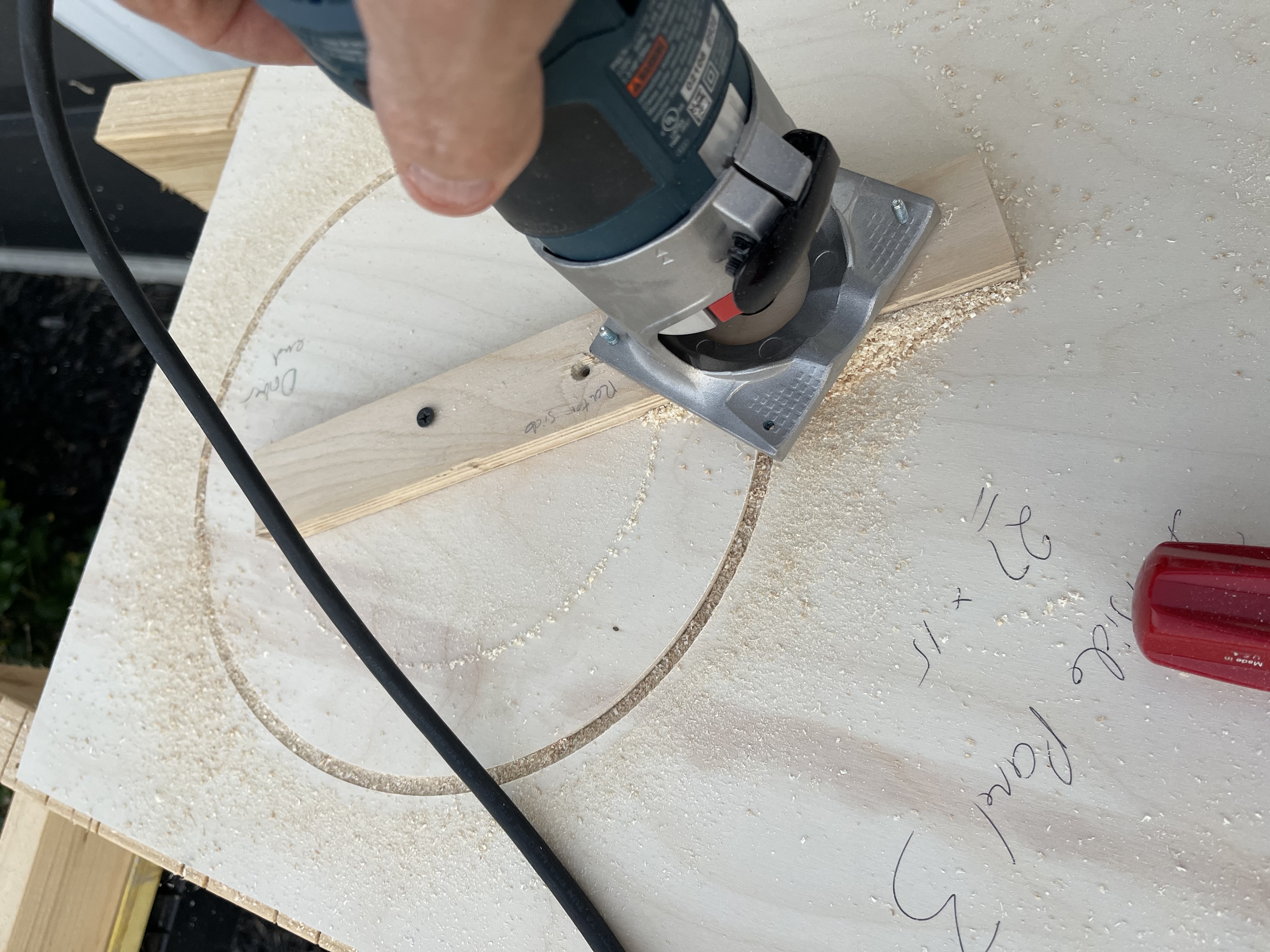

The second one is so much easier than the first one! Still struggled with the jig saw and baffle but it came out better. This time it’s really fun
That is an amazingly clean cut with a jigsaw.

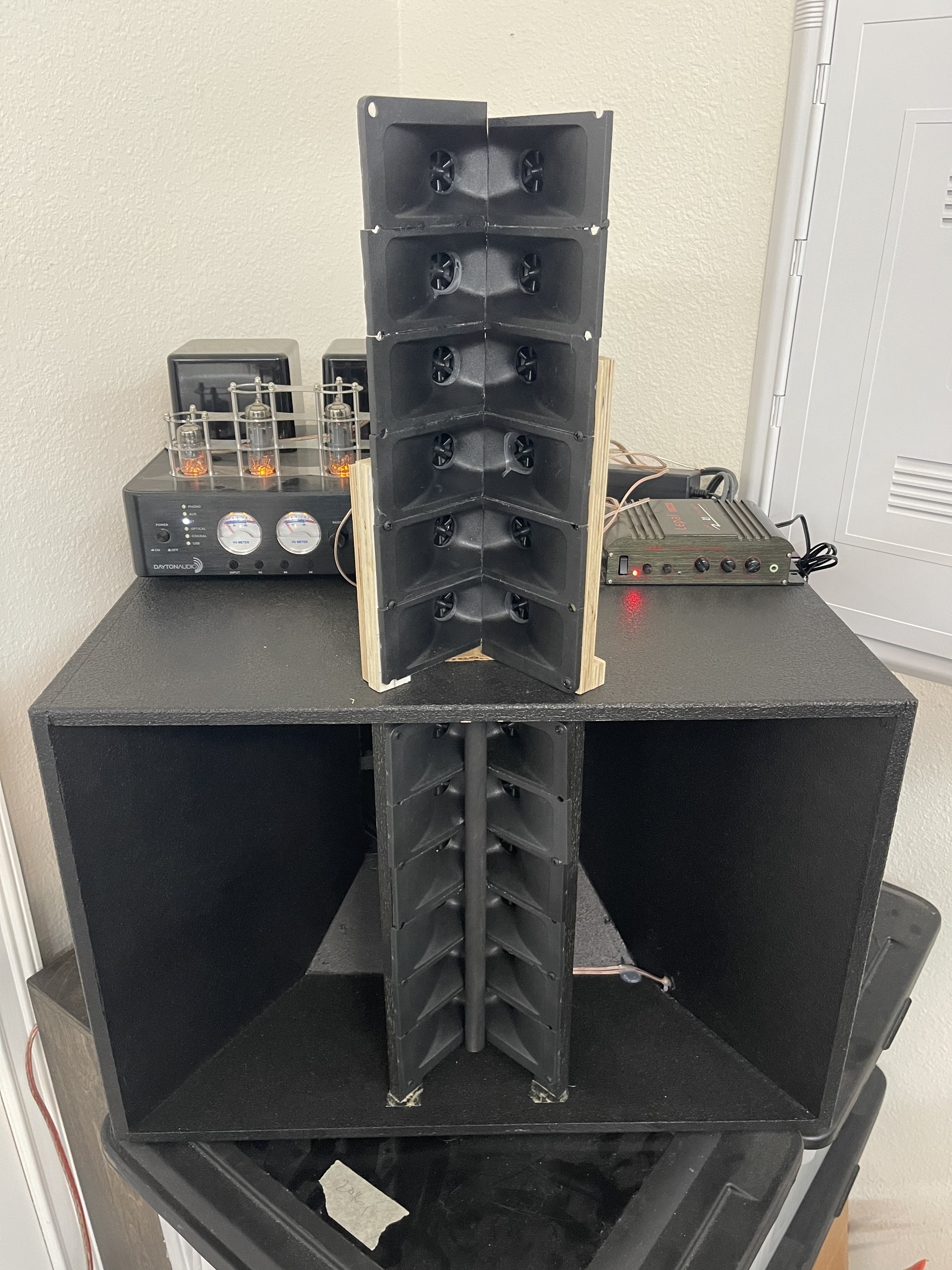

Fastskiguy
- Posts: 176
- Joined: Tue Dec 20, 2011 8:11 pm
Loving the sound and have the first t45 under construction:)

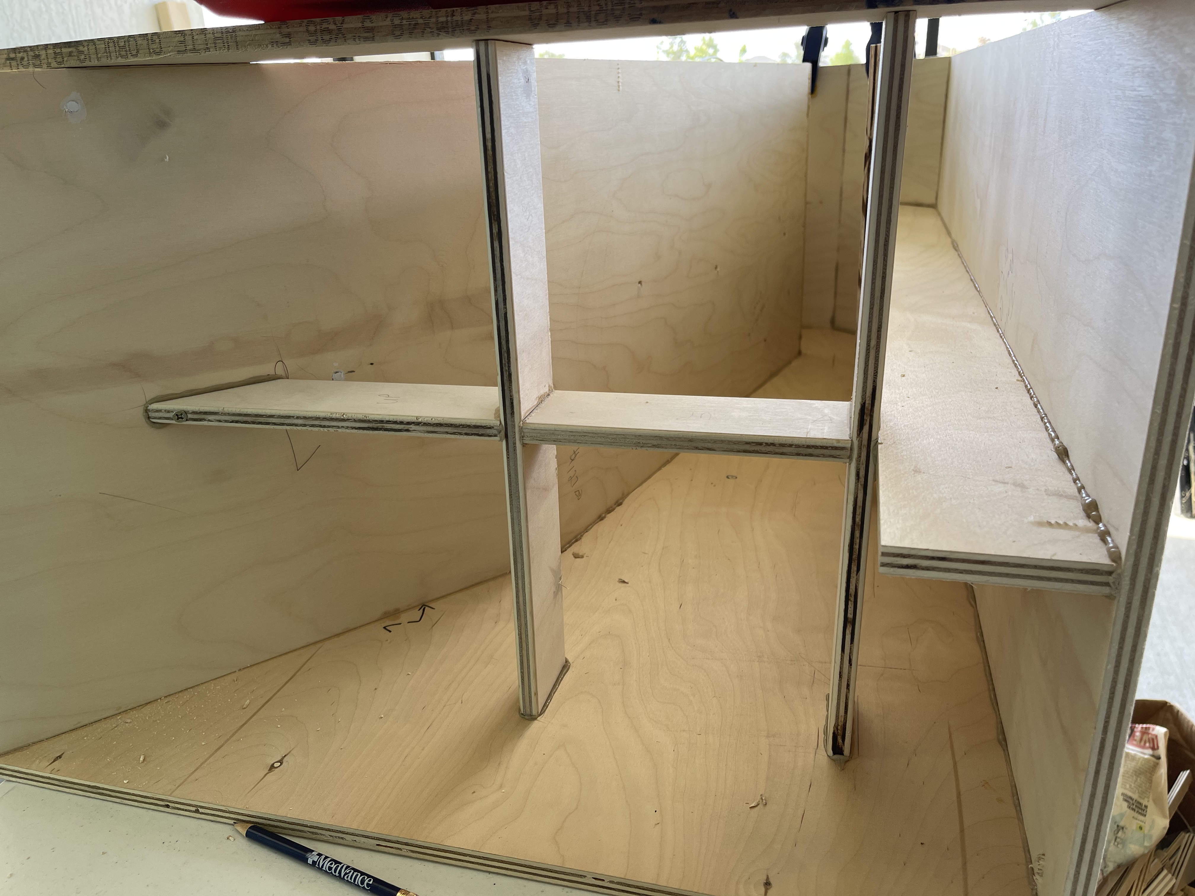

Progress report....so the first T45 is coming along just fine, although I went off plan on the bracing. But it's gonna be pumping out sound in a few days (hopefully!). The amp I planned to use for the T45s has a loud clicking sound and it might be in the process of dying so I need some suggestions on how to power this system. Based on the charts of the wall loaded T45....I pretty much need 3 good volts for my garage....maybe less!

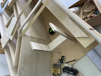

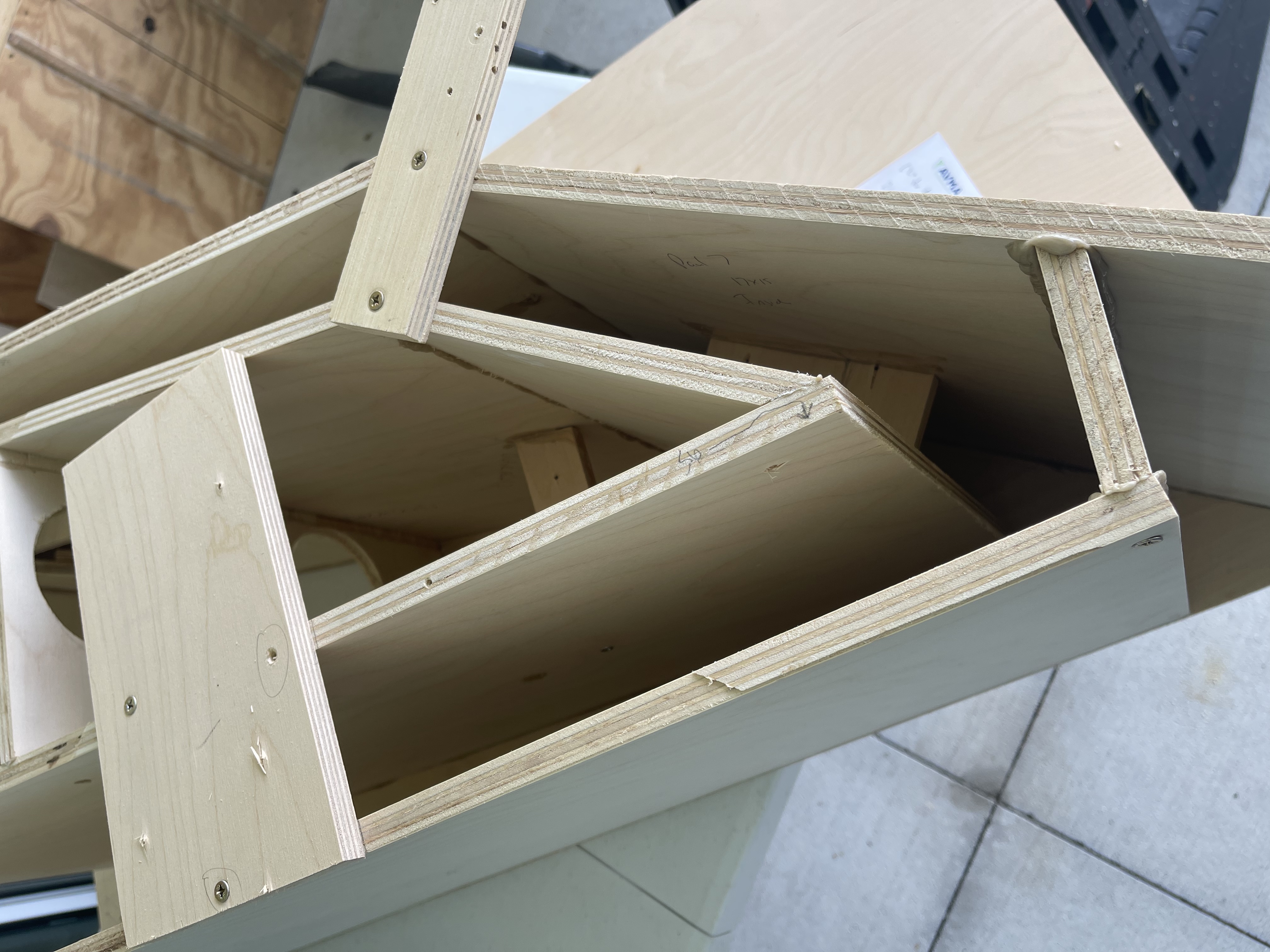

Fastskiguy
- Posts: 176
Here are some progress pics
Fastskiguy
- Posts: 176
One more…
