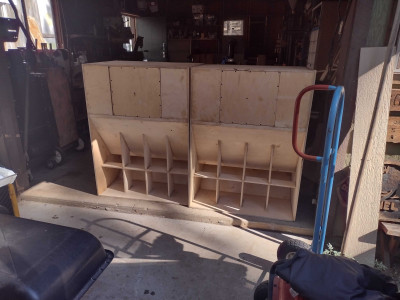

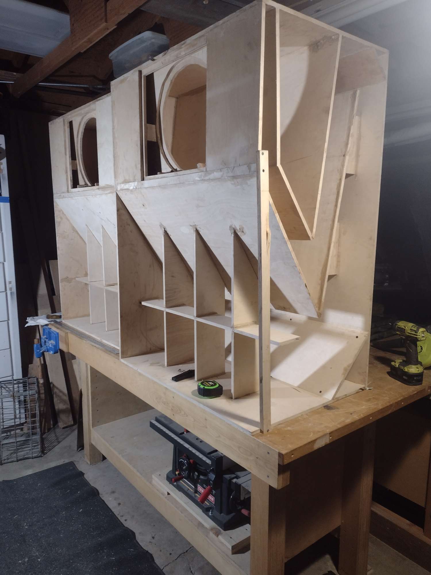

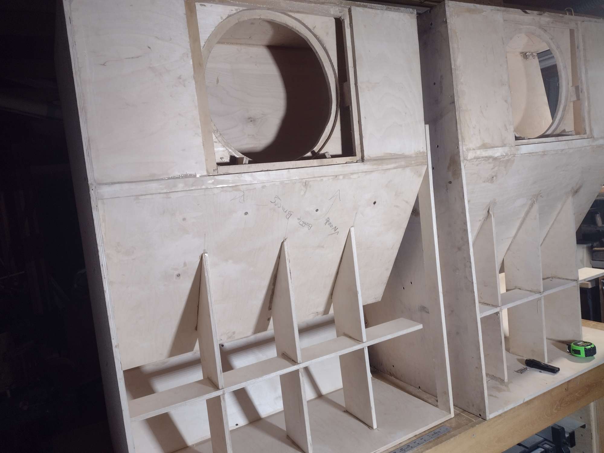

Im going with Seth's suggestions, looking at the boxes, it seems like the "right" number for each section.
I've gotten panels 5 & 6 on one box now, and all the wood to finish them, so hopefully next week I'll get those panels on the other one and get 7 & 8 done on both.

Love the update and photo. You're so close to hearing firsthand how premium subwoofers sound.
It's looking good, looks like you've put a lot of intention in making all the seams air tight
You're coming down the home stretch. Almost there. Keep up the good work!

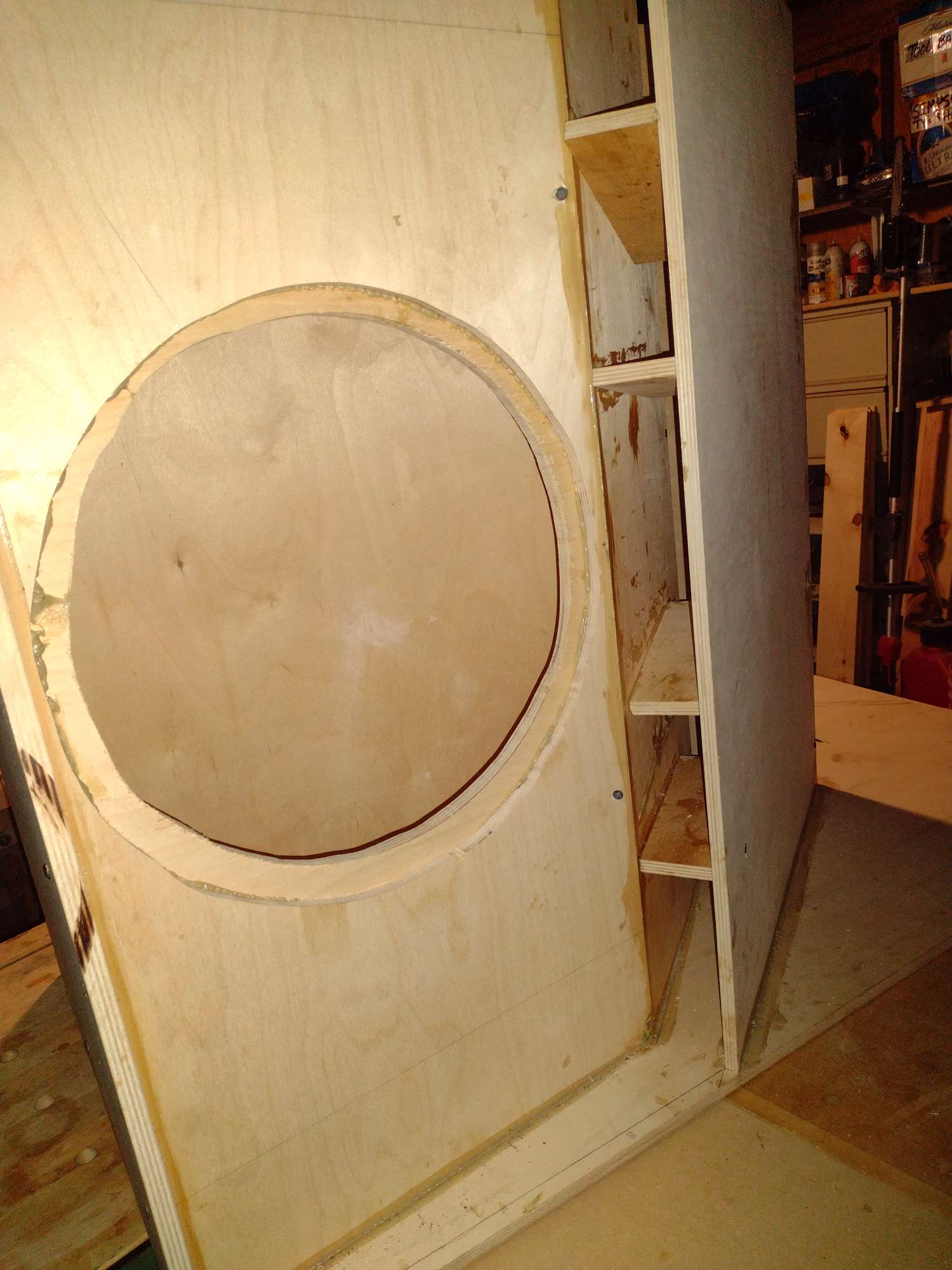

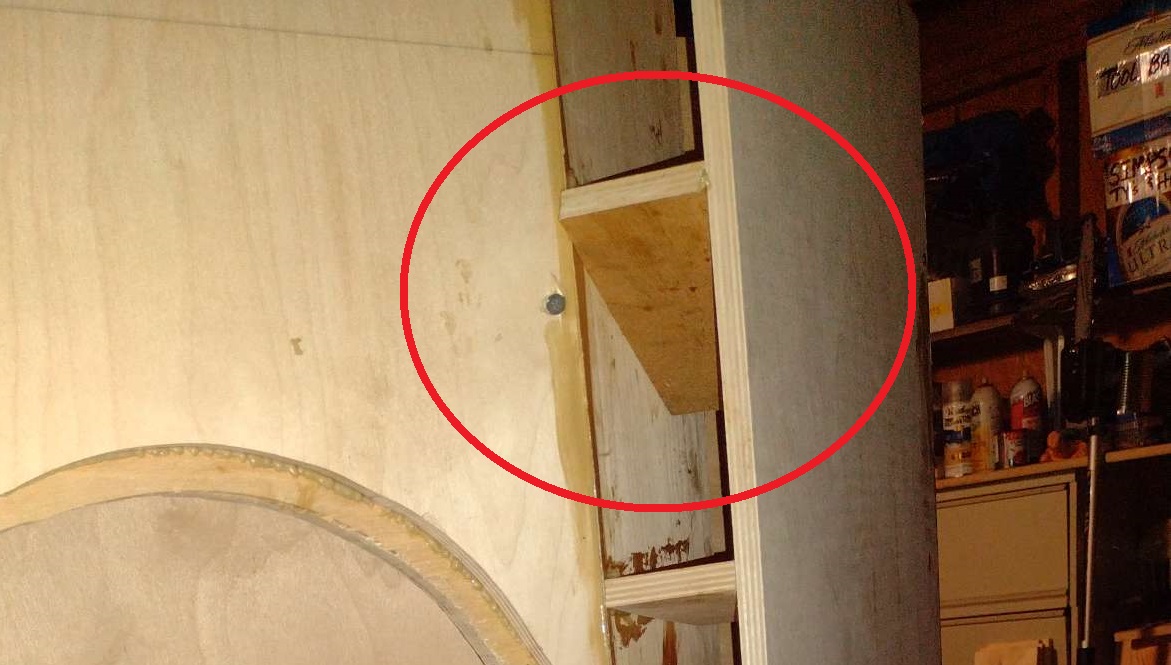

Is this one glued in? Definitely make sure.
Re: T48 stack
That one was still loose when the picture was taken, but it has been glued in. Thank you for the concern though.

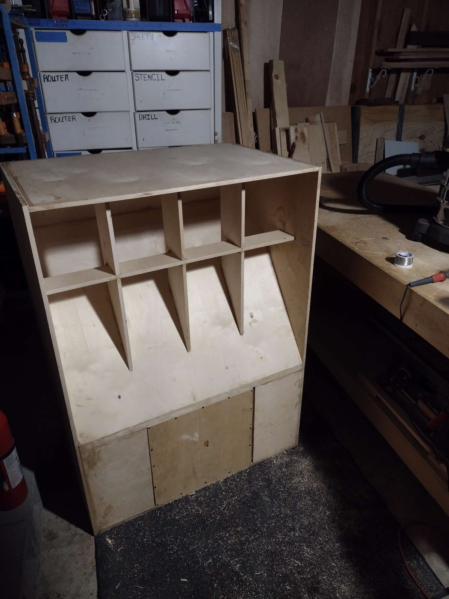

They are done!
At least the first pair. They still need to get painted, but they are built and wired. Now I need test them and get them dialed in.

Looking beautiful! Can't wait to see them finished, keep the pix coming!

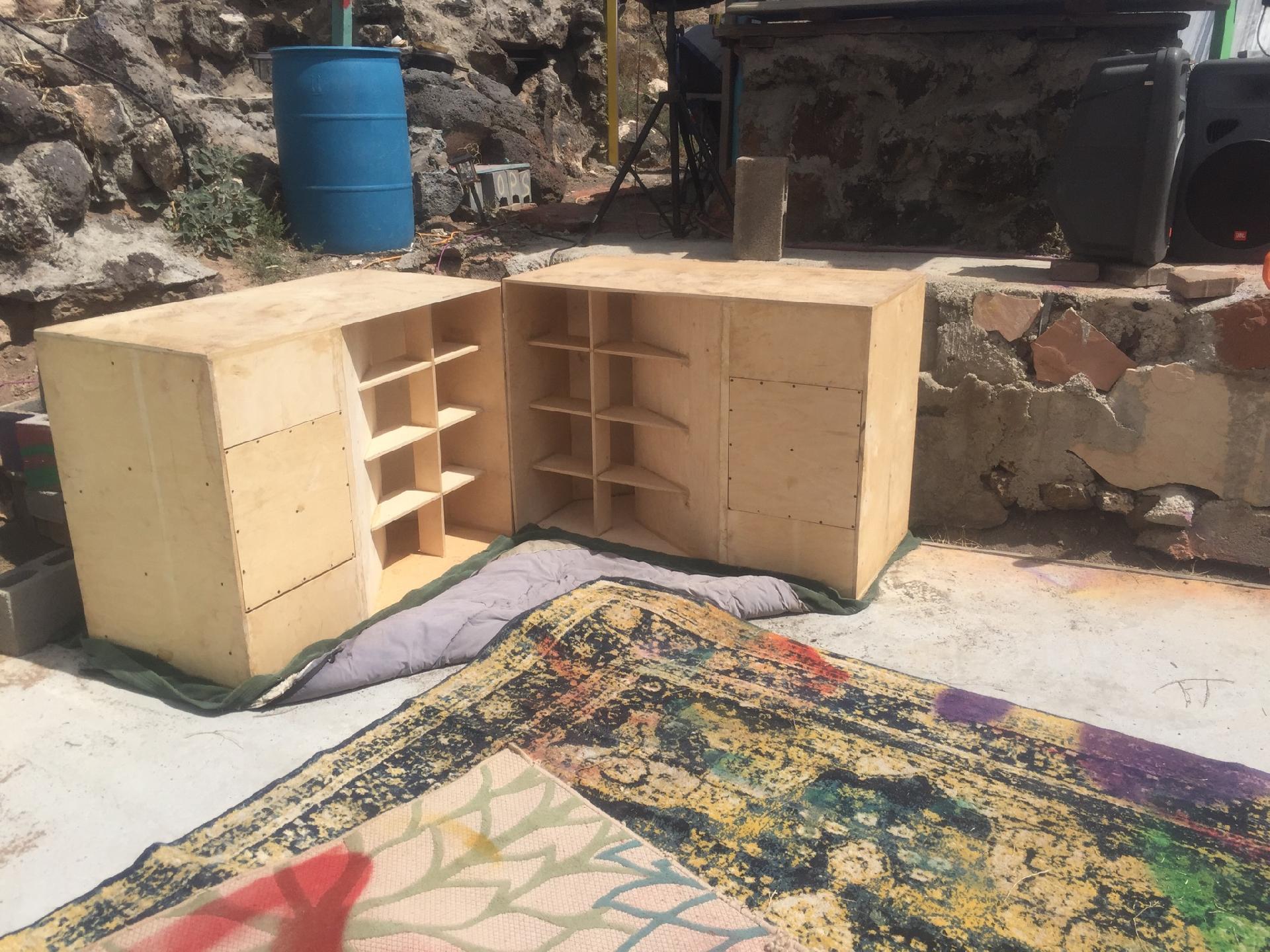

Sorry for the long delay. They still need to be painted and I need to redo the plug panels and fix one of their plug access ports.
But they have been tested, enthusiasticly approved of and run successfully.
The Saturday after my last post, I woke up early to test them out.
I set my limiter to just over 50V and started plugging stuff in.
While hooking them up, I noticed I labeled the ports wrong on one of them, but that's not a big deal.
With the first test track, they sounded great, smooth and rich. I was amazed by how much sound they made while barely vibrating themselves. While feeling them, I noticed only one was working and got worried, so I switched their wires and the other one stopped working, then I checked my connections and noticed one of the wires on the amp was loose, so I tightened that down and then they both slapped.
We stated turning them up, because we had to test them, and the wood shop stated rattling, then something fell off a shelf, so we turned them back down to a reasonable level.
The following weekend (Labor Day specifically) was the big event that I had really wanted to have them ready for and with the successful test, we took allcrhe gear out and setup on Tuesday, for sound check and such. I tried my best to wall/corner load them, but was kind of limited by the layout, but over all I was happy with the placement. Plenty of even bass across the entire dance floor area. I did get some weird delays from the dj booth but only with 175bpm (give or take) 4 on the floor baselines, where the bass hit would arrive halve a beat late, id you stepped a few feet to either side, the effect went away, and I could find it amywhere else, but I able to consistently reporduce it with different songs that had similar tempo and driving bass. I'm pretty sure it was reflection of the brick wall to the left of the picture, Dj booth is on the right.
Very cool and educational to get to experience that first hand
P.s. I Still haven't turned them up all the way, max I've hit is about 75% on the amp, which is an old Macro-Tech, so i know it can handle it.
