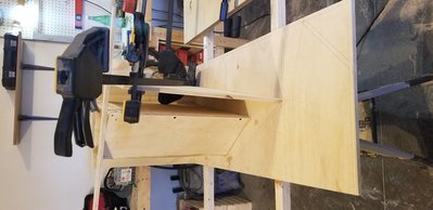

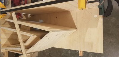

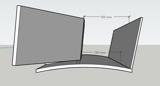

JensToft91 wrote: Mon Jan 24, 2022 8:03 am Just realised a big mistake. I alligned panel 7, so the distance is the same to panel 1 at the top as it is on the buttom. But with the first side curved, that won't be a 90 Deg angle. Panel 8 is attached to panel 7, which will give it the same "not"-90 Deg angle. Panel 10 can't be rectangular now, as it won't allign with panel 8.
This will also make it impossible to straighten the curve 🙄
Well. The horn probably won't realise that it's not rectangular 🤔
I'll fit panel 6 and 9, and then cut panel 10 to fit.
I'll then split the other side's into multiples, without 45 Deg angles, as the side will end up as curved as the first. I won't be able to fit the 45 angle sides together.
The will probably not be the prettiest THT. But I won't quit until it works 👍

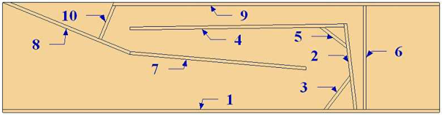

Had to put this up to follow along.
Still not sure I quite understand though.

Seth wrote: Tue Jan 25, 2022 3:31 am

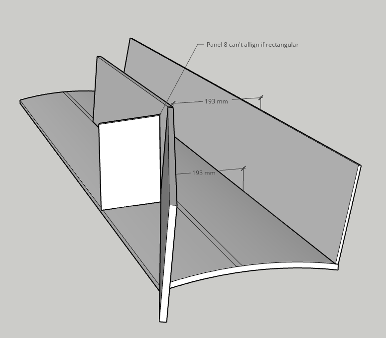

Illustations not to scale. Only to show the principle of what I'm trying to describe.
Panel 7 has the same distance to panel 1 in the top and buttom. But i forgot that this can't be true, when the panel is curved. So now panel 7 is attached at an angle. Panel 8 is attached to panel 7 - must be the same angle. Panel 10 won't be able to fit now, if it's rectangular.
Panel 8 on the illustration should be 10*

Most of the warp in that panel should have been pulled/pushed out with the installation of panels 2 and 6. If still warped at the other end a temporary brace the same size as panel 6 could have been screwed to the side and panel 1.
Posts: 3163
Re: Slim THTLP
#53 Post by Seth »
JensToft91 wrote: Tue Jan 25, 2022 6:37 am Illustations not to scale. Only to show the principle of what I'm trying to describe...
Great modeling skills Jens :thumbsup:
Make panel 10 rectangle and MAKE it fit. That's what forces the warp out of the other panel... securing it to parts that are true.
The route I'd first try is secure 10 to the side first, with as many screws as it takes to pull that little section of side snug and true to the short dimension of panel 10. Guessing only 2 or 3 would be needed for that short distance. Then, using the length of 8 as leverage, use a clamp to pull the 8/10 gap closed and secure 10 to 8 with brads or screws.
If the warp is being really stubborn, put a couple strips of lumber on the outside of the cab like Bryan said, straddle panel 10's location so you still have access to fasten 10 and screw them to the outside of the side panel from center if the inside of the panel to force the warp out and then put 10 in like mentioned above.
Do as much as you can reasonably do to pull that warp out and avoid letting the warp dictate panel dimensions. Fight back! Show that piece of lumber who the boss is, Jens! :evil: :cussing: :chainsaw:
It's the unfortunate tradeoff of using budget lumber. All but one of my builds have been out of budget lumber. I'd use it again. Just takes more effort to build as square and true as possible.

Fortunately, I got the other side sawn an inch or two wider than the first one, as the TT was a hard fit (curved as well).
So the box will end up as straight as possible - but I don't want to fight it too much. I'll focus on making this as tight as possible, so I know it functions as intended. The other side is warped as well - and by being longer it should fit right on top. What's lost on the "inner curved" is gained by the "outer curve". At least I hope so.
I will probably end up splitting the side, as I don't feel confident enough in how well it seals up. With a split side, I can chaulk the joints as I go along. The I'll punish it by sanding the shit out of it, and hide my mistakes with paint.
Function over looks.

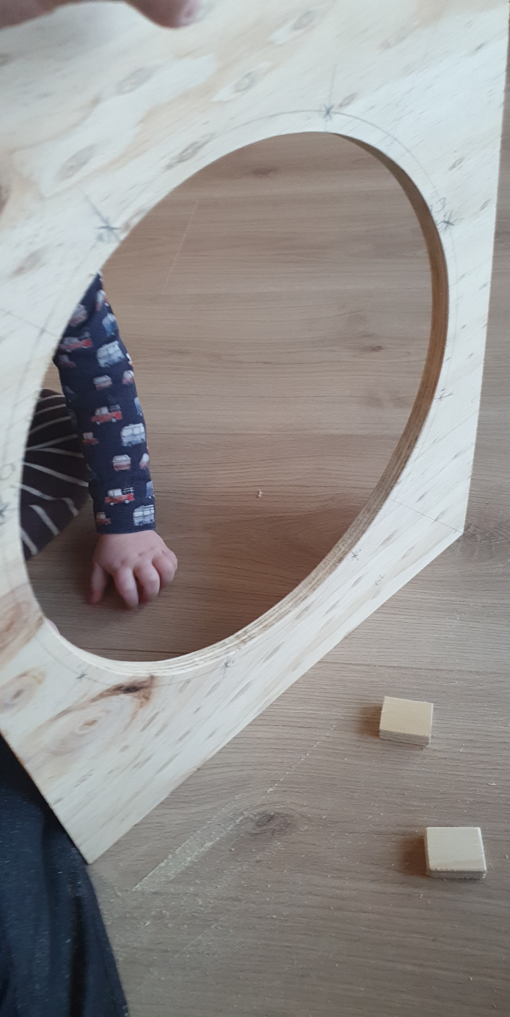

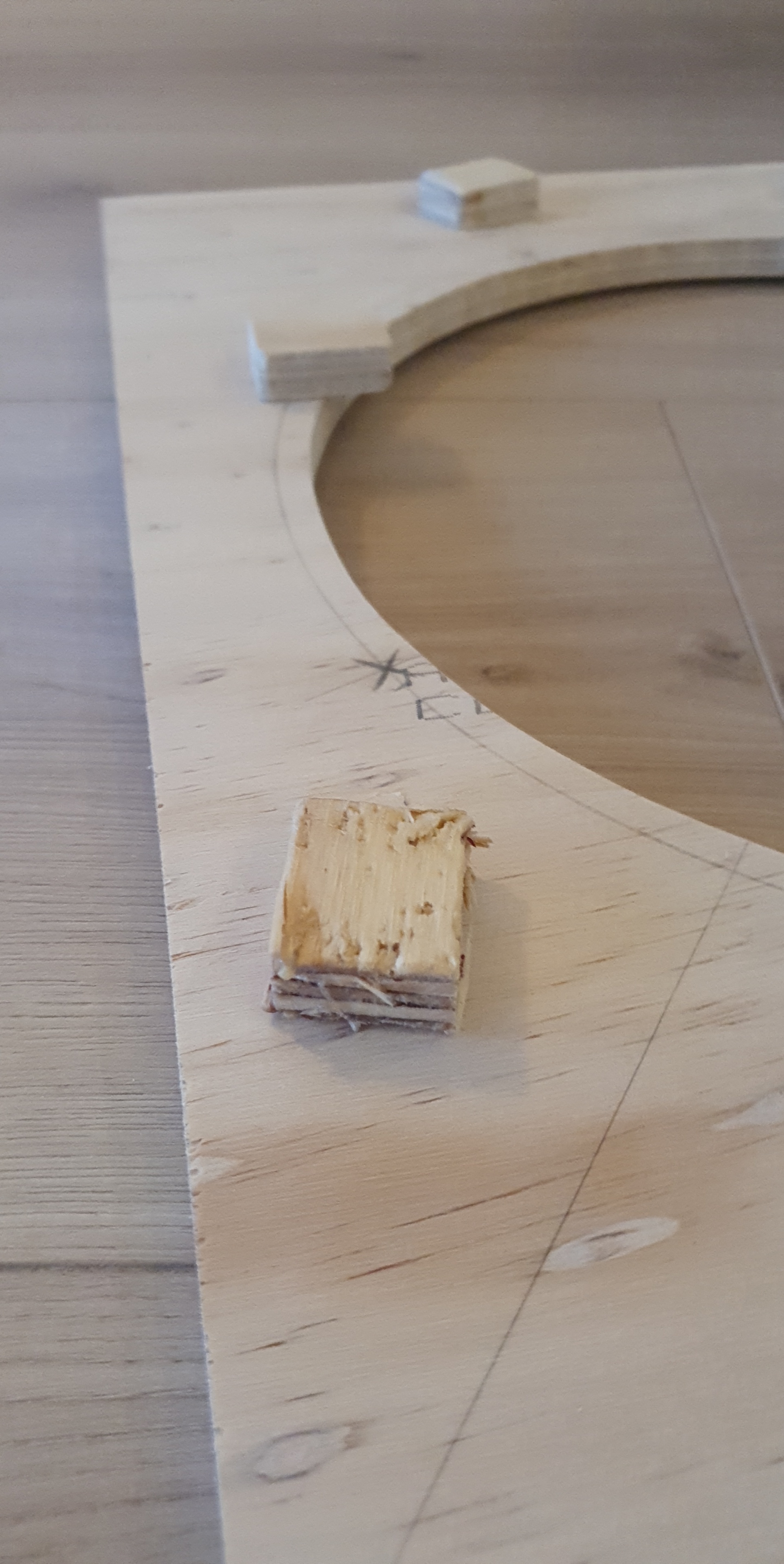

I've tried the router-nail issue as well, it's so annoying, to have measured everything exactly right, and then the hole ends up way off.

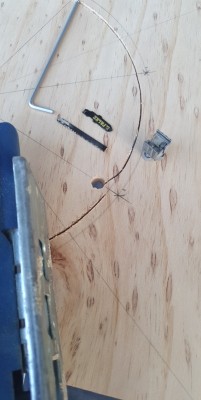

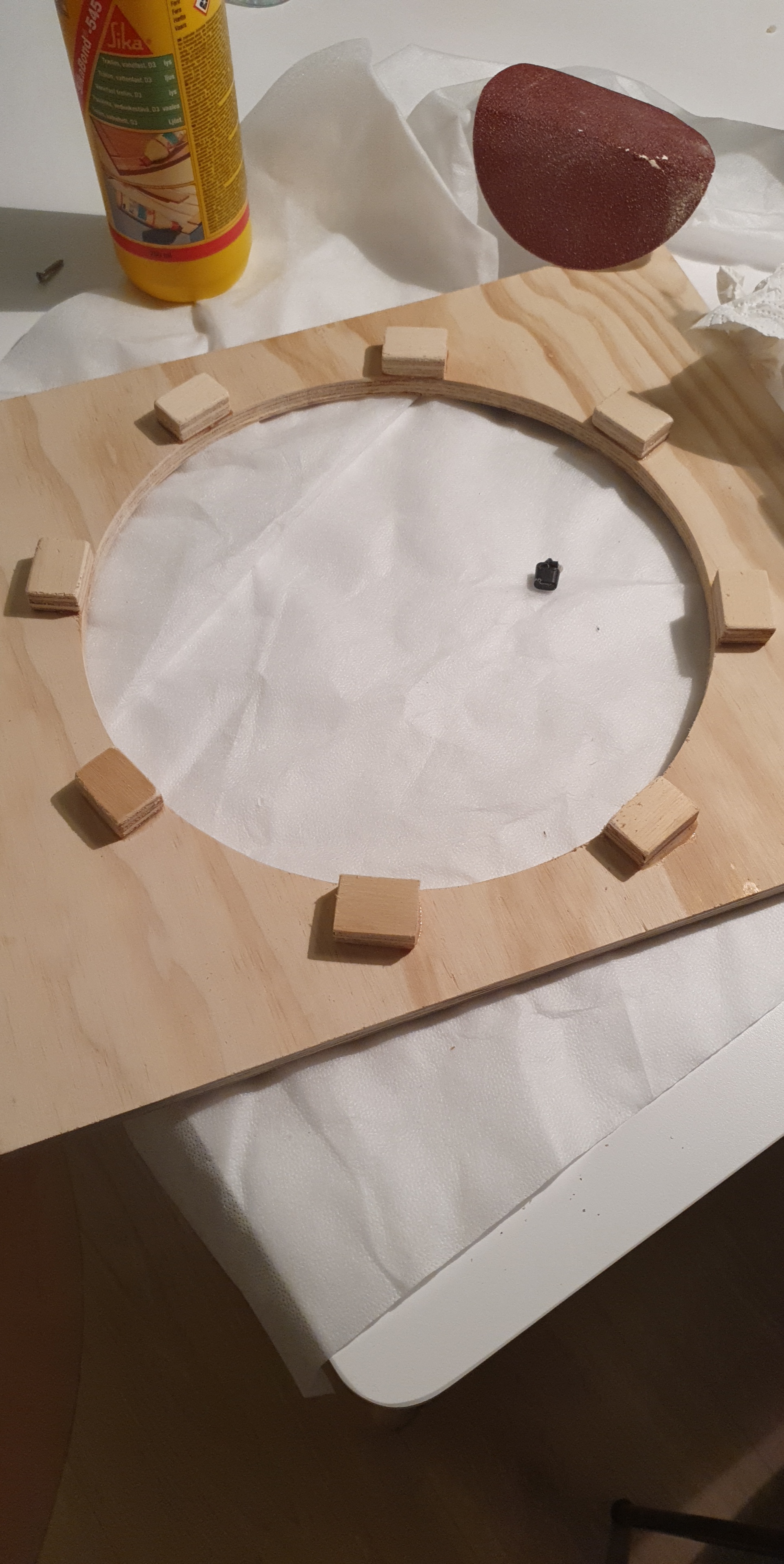

Quick update:
If I believed in signs from above, the cracked saw 1 inch from the finish line mig scare me abit.
Then the dog ran off with one of the screw retention blocks.
Hmm. Taking my chances anyway.
My boy had great fun with throwing the retention blocks through the hole.
Testfit with a another 12 inch.
