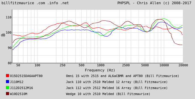

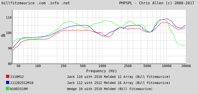

I think you two guys could use some lessons in outside the box thinking :mrgreen:
Without any means of tuning the speaker, you guys may have a point. But, please allow me to retort. If each were tuned to the same response curve (with DSP) the WH10 very much holds it's own with the highest average sensitivity from 200Hz to 10kHz, which means it will require less power for a given output.
(Haven't seen these graph things used in a while. My first time. Pretty cool. Thanks Chris :thumbsup:)
Removing the larger Omni 15 to compare similar sized options and the WH10 is the clear winner from 125Hz-10kHz
And really, below 200Hz is nearly too close to call with these three.
Even if you fed the WH10 only 50w and the others 100w, the WH10 would have 113dB max at 60Hz on 50w, where the Jack 110 is only 1dB more with twice the power, at 114dB, and the Jack 12 117dB.
Realistically, this project needs to run on a light and compact battery. Every average dB of sensitivity adds up to less power to make the same volume. Sure, the Jacks and Omni options may technically be able to go louder, but they take more power to match the output of the WH10 and even more than that to exceed it. Which equates to reduced run times between battery charges. And ... it would really take 4-8 times the power to really appreciate the additional output capabilities of those options. IMO, running that much wattage on a compact battery pack is not a very realistic option.
Another thing that the WH10 has going for it is; if the speaker is going to be set on the ground, as I can see being likely for the type of use he's described, the standard designs will be aiming the sound at everyone's knees. Where the WH10 design aims it upward toward their ears.
That's my argument... from outside the box :lol:

However, I wouldn't build Jacks with the 2512, I'd use the 3012HO which will give you almost 50% more xmax over the 2510. 6.2 to 4.2......and that will let you add more power and go lower and louder.
Plus, my real-world experience with the WH10 that I built years ago didn't impress me with the low end or the flatness. The kick drum and bass farted it out too easily. As a monitor carrying mostly vocals, acoustic guitar etc. it was fine, but we were playing everything direct with E-drums and bass it just was more bottom end than it would handle. So, when it comes to bottom end and full range, I'd go with the Jack every time. It's the right tool for the job.
Posts: 3166
Re: Bought a bunch of plans still haven't built anything...
#55 Post by Seth »
Bruce Weldy wrote: Tue Dec 08, 2020 7:56 pm However, I wouldn't build Jacks with the 2512, I'd use the 3012HO which will give you almost 50% more xmax over the 2510. 6.2 to 4.2......and that will let you add more power and go lower and louder.
That's about a 3dB peak advantage. But, again... that's only if you have the power to take advantage of it... and in this case, a battery capable of supporting and sustaining the power for an acceptable amount of time.

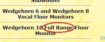

Is the WH10 a full range cab? No
Is it's purpose as a full range cab? No
The shape of the exterior of the box is purpose designed as a monitor, however it is a full range cab.
