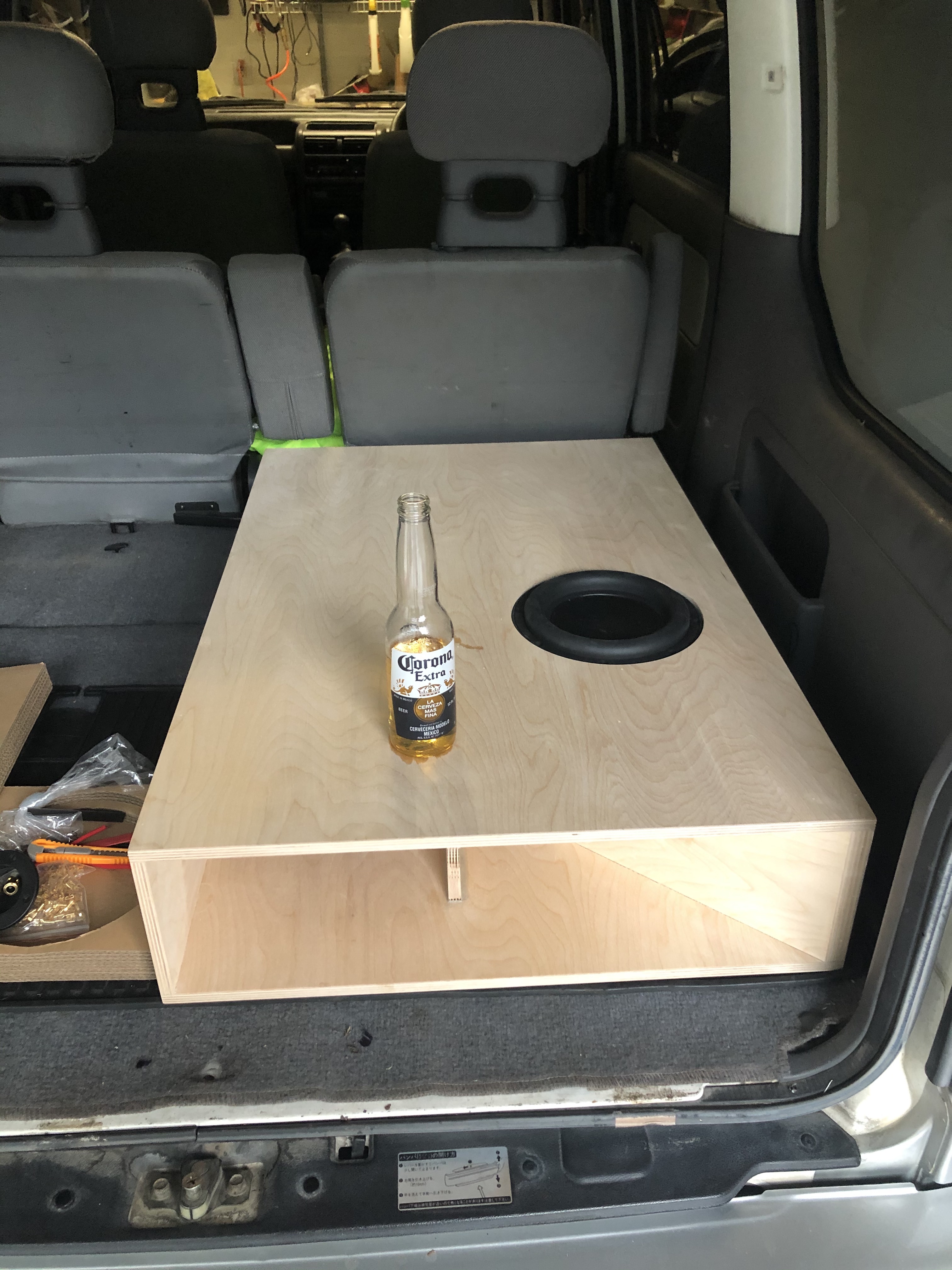

SethRocks that's a very cool build- using two drivers mounted on the side panel. Perhaps the TAT should should also be called the "Trunk Auto Tuba."
How many liters does that move.
I have been making progress with my kei van project- 6" depth.
I am tempted to try my Exodus Anarchy TH in this also. It's an 8ohm.
I still have a pair of those drivers in 4ohm but wanted to save them for a 2-way TL or MLTL one day.

Nice job. Your TruckTuba came out necely. Have you given it a listen?
