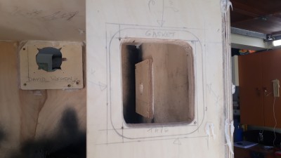

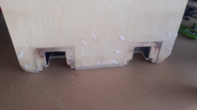

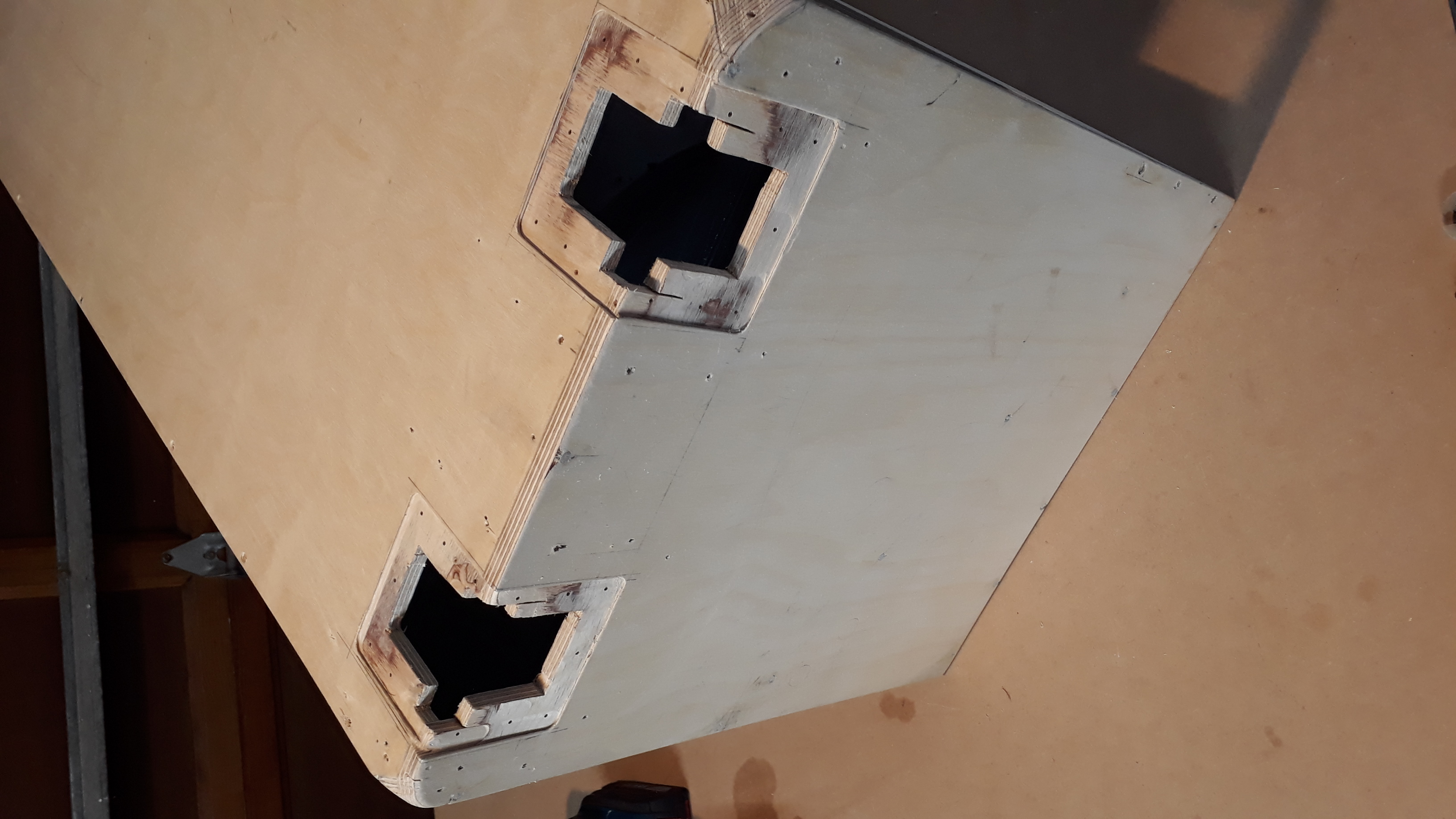

UPDATE 10 - NEW BUILD - Omni 15 Tall Boy in New Zealand

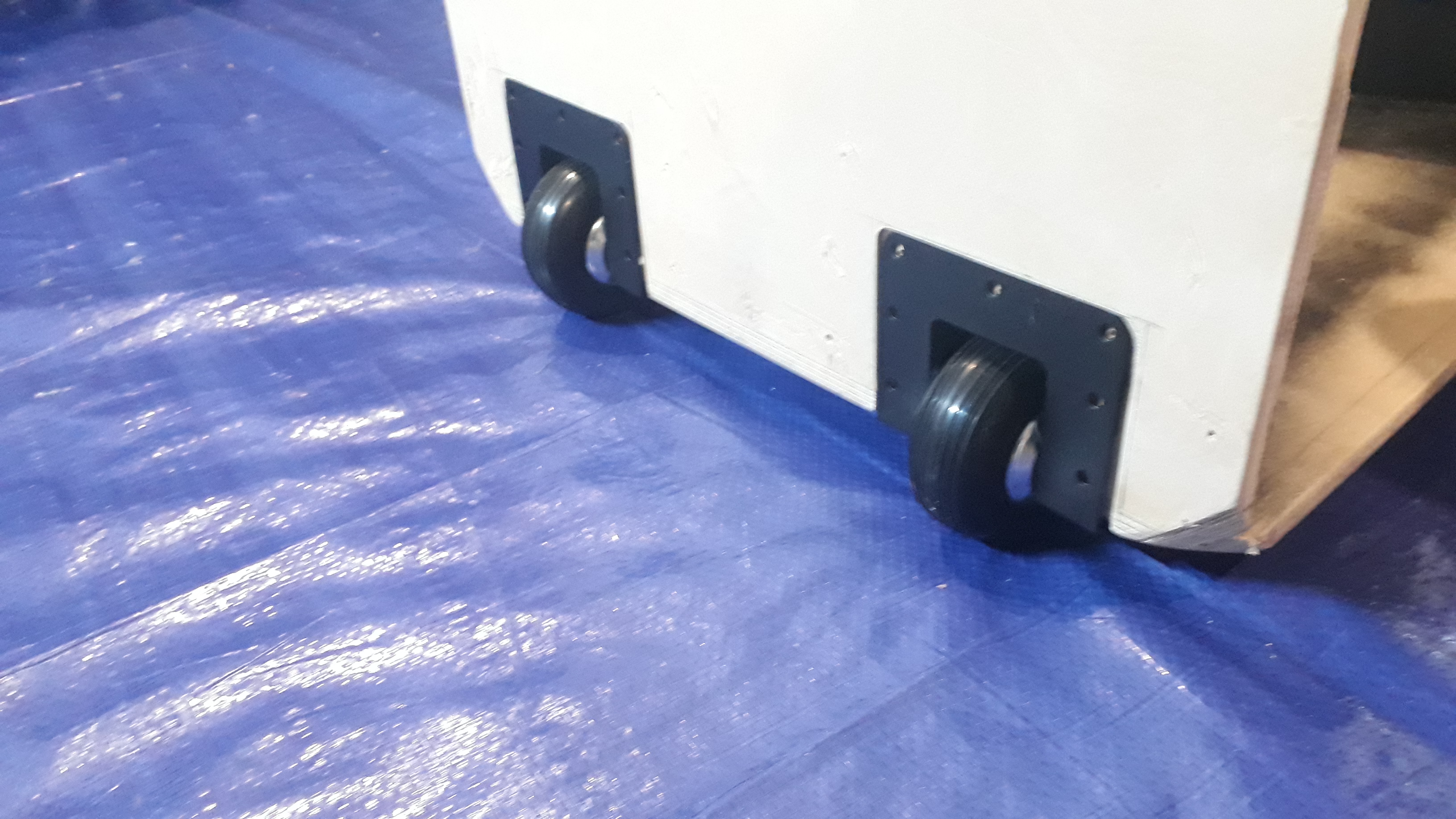

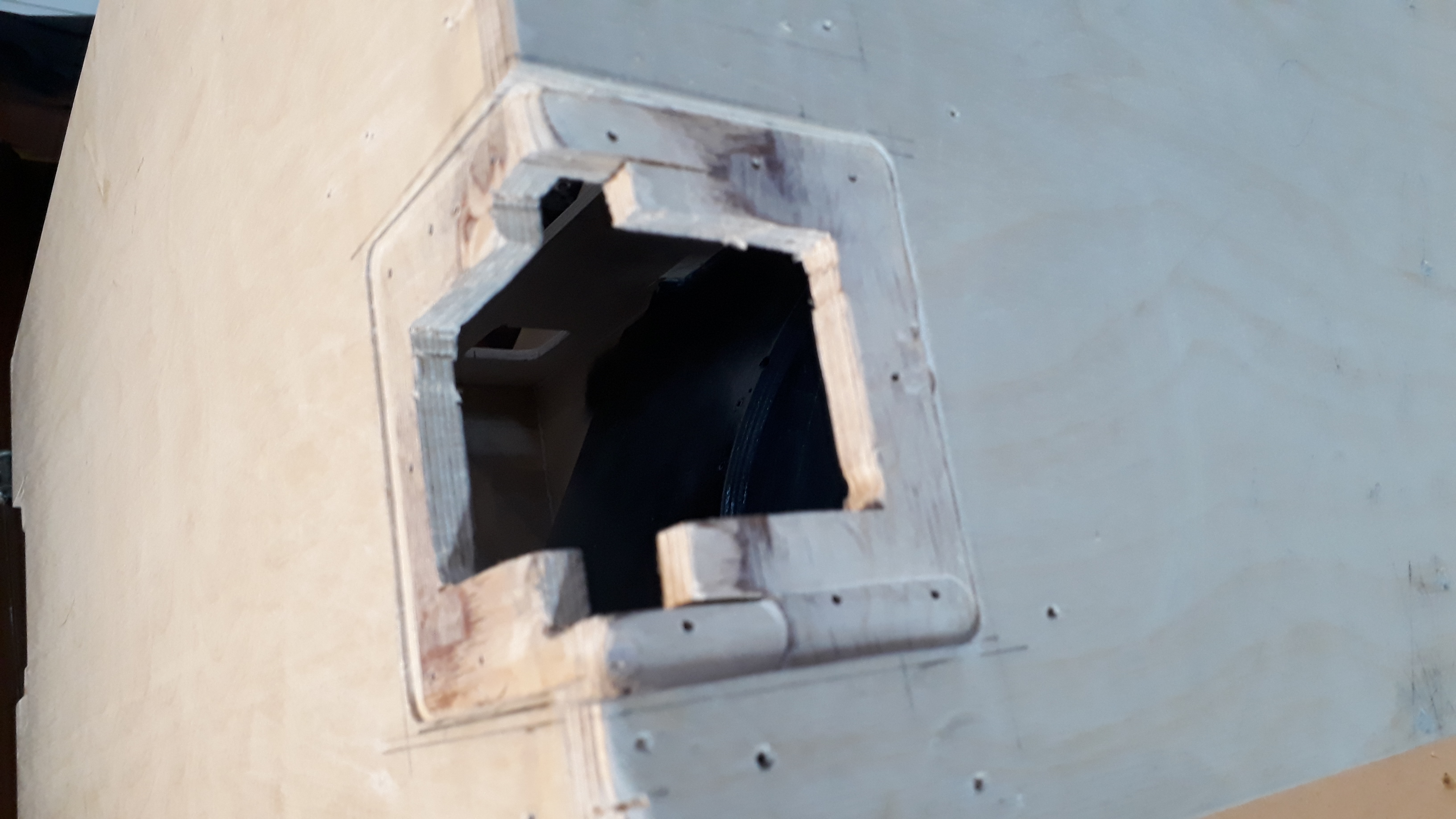

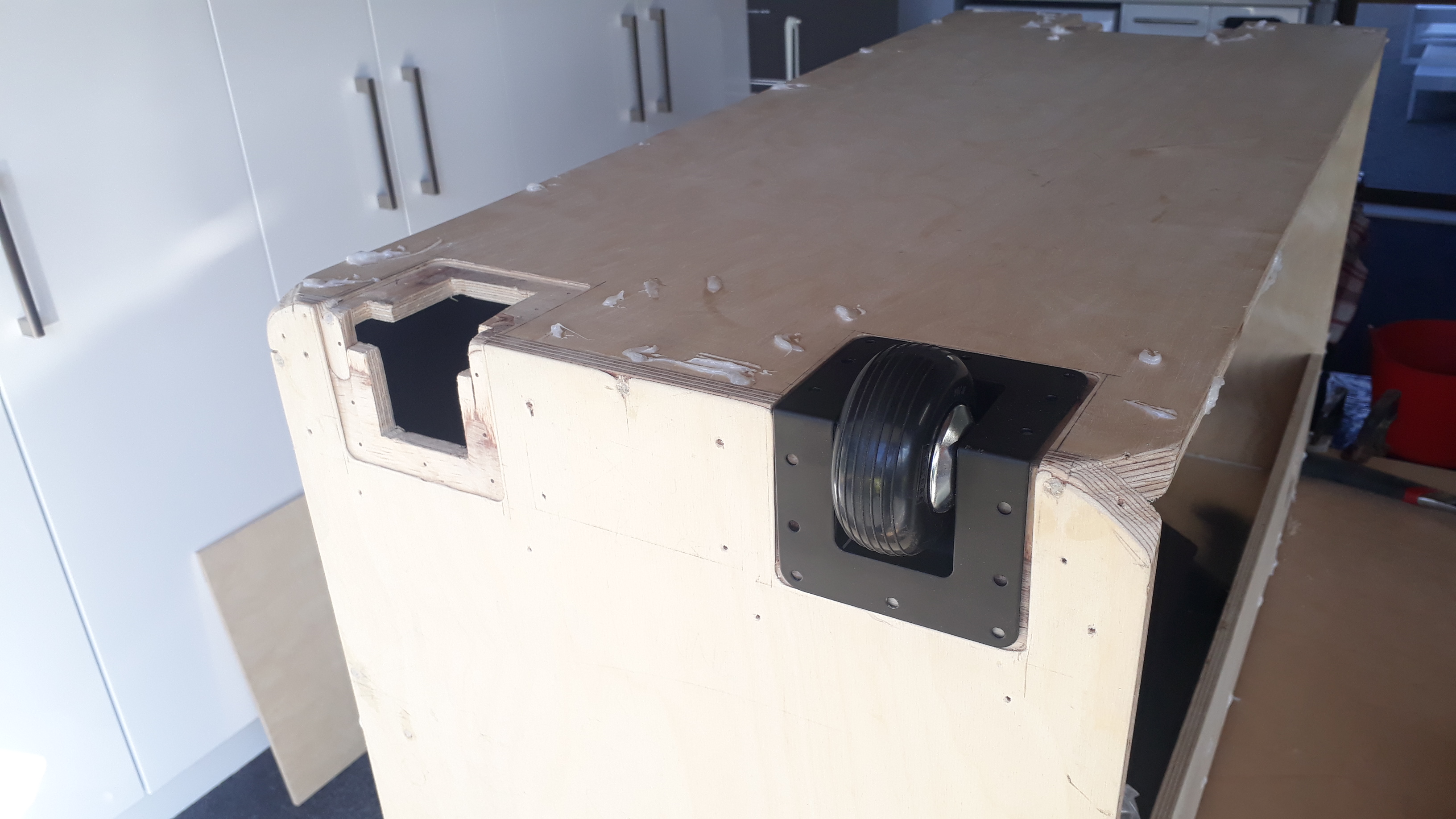

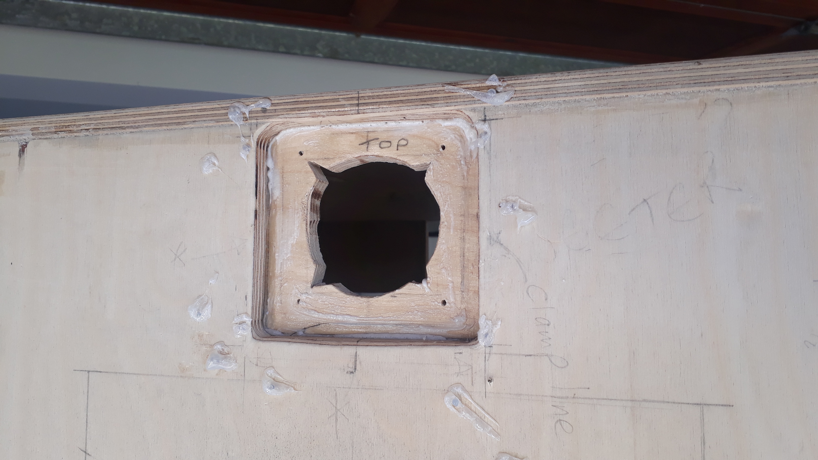

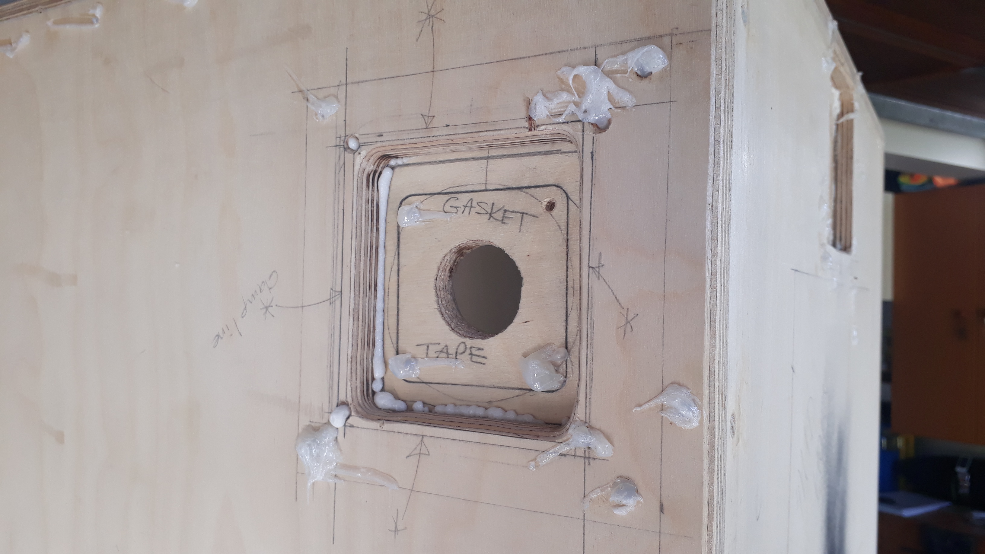

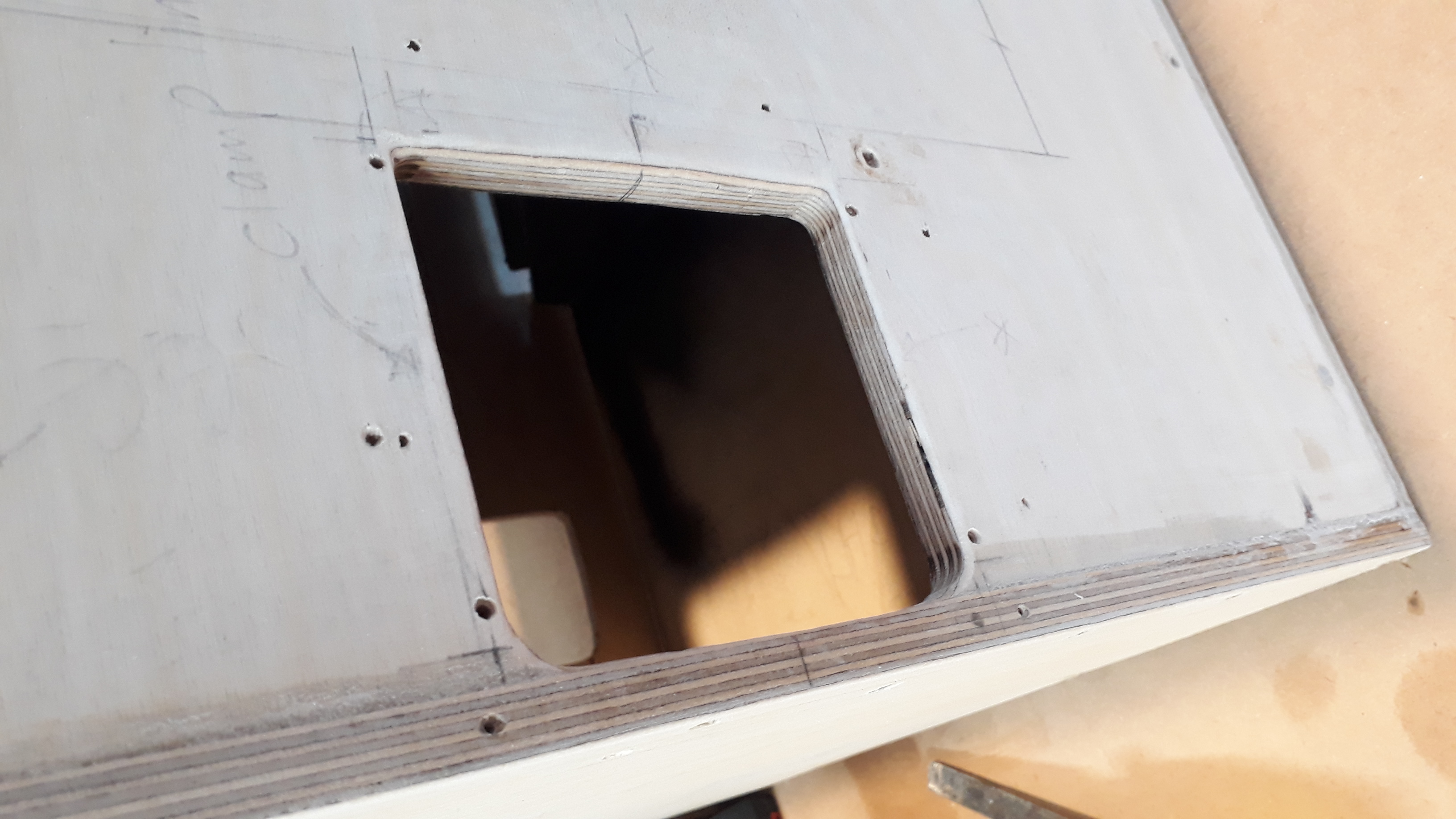

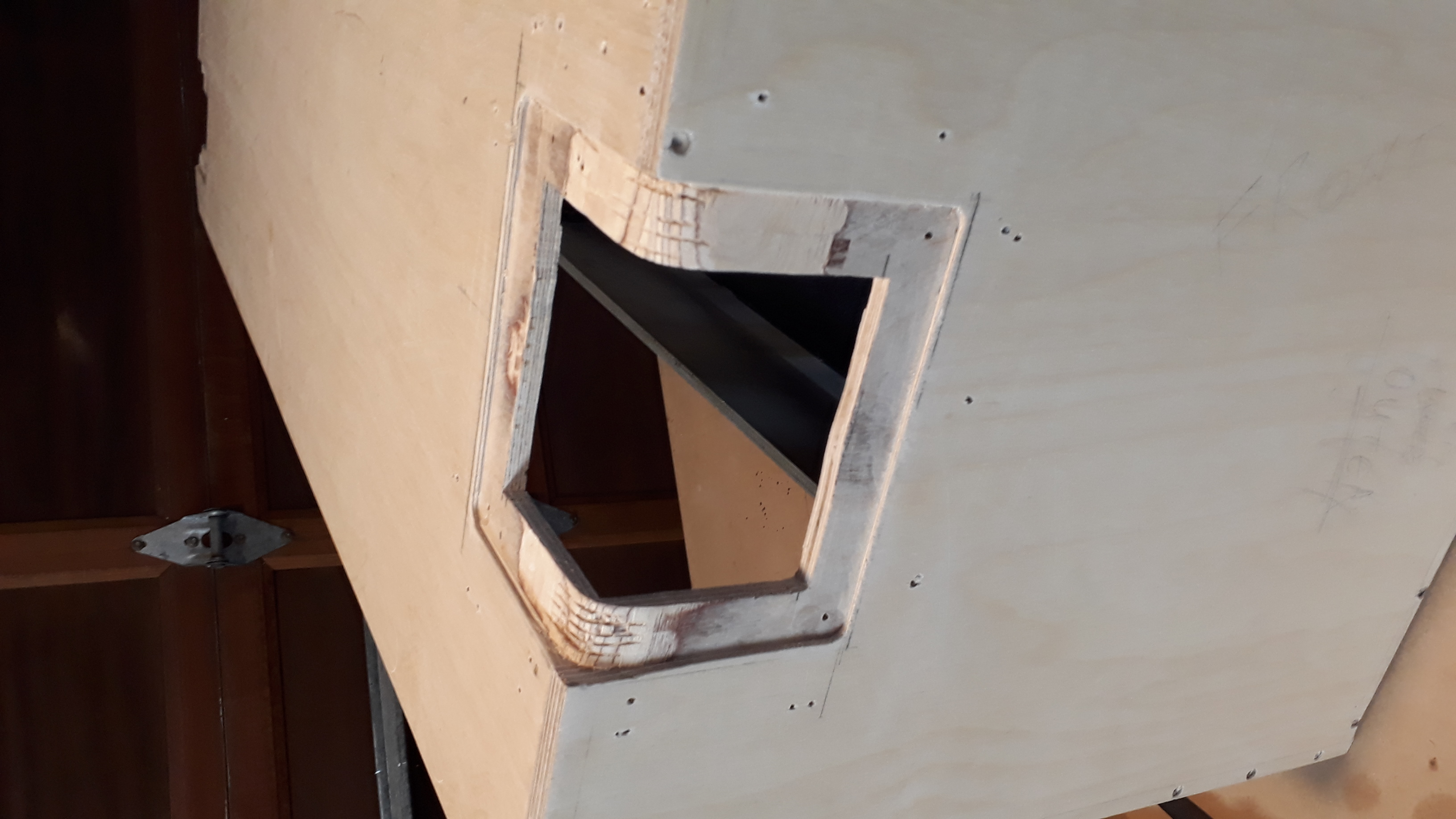

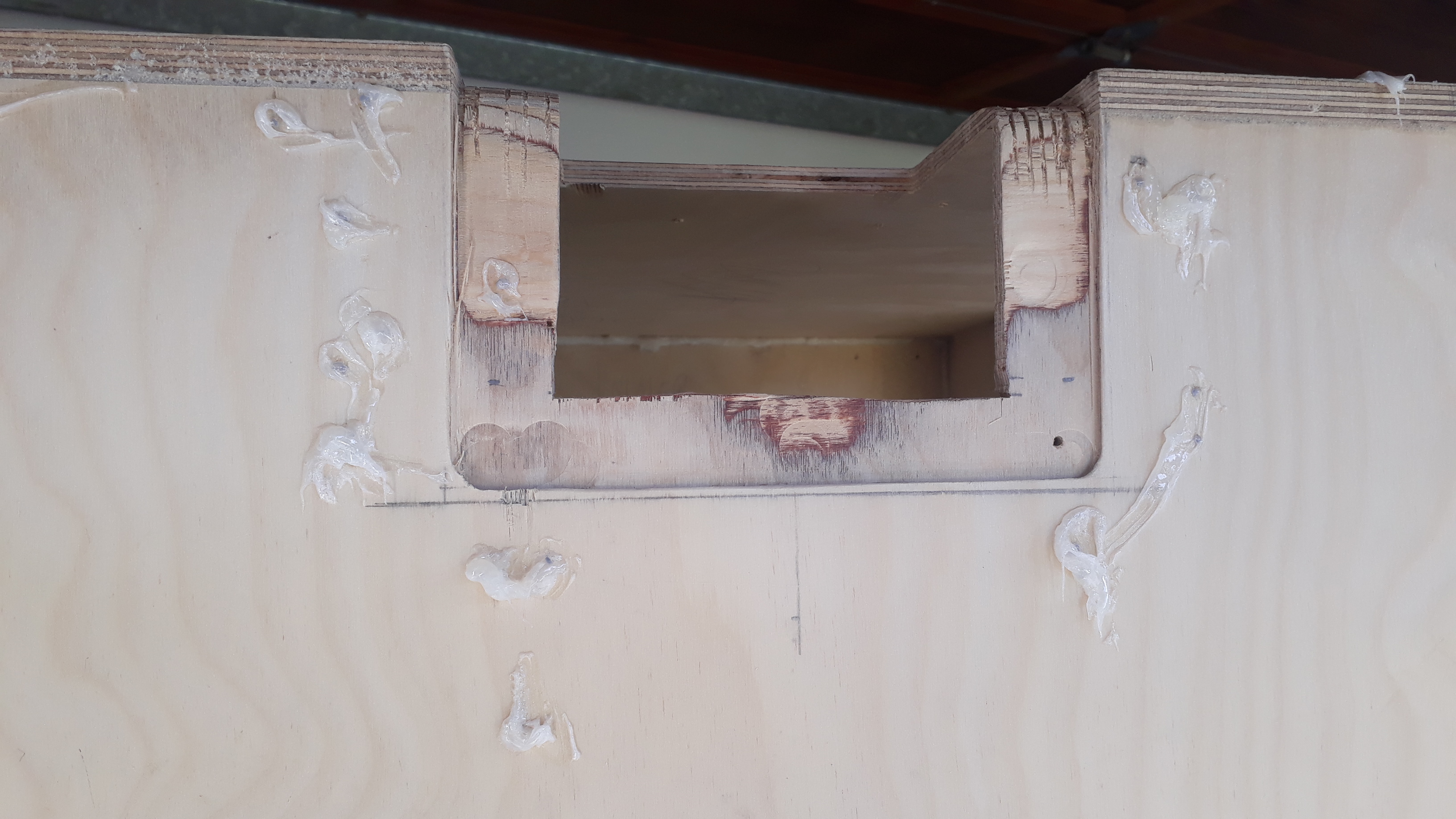

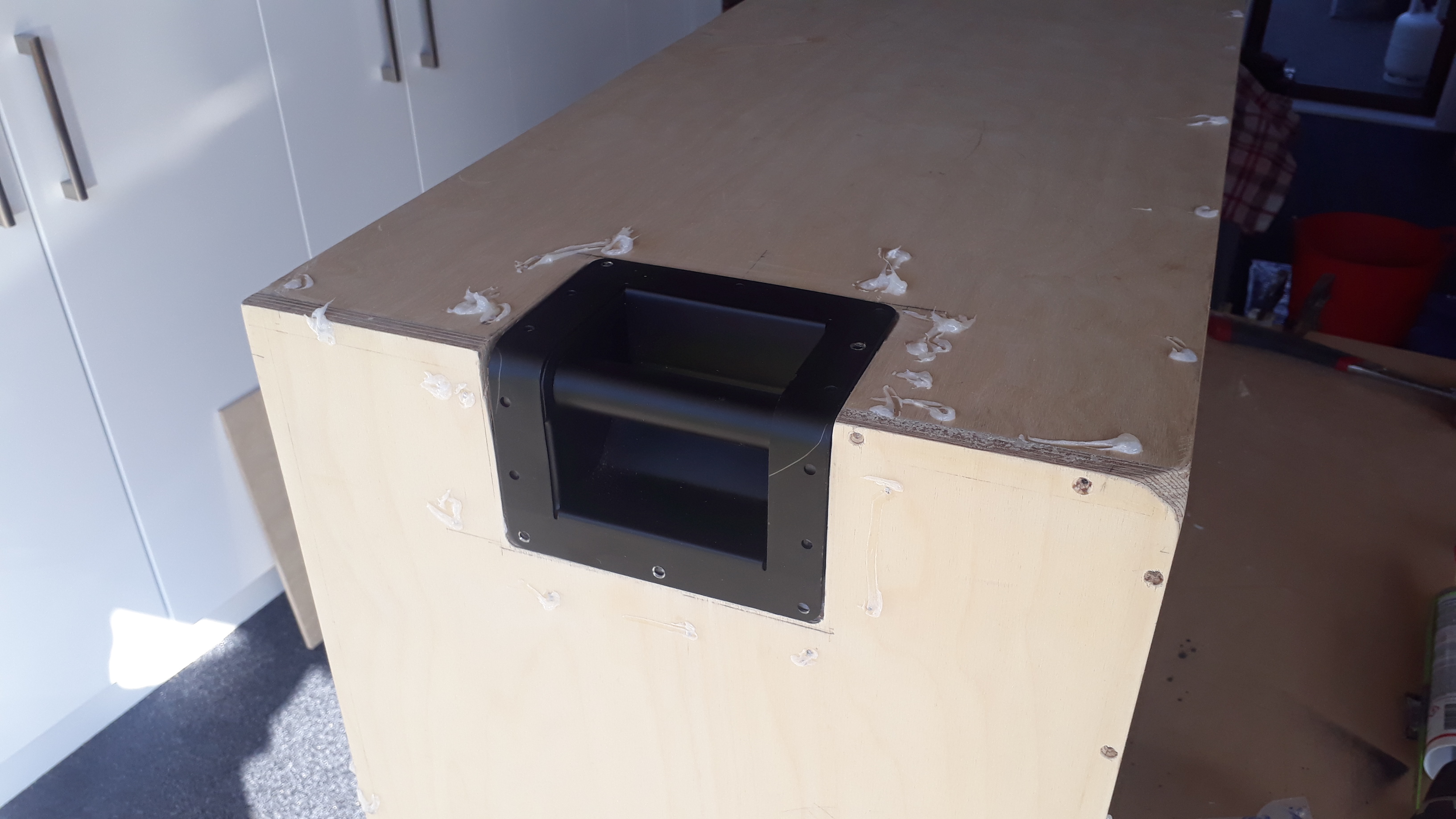

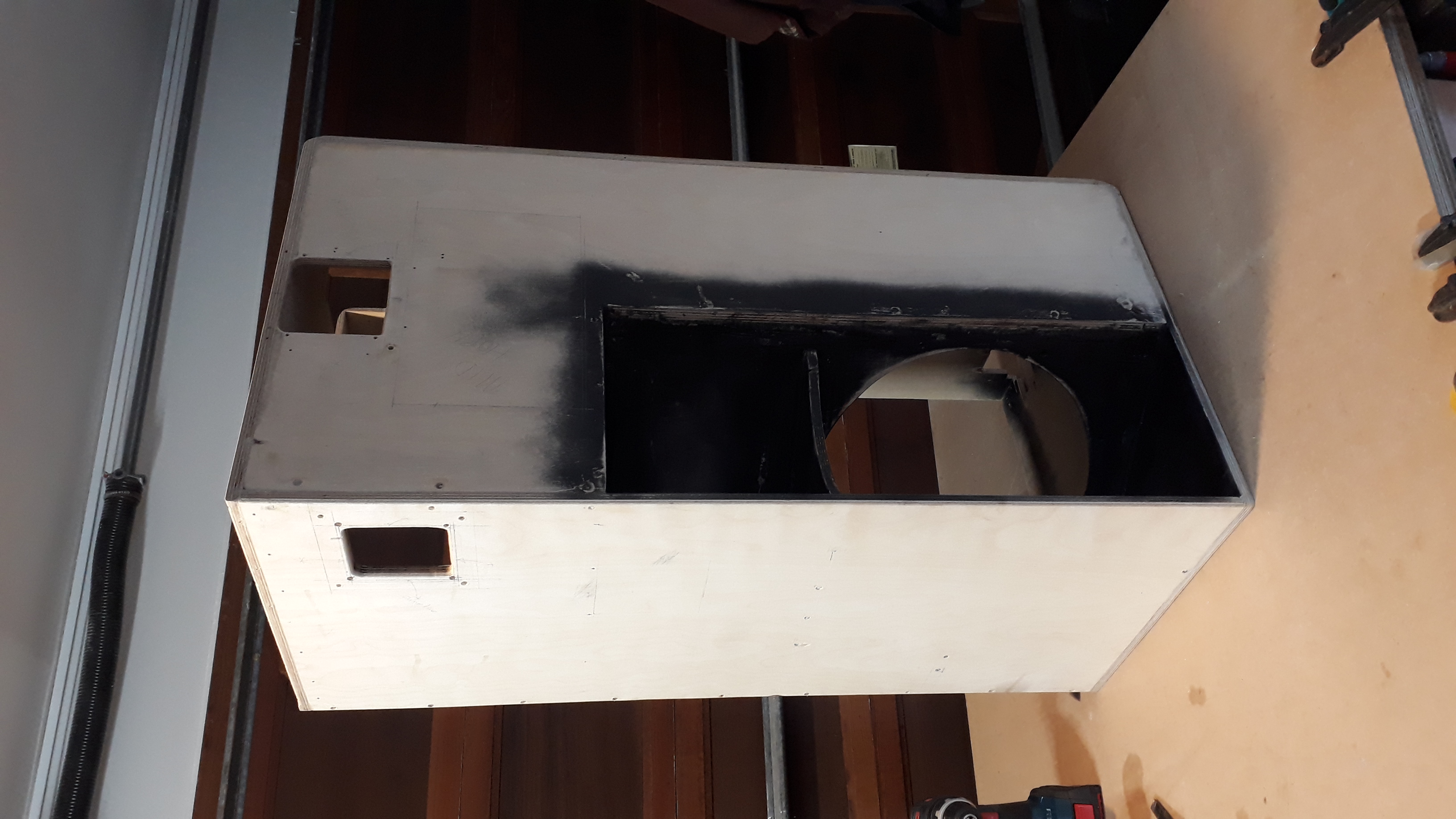

Hi All,
Progress has been slow.
Basically I've been teaching myself how to use a router to recess the pull handle, wheels, tweeter, L-Pad etc.
This routing is all new to me and the skool of hard knocks. Had to buy a large box of plasters for all my bangs, cuts etc. I can now work out how to do it with some success.
I've jammed glue down all the various holes in the box; it looks like the pox.
Waited the required over night and most of it just flaked off this morning with a sharp chisel.
This afternoon I started on the quietly unanticipated mid-horn with some level of success. One plate I had to cut three times before I could produce the required correct angles, even using & looking at Sketchup!!
Have attached a raft of pictures for your mirth & enjoyment.
Cheers All.

More pics Re: NEW BUILD - Omni 15 Tall Boy in New Zealnd
Second lot of pics

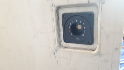

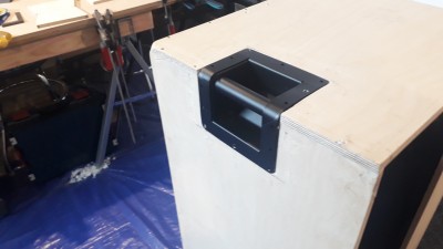

And more pics - NEW BUILD - Omni 15 Tall Boy in New Zealand
Remember Bill's comment from somewhere; just do a bit each day and soon you'll have finished your project (or something like that) so I'm just doing that.
Started test fitting the first bits of hardware now.

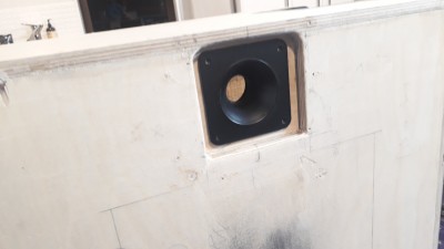

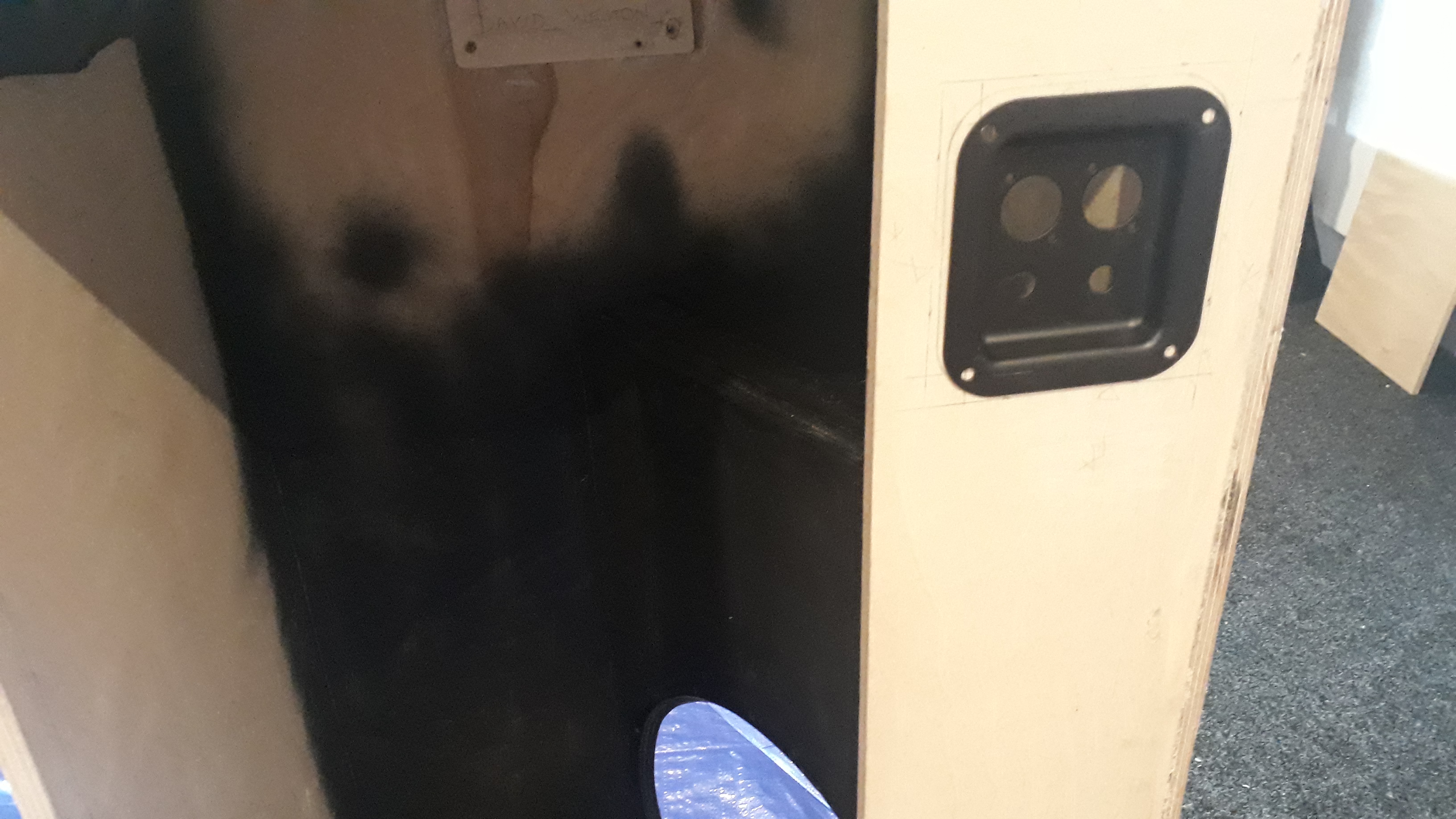

And even more pics - NEW BUILD - Omni 15 Tall Boy in New Zealand
I think this is the last group - thanks God they say ......................
Tweeter horn and L-Pad testing if I got the cut-outs correct.
Mate, this is looking goooood.
As Tom said, nice and steady, but there some great attention to detail, fantastic!
Gotta go get some popcorn to wait for the finished product
There's one tiny little thing. I see you have a dual speakon and jack plug plate.
History says that, unless you can manage to find panel mount jack plugs that are sealed (not common), that will be the one place where the cab leaks. All through these builds, we strive for leak free.
I personally discourage people from using jack plugs as they can short when inserted or removed with power on from the amp, so, please, use the speakon sockets.
Don't fret, if you're not using the jack(s) put in a couple of "blank" plastic plugs. If you can't find any of those, just buy 2 x right angle 1/4" plugs, no wire, and leave them there...
