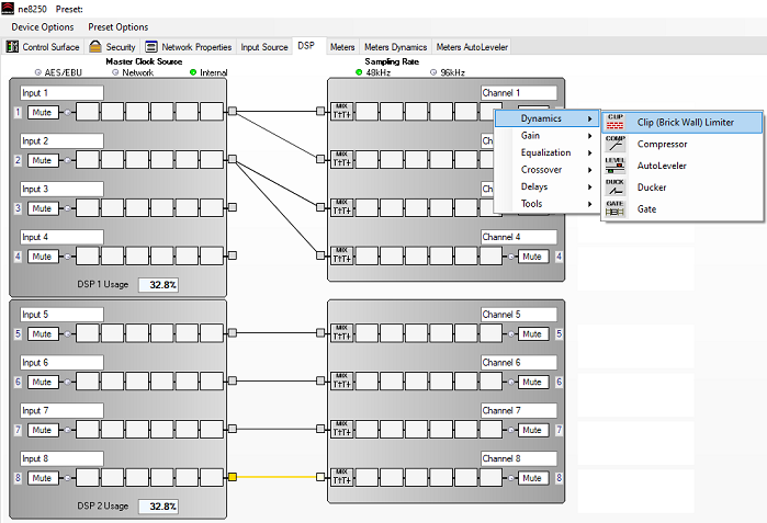

Incidentally, I've always put my crossovers post EQ in any system I've done and I really couldn't tell you why. I never really thought about it before, just what I've done since I was a teen futzing around with stuff in the garage. Maybe it was because the EQ was in the dash and the crossover was in the trunk? Could have just been something I picked up in magazine articles. I have no idea.
Here's a screen shot of the GUI for the DSP. Each of the blocks is a spot to insert a DSP plug-in. Plenty of plug-in insert spaces on either side, input or output, to dial everything in.
