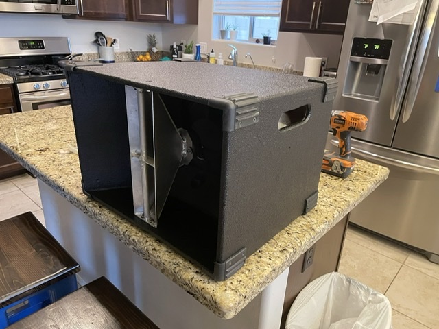

Should the mouths of those be facing the wall, with a couple inches of space between them and the wall?
- Posts: 29153
Re: Omnitop12, my first
Probably. In order to minimize cancellations off the wall behind the speakers the low frequency sources should be close to the wall, the midbass sources far from the wall. That way the 1/4 wavelength cancellation notch will occur above the subwoofer pass band and below the mains pass band.

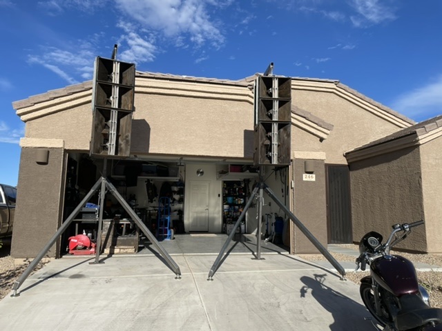

It has been a while since I have posted up anything. At the first of the year I fabricated some stands to fly my rig 12’ in the air. It’s awesome but adds 2 hours to my setup and tear down. I charge more if my client wants that caliber of rig setup. I finally optioned to paint or duratex my rig. It took me 2.5 gallons with two coats rollered on. I did my six otop12s and my 5 tuba45s as well as my amp rack. The stuff is not indestructible but it sure looks nice. Easy enough to touch up too.

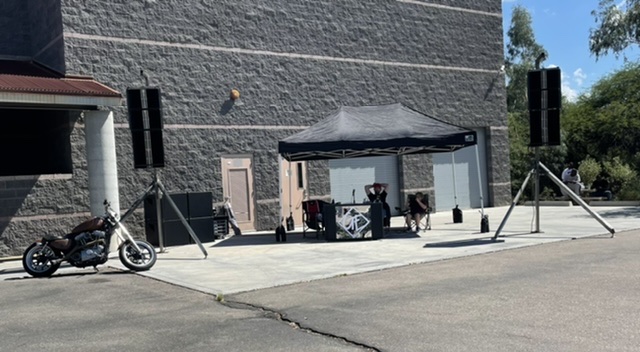

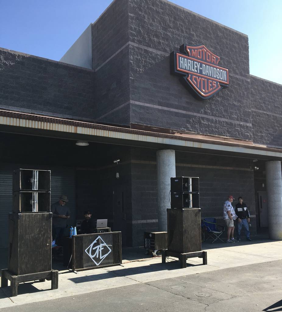

The out door event we did was a car and bike show at Tucson Harley Davidson a few weeks ago. Set up everything and blasted classic rock and outlaw country all day. It was awesome. I really like my sound rig. We did a high school home coming last week and played full tilt to 400-450 crazy screaming kids. It was epic. I sure do enjoy bringing some heat to events like that.

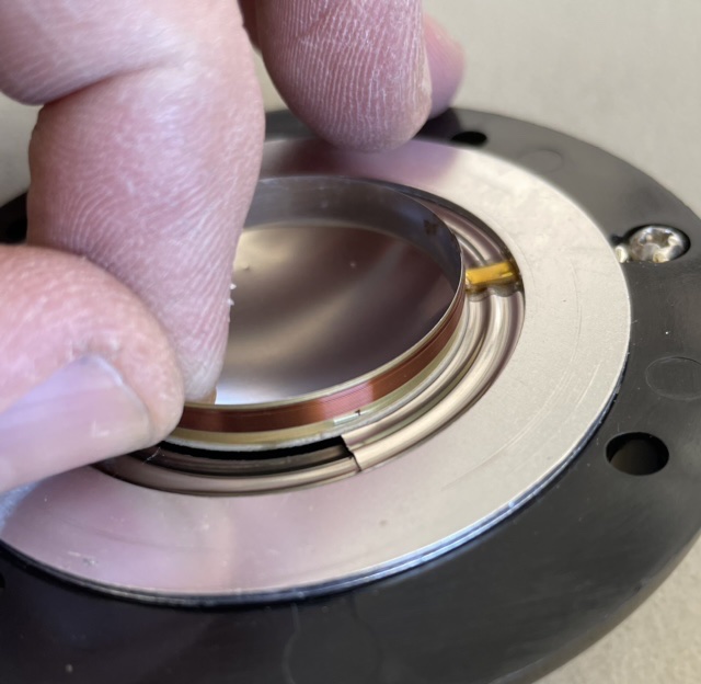

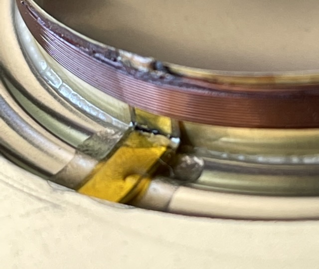

I may have tried to bring too much heat to that dance as I have damaged a few of my high frequency horn drivers. Both of these units gave up the ghost. I had never blown any of this equipment until now. The cabs that were effected are the set that I use the most and are the oldest. It’s possibly just fatigue from heavy use and time though. It’s not clear to me if I actually over drove them into failure.
I don’t see anywhere an option for coil/cone replacement options for the Eminence add-1001 drivers but the element is easy enough to remove. Does anyone know if there is rebuild parts available anywhere. At $40 a unit it’s easy enough to just buy whole replacement but man what a waste.
