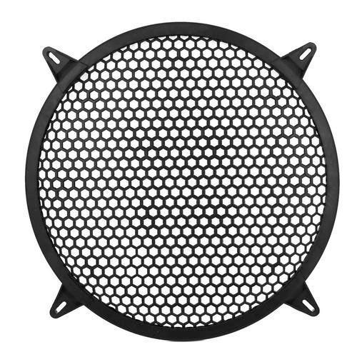

There's a store near here selling theses, i hope this is ok as it would be very simple and i kinda like the look.
Also because i don't want to order a metal grill online and again it's not easy to find here apparently.

Bought the protective urethane, PL glue and speaker grills today :D

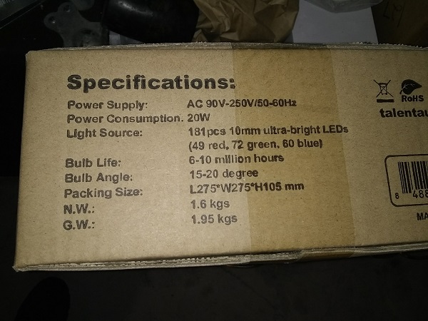

I just saw some cheap Talent LED Par64's... on the box it says the LED's are good for 1,000,000 hours....that's 115 years. So, I guess you'll get a lot of use out of a $40 bargain-basement light....
That's 1 million hours total.....divided by the 181 lights in the box......that's only 230 days per light. It's all in the math! :noob:
My church just got some to try. One of the eight was DOA, one died a week later, two more refused to respond to DMX...your 230 days/light is a bit optimistic. I have hopes that one of these days my church will realize that prices that are "too good to be true" are exactly that.
I made a mistake, though...The box says 6-10 million hours... So figure between 680 and 1140 years of constant operation.
so if I don't get at least 500 years out of the rest, I'm gonna be pissed!

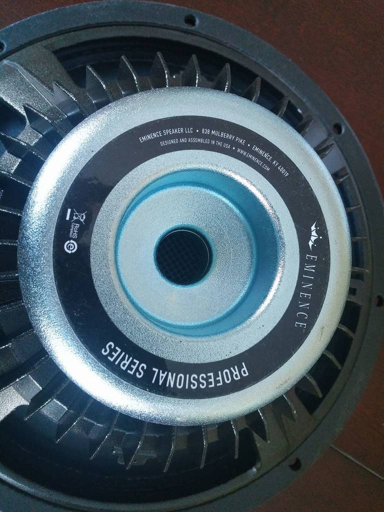

Received the speakers today :D
