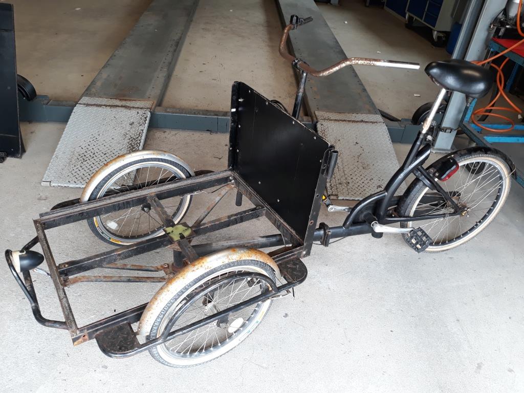

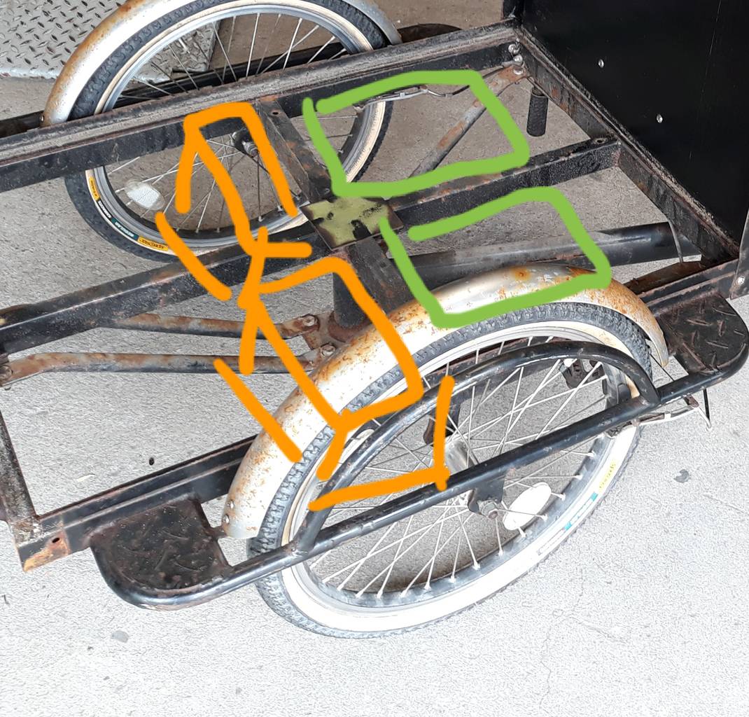

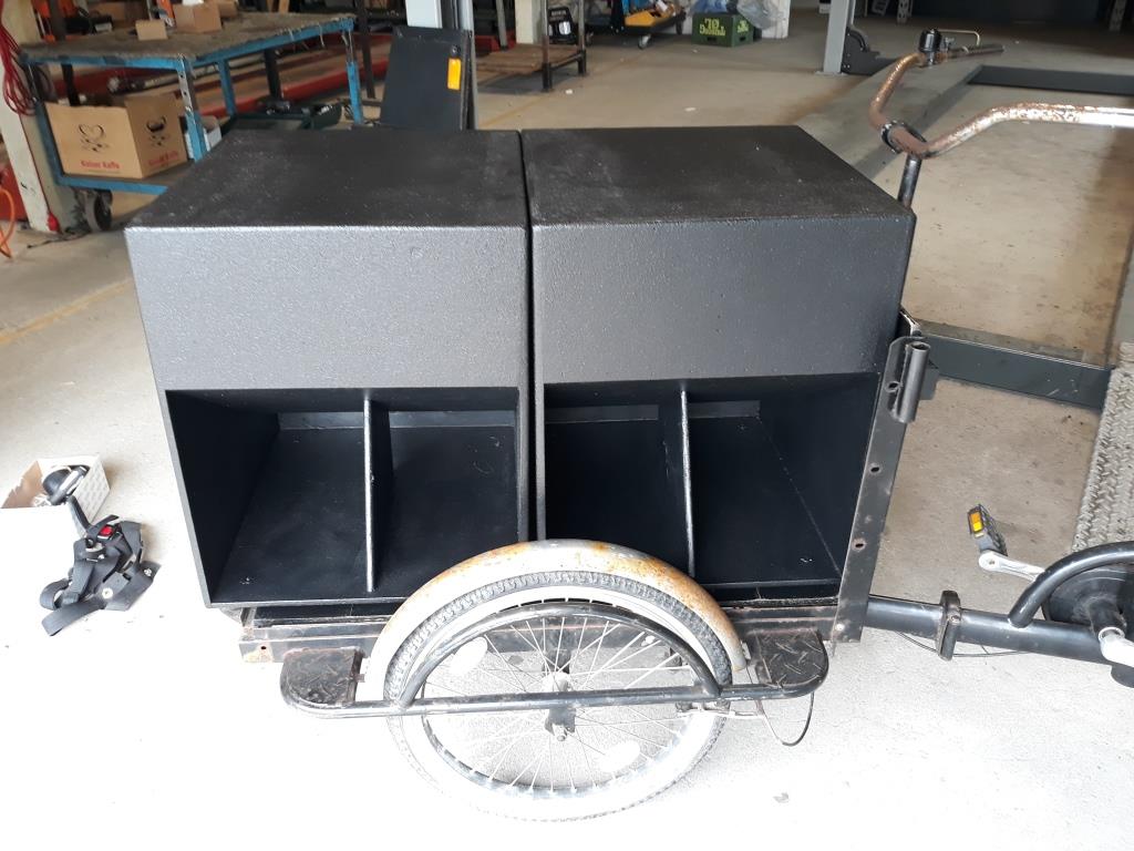

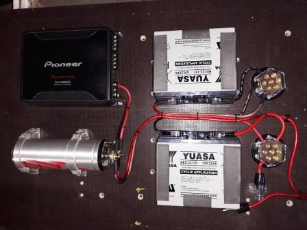

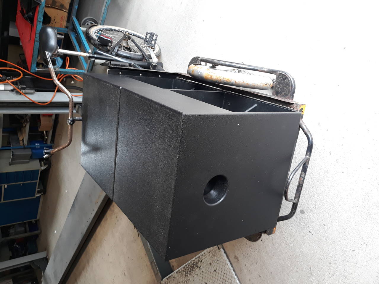

Having stripped the box from the bike, it is clear that the space will be just sufficient for the project. I actually have to place the amps and the batteries UNDER the horns! This gives a better point of gravity, so it's not all bad!
A tight fit (but I like it)
A little rusty, but just right for the job!
Orange for the batteries, and green for the amps...
Going to be awsome!!!

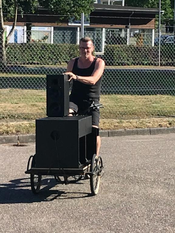

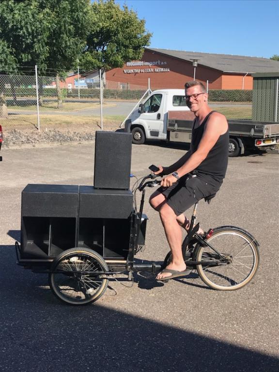

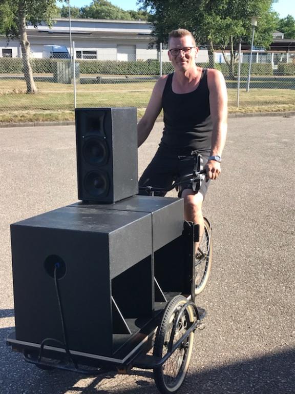

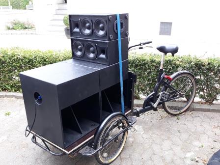

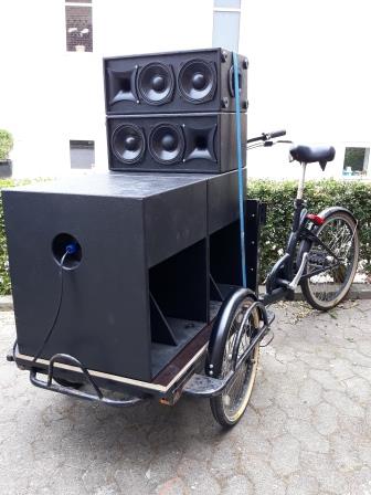

Yesterday I finally go to the point where testing bike-speaker combination was a possibility. I just needed the last 3 feet of cable for the last top cab, but it was a success! Everything came together with ease, and there was no major hick ups in the assembly process...
So, the main question is whether the TAT's do the job playing outside on the bike. The short answer is NO... :(
They do a decent job, gotta give'em that. But filling my expectations for the capabilities of the sound bike, they do not. I know; they are not meant to be playing outside, they do not have the specified drivers, and so on.
There are plenty of reasons why they don't quite make it. The biggest reason probably is the sensitivity of the drivers of only 86 dB. I guess I have to settle OR build another cab... :hyper:
Questions is what cab would do..? Suggestions are welcome! :feedback:

GREAT NEWS!!! :hyper:
Got the entire set up assembled, and found a MAJOR mistake!!! :wall: The horns was connected out of phase..! :chainsaw: TOTAL NEWBIE MISTAKE!!! :horse:
NOW the performance of the horns are QUITE impressive, even with out the gain of the cabin of the car! :clap:
@Bitsmasher: I encountered have this problem to some extend. But when going full volume on the cellphone over the BT module, the 8" drivers are getting just the power they can handle. So I guess it is OK this way. But the gain of the amp is WAY up! :loler:
