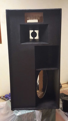

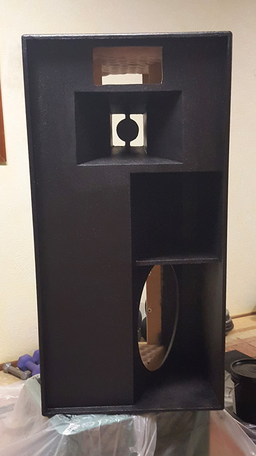

Here's the current progress:Two coats of Duratex applied and crossovers built - will mount them in cabinet tomorrow. Plan is to fire this bad boy up by Saturday.
Trying to decide what to do about a grille. Probably want something to keep beer bottles out and the ranch I cook at usually has spells of strong wind with blowing dirt/sand so I'm thinking expanded metal grille covered with speaker cloth.
Thoughts?

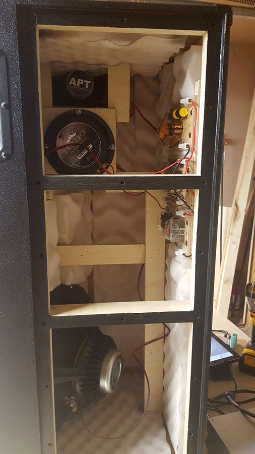

Re: Joe's Omni 15 Tallboy
Just about there!
Crossovers and drivers installed: I fired it up tonight and wow!
Managed to annoy the wife pretty good
I just need to figure out the grille situation and dial in the EQ. It definitely seems brighter in the midrange and higher.
I did notice that the midrange driver is slightly offset when mounted on the horn and I'm concerned about the cone rubbing on the phase plug extension. I'll see if I can correct that this weekend.
Thanks Bill for the excellent plans and sketchup models!

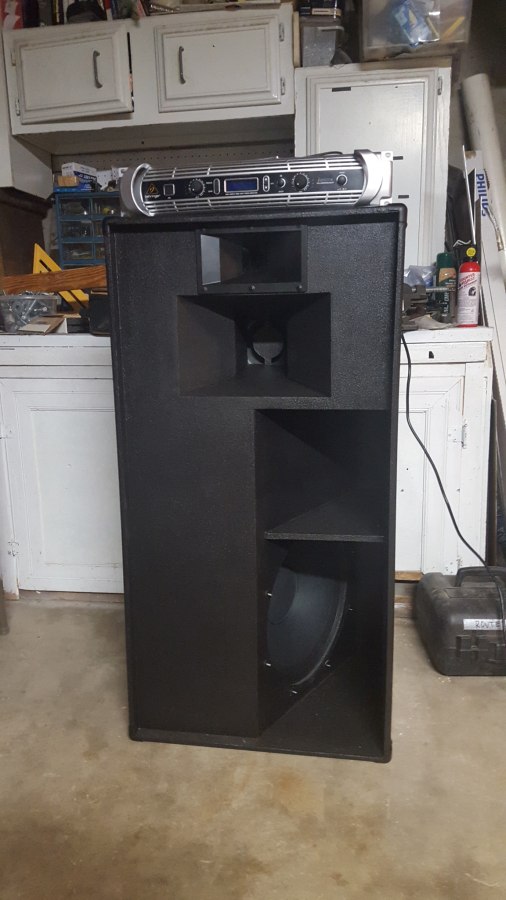

One more from the front: My 20 year old son came over and listened to it and is excited for me to build the T39s and DR250s. I really had no plans to take things any further but what can I say.....? This is too much fun
