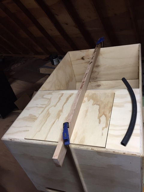

I used a long caul to clamp down the access cover for the leak test. Then I put some Daft Punk through it for grins! Big grins!

Second side glued on! Cab rough-sanded and rounded over! Driver installed and cab leak-tested!

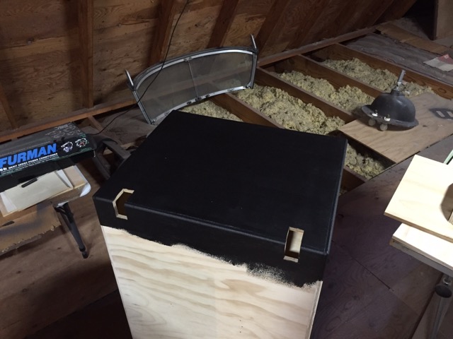

Caster slots done and Duratex started!
Also converting an old, ill-conceived TQWT into an amp rack (it just happened to be exactly 19" wide internally!):

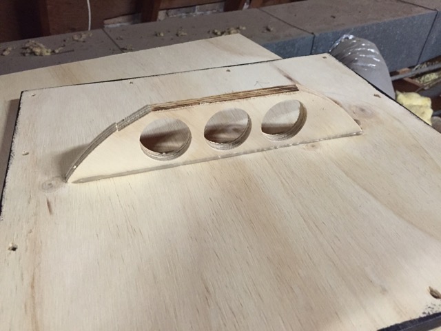

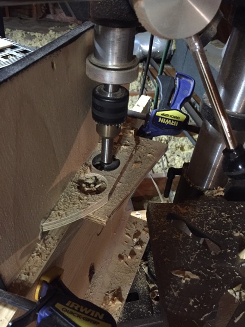

Based on advice in this thread I drilled out my access panel braces.

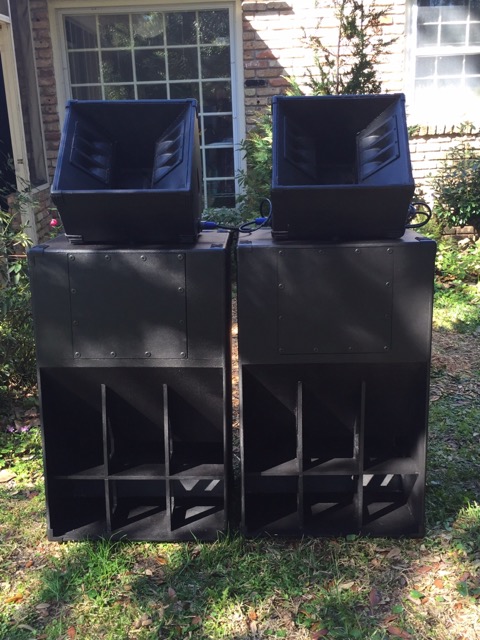

I bagged off the day job early today (TGIF) and dragged the Titans to the backyard. I plopped my W8s on top, cabled everything up, and had a go at it.
No EQ, just wanted to get a sense of what kind of thump we're in for. I played a few 80s favorites from my iPhone, and was actually afraid to crank it up any more than I did.
This is gonna be fun.

They turned out nice

Thanks commander! I'm actually pretty pleased at how square they came out, and that Duratex is just amazing stuff. Very lightweight too, and the recessed casters are the bee's knees.
Once the OTs are done (at least two of them) I can set the whole rig up, EQ, crossover, limiter, and everything, and take some voltage readings. My guitarist has a place out in the country; I think I'll drag it all out there for the real test run.

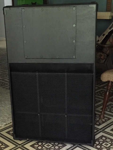

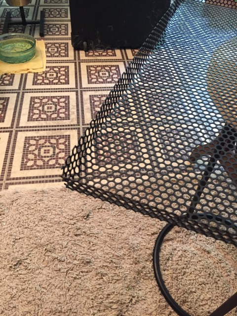

Finally got my grills done.

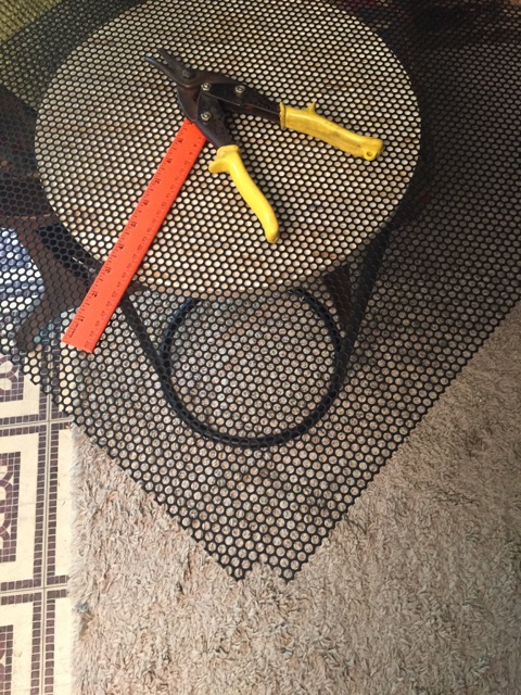

I bought some bulk grill material from DJPhatman a while back. Since then I've been devising the best method for constructing and attaching the grills. Here's what I came up with:
First I cut the material down to size, using an abrasive blade in my hand-held circular saw, one inch oversize in each direction. Then I cut one inch squares from each corner using tin snips.

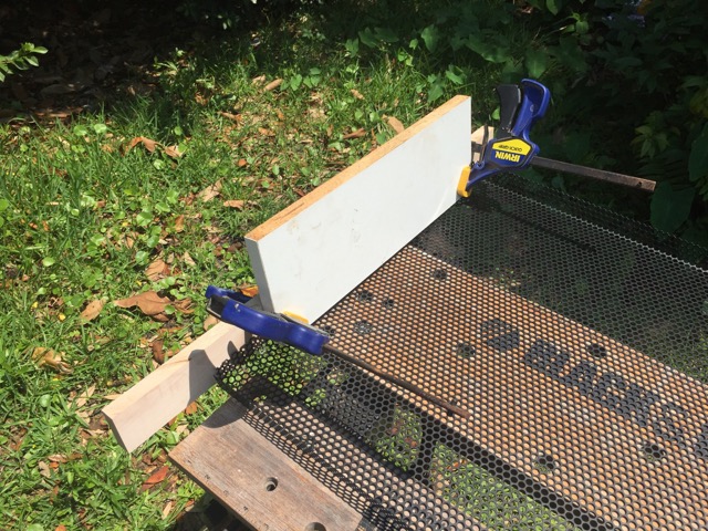

Then I used my WorkMate and some scrap boards clamped to the metal to bend 90 degrees along each edge, one inch in width.
I placed felt buttons at the ends of each brace, and cut one inch (well, slightly longer, so they could compress a bit) sections of automotive fuel hose to use as standoffs for the two screws I put where the braces cross.
Voila!
Not tested yet. If they rattle I'll just have to add more screws and/or felt.

I'll go out on a limb here.....they will definitely rattle without a whole lot more screws in 'em.
Re: Another T39 build
Agreed; I imagine there's a good chance you're right. I'm prepared to add more screws!
