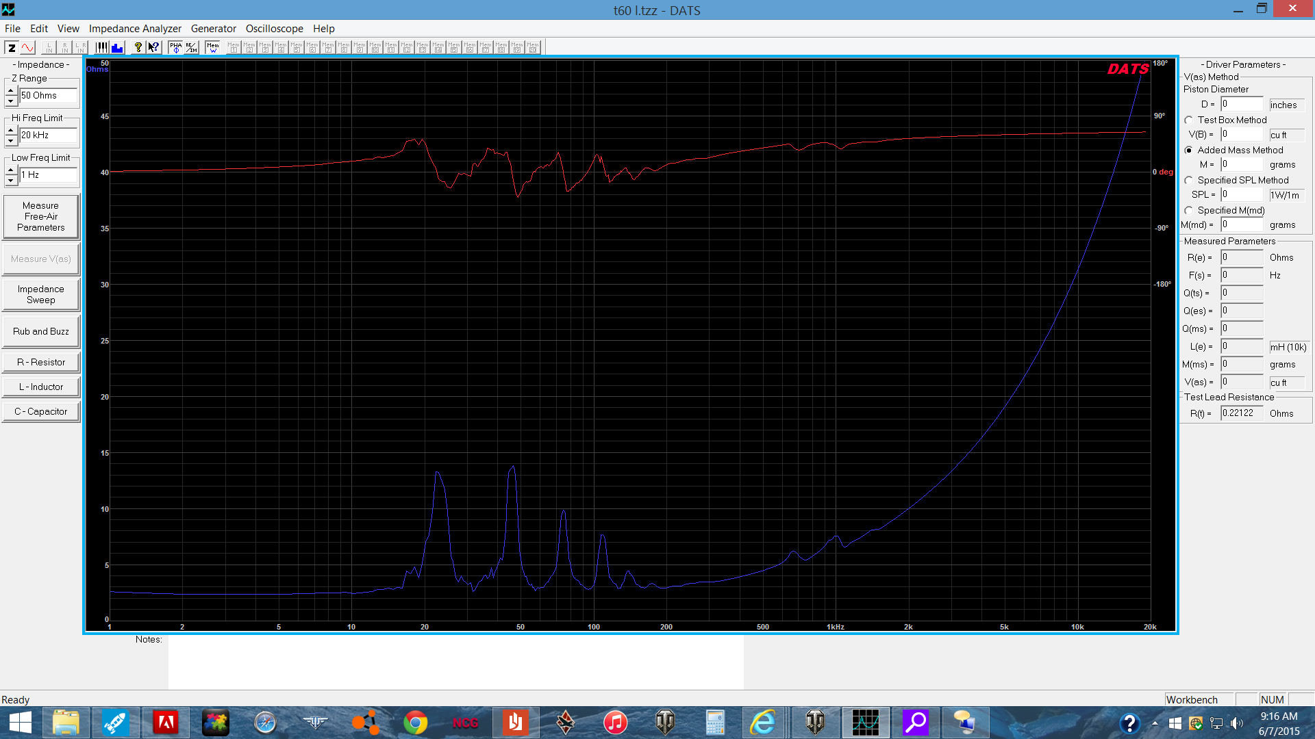

I finally got around to doing an impedance sweep (using DATS) of the dual T60's. If you click the link, then click the magnifying glass with the + sign on the upper right it will go to full screen so you can see it better. Every time I did the sweep the heights of the peaks changed a bit. I'm not sure if they look ok or not. Anyone have any comments?
EDIT: They were wall loaded when I took the measurement if that makes any difference.

Those charts look right. The main concern is the peaks, which are where they should be. There's a bit of raggedness compared to 'perfect', but that's to be expected with a folded horn.

Thank you Bill for looking at them. They sound great, just wanted some reassurance.
