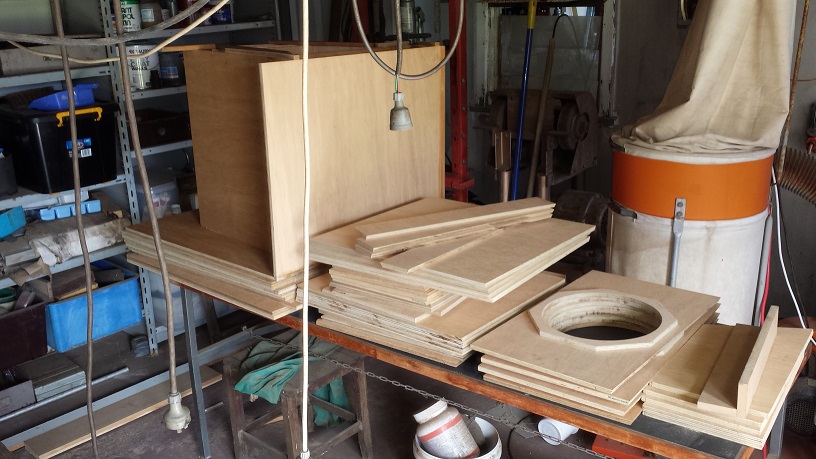

Days 8/9: So, busy week/weekend. We got panels 3-7 cut and stashed for the remaining cabs, and got up to P9 installed on the 2nd cab by the weekend.

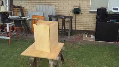

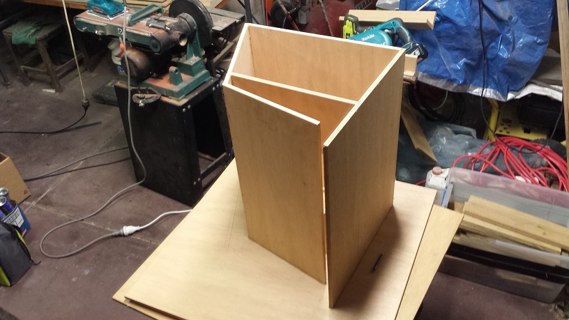

Cab 2 progress.
Cab 2 progress.

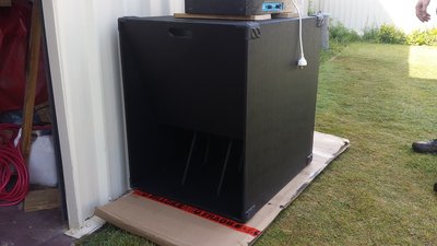

Cab 1 complete
Cab 1 complete

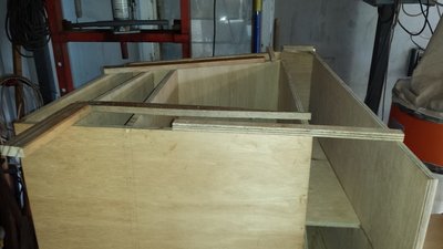

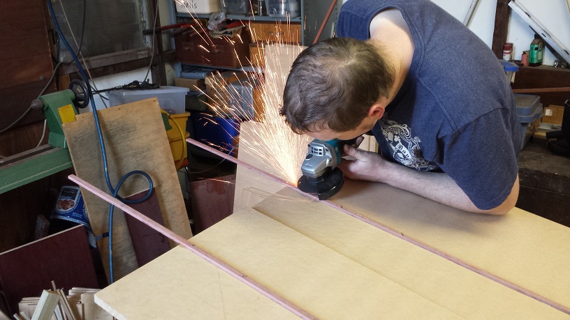

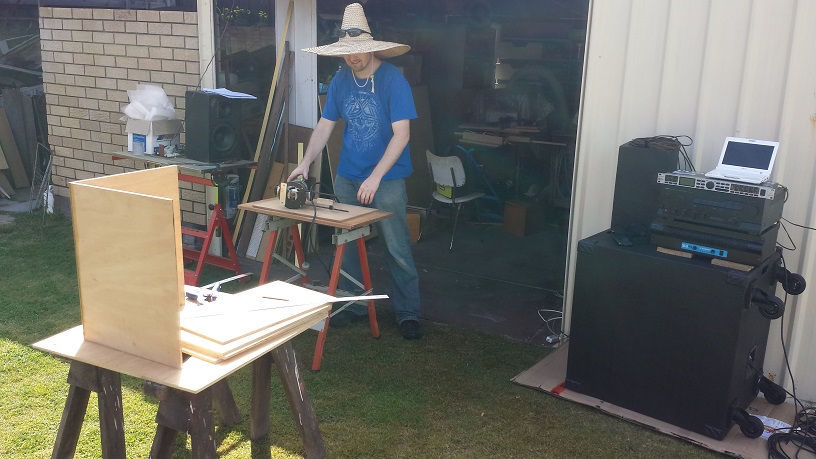

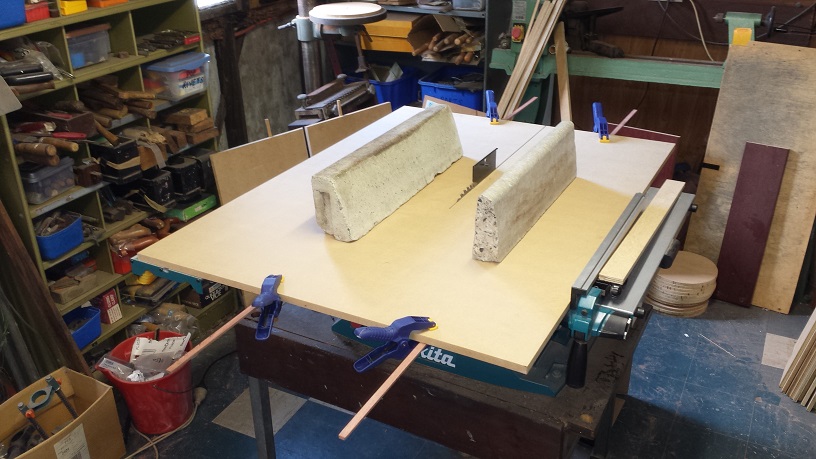

Day 10; our panel jig had developed some slop in the rails which was becoming a problem in getting dead square cuts, so we decided to make panel jig mkII, this time with jarrah rails instead of plywood. MkII was made significantly bigger than the first, and it turned out more balanced and accurate. We got a couple more panels and braces installed on cab 2 with the remaining time we had in the afternoon. Not far to go before 2nd side install and then we can move on to cab 3..

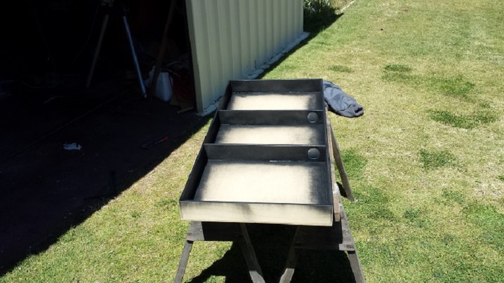

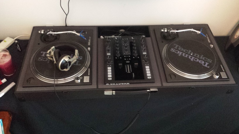

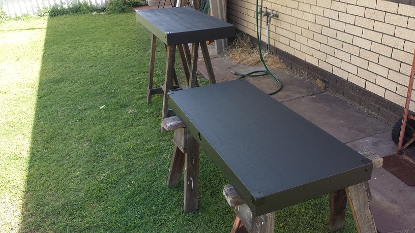

Side project
Side project
Side project duratexed

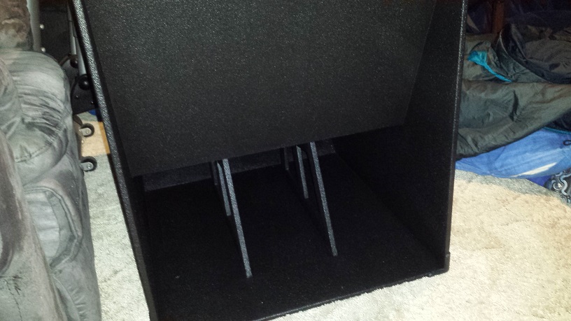

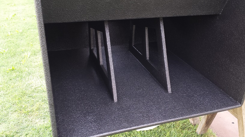

Cab 2 rear
Cab 2 rear

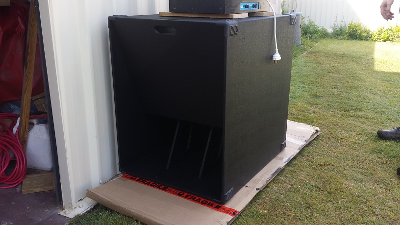

Cab 2 mouth
Cab 2 mouth

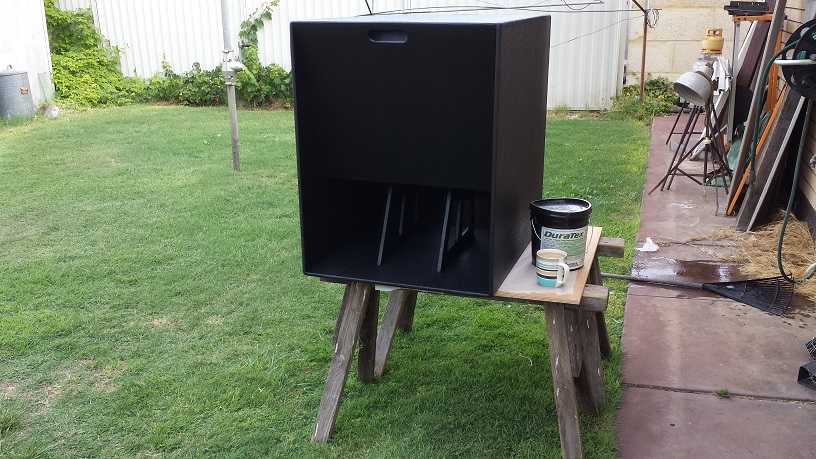

Cab 3 P1-5
Cab 3 P1-5

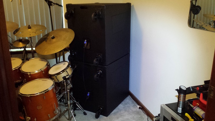

A couple of short sessions over the last 3 weeks has seen cab 3 complete and in its new home (my den). We are preparing to wrap this build up in a few weeks time when we can both get a chunk of time off. I'm finally getting the hang of duratex, apply generously! Some pics..
Side project complete
Cab 3 duratex
Cab 3 duratex
Cab 3 mouth
Cab 3 mouth

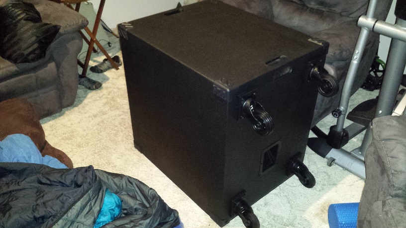

Cab 3 new home
Cab 3 new home
