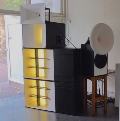

It's been a while since we started our own PA adventure with 'Communi-fi Sound' but I thought I'd give you an update on the latest with our system. Based on the solid foundation of 4 BFM Titan 48s loaded with Ande and 18 sound drivers we have now rounded out our Synergy horn top end with some mid/kicks courtesy of Sean 'BadmanSound'. We recently did some prettying up with LED strip lighting too. Very happy with the sound, and the punters seem to be too. Give us a like on facebook (https://www.facebook.com/communifi?ref=hl) to keep up to speed with the system and the different events we are doing in Canberra, Australia.
Here is a cellphone video of the soundcheck @ the ANU art school ball we did a few weeks ago- https://www.facebook.com/mark.lavis.33/ ... 720640927/
And a nice shot of Channel A (with our swish DJ monitors to boot!

Hi Rich, the post you mentioned was way back in our early testing days before we had our full set of amps- and Grant (and your) assumption we were sending the same signal to the old W bins and the titans is incorrect. We were sending different passbands to the two styles of cabs using the inbuilt crossover in the Crown amp (at this time the subs and W bins were run Mono until we had decided on other amps to buy). The notch in the passband (approx 300hz) was due to the limitations of the W bin design itself- not cancellation between them and the titans. The new kick is pretty damn flat from 100-300 and with a 105db sensitivity, plays very nicely with the rest of the system.

His unity horns only play to 250hz. The low mid cab is designed for 90-300hz.
