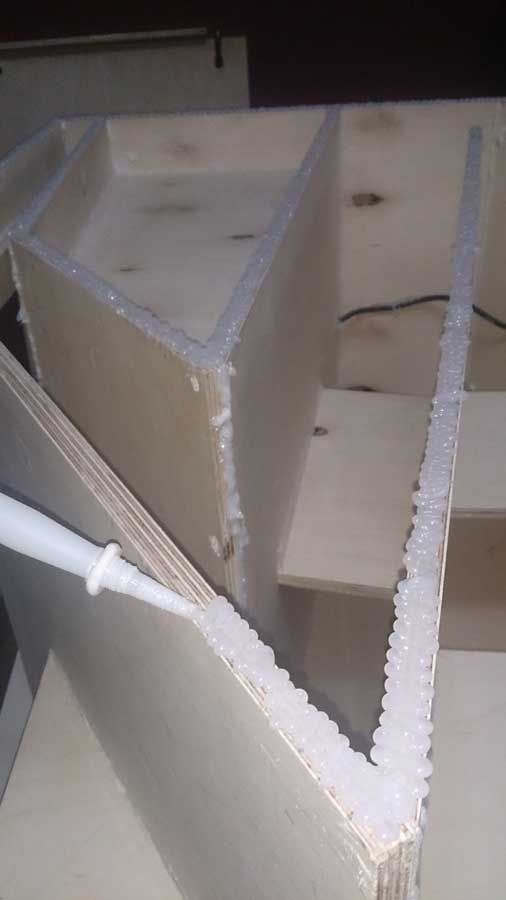

Got panels 5, 6, 6 extension and Horizontal Braces glued.
Figured out what happened for the misalignement. The anchor was not cut completely straight, as I glued the reducers They didnt stay perfectly flat in relation to side panel which left that gap on panel 4. The recut panel four will hopefully take care of this, but it meant that my 3 / 5 braces were a little bit too short ( about the same gap as panel four / baffle had ).
Had to recut them slightly bigger, and had to trim a bit on the 4/6 Braces as well. They now fit quite perfectly and have also been glued altough you can't see them in the pics.

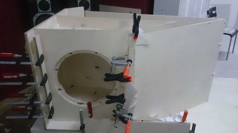

oh, and we've noticed that panel 8 has become extremely warped so when we tried to fit it we found out that we didn't have a jig with enough length to hold it on both sides so since panel 9 was perfectly flat we glued it first to later screw with panel 8 with a dewarping board. and hold the bottom side with 2 jigs to make it glue straight.
(We want to avoid drilling through side panel, wanted to try build only with jigs and clamps)

jmanso wrote:oh, and we've noticed that panel 8 has become extremely warped so when we tried to fit it we found out that we didn't have a jig with enough length to hold it on both sides so since panel 9 was perfectly flat we glued it first to later screw with panel 8 with a dewarping board. and hold the bottom side with 2 jigs to make it glue straight.
As long as you are able to remove the warp without causing issues elsewhere, good on you. You really should consider using a pneumatic brad nailer to hold joints while you are gluing panels together. It makes it much easier to keep panels from slipping and sliding out of alignment.

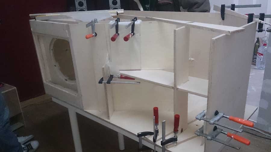

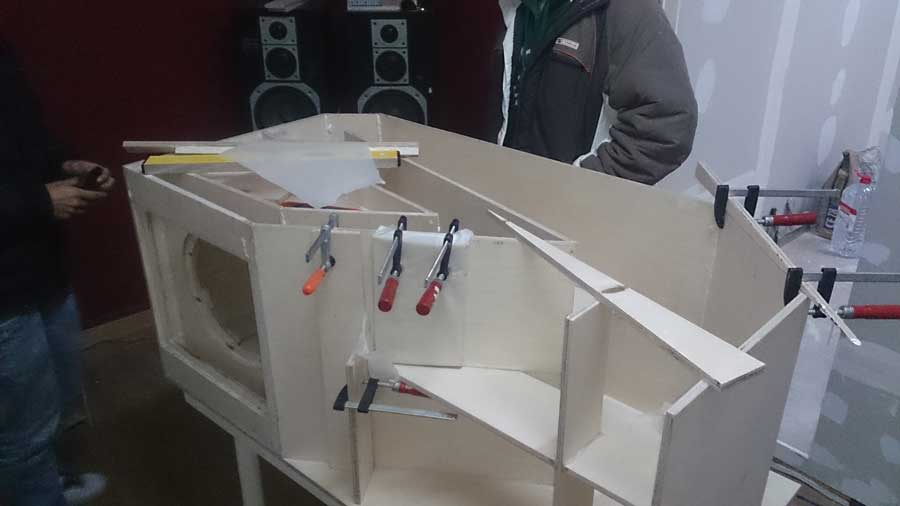

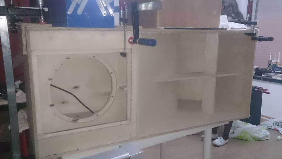

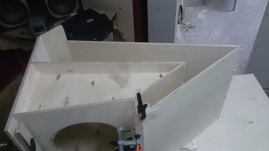

Easily the worst panel to glue, we finally have the 2nd side done!
We had everything set up, all clamped in place, and when we started adding weight to the center we noticed the side was slightly warped and eeeeeverything came out of place. we spent about 45 min re-setting all the clamps, only to find that upon placing weight on it again it came loose again.. 30 min later and everything seemed to stay pretty neat.
probably gonna have some leak in the back put hopefully nothing that we can't correct.
Most important lesson learned from the build.... Use screws !! We're definitly taking that approach on our 2nd titan.
It may be prone to having more mistakes since we have no carpentry experience, but at least it assures the final result with a bit more work.
Anyway, here's a couple of pics I managed to get, before setting panel, and final arrangements.

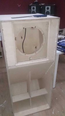

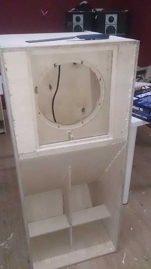

Finally, an update... it stands !! it's sturdy ! it's a little crooked but for first attempt with 0 carpentry experience I must say I'm pretty happy with the result so far.
We tried loading the driver yesterday, to make sure it would stand correctly and everything fit perfectly.
One question I have, how do we test for internal leaks ? I placed a flashlight between panels 2 and 6 to look inside and there was squeezeout everywhere so I'm assuming it's ok, but is there any way to test for sure ?
We did find a leak on one corner where there wasn't enough weight but addresed it yesterday will pay special attention when testing.
Posts: 7619
Re: First Build. Titan 48 w Lab 12.
#60 Post by Tom Smit »
While building, some people have shone a light at the bottom edge of each panel after it was installed to see if light appeared on the other side.
The rest of the answer is on the top of page 26 in your plans. (my typing finger hurts :mrgreen: )
