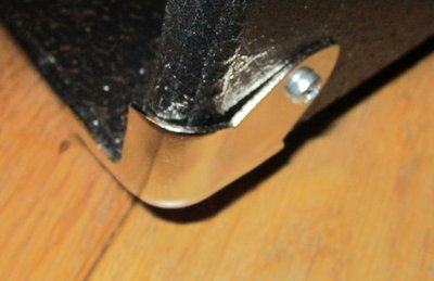

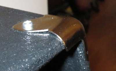

How did you manage to bend the steel corners on the top front edge? Brute force & a big hammer, or some other, more refined method? I've been thinking this conundrum over for several weeks, as I plan my 210 build. Having built (& heavily used) the 212, I've decided corners are a must. The angled front is the fly in the ointment...

More like gentle force with a small hammer! I aligned the corner with one edge and fixed it with the first screw. I then tapped the corner into shape with a small ball pein hammer, protecting the metal from dings with a bit of scrap ply. Once it was pretty much aligned with the second edge I fitted the second screw to pull it into its final position. I wouldn't claim they are perfect, but I've seen shop bought cabs which were no better.

Oxonjohn wrote:More like gentle force with a small hammer! I aligned the corner with one edge and fixed it with the first screw. I then tapped the corner into shape with a small ball pein hammer, protecting the metal from dings with a bit of scrap ply. Once it was pretty much aligned with the second edge I fitted the second screw to pull it into its final position. I wouldn't claim they are perfect, but I've seen shop bought cabs which were no better.
+1
I use a plastic deadblow hammer.
