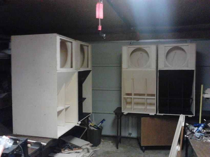

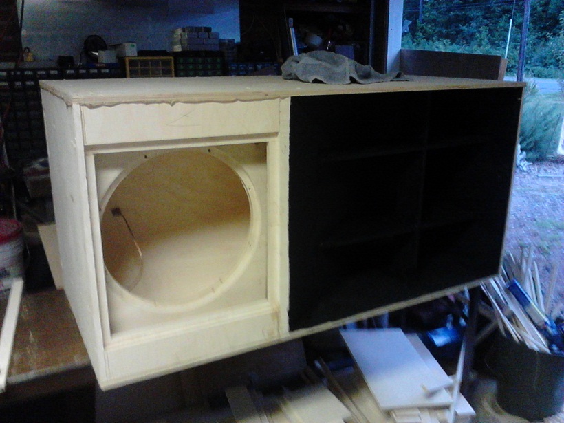

Home sick today, but couldn't resist finishing up the flanges on cabinets 3 and 4 as well as panel 11(bottom angle). I painted the throats of cabinets 1 and 2 Sunday afternoon. Getting ready for the great 'second side' adventure on Thursday night.
Time for a nap.....

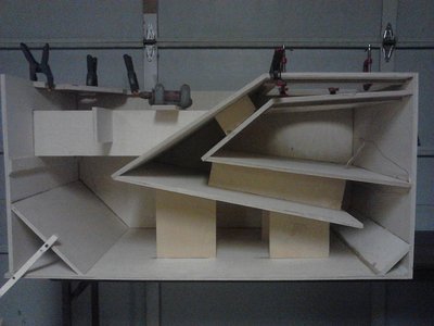

draehn wrote:Couldn't help from going out to the shop again before bed.... Last two sets of 6/10 braces in.
Ah, now I see your brace jig! What a great idea. /stolen Just in time too; I do my 6/10 braces tomorrow.
Er...I don't see any clamps holding that strip of wood in. Double sided tape? Shorty brad nails? I think I see two screw holes though...
David Raehn
- Posts: 676
- Location: Colonial Beach VA
Re: yet another T48 and OT12 build thread.....
Yes there are two screws holding it in place. I can actually take that strip out now because the bottoms of the braces are screwed in, but I'll wait until tomorrow.

Cool, thanks. Did you toenail the tops of the braces in, or is that weight resting across the board taking care of it?
David Raehn
- Posts: 676
weight only.

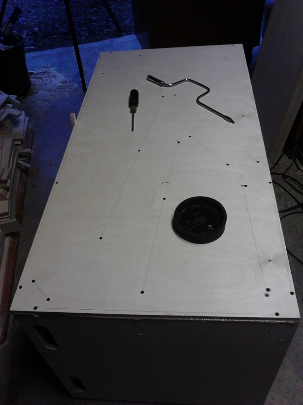

Started putting the second sides on cabinets 1 and 2. Had to chase a tiny bit of "Outt-o-square" around here and there but finally got them to submit. Good squeeze-out all about. 1/16" here and there will disappear during finishing.
Taking a short break after the first two. Even when it goes well there is still a great amount of mental anguish involved!
Don't freak out: The big black circle is the rubber cup I keep my screws handy in ( called a fernco cap fitting).
