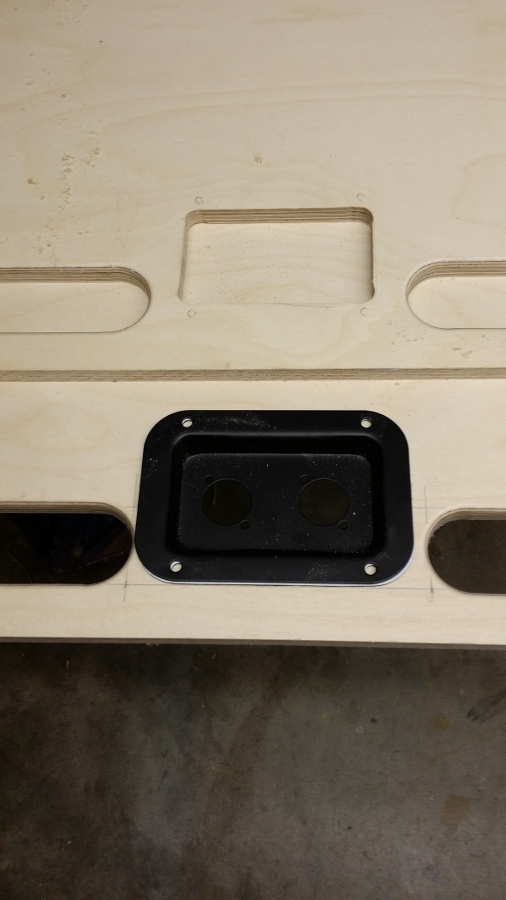

				My first task today was to cut the holes in the back for the jack plates.  I used a similar technique to what I used for making the handle template.  I used a 5/8? forstner bit in each of the 4 corners, and then cut between them with a jig saw.  Then I set up a pair of BB strips tangent to the holes and finished them with my router.
For the second back, I used the first as a guide for the router.  This went much faster!
