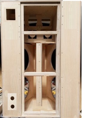

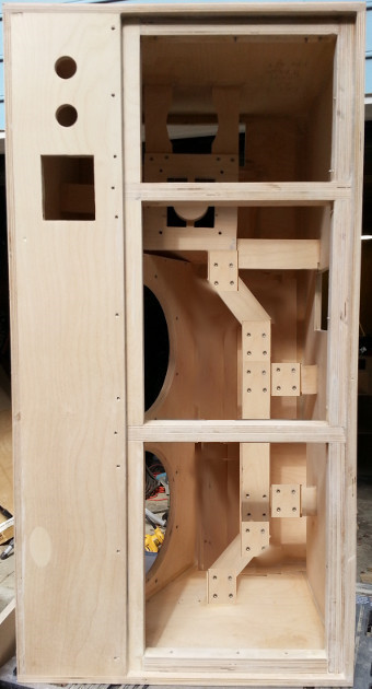

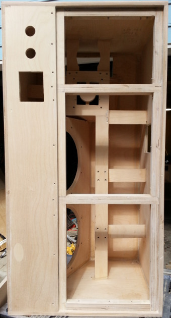

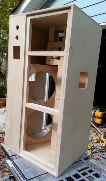

State of the Cabinet-note the position of the internal vertical brace, which is wrong and prevents the woofers from being mounted. This brace will be cut top and bottom, about 2" from the ends, and displaced 2" to the right as viewed from the rear of the cabinet. All existing attachments to the distal ends of the braces will be preserved.

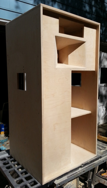

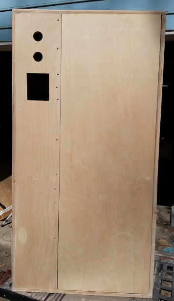

Dry fit of back panel:

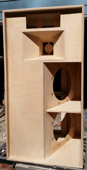

Front views:

So all you have to do is cut out that vertical brace and the woofers will be able to fit? Have you checked to see exactly how much material needs to be removed from the brace in order for the woofs to just squeeze by? What I'm saying is that maybe you only need to grind away a 1/4" deep by maybe a few inches long and the woofs can squeeze in. This is similar to what has to be done in Titan subs where the access opening is very slim. The flanges get ground down a little, in the middle, to let the drivers' magnet squeeze in. Please check before you go cutting things out. That vertical braces is what, 3" wide? Even if you cut 1" deep by 6" long it would still be plenty strong. CHECK.
ALSO: If notching out the brace truly won't work, then just cut a section of it out, mount the woofers, then cut a longer "patch piece" to rejoin the two separated ends of the brace. PL and screw it in and it'll be plenty strong. No need to destroy a beautifully-built cab.
The horizontal cross pieces on the back panel flange aren't in the way, are they? If so, just chop one out and reglue later.

miked, I've looked at the amount of grinding that would be required and it's a lot, both of that vertical brace and of the back flanges. Will make absolutely sure as you suggest, but at the moment the best (and even easiest) fix looks like to cut the vertical brace loose top and bottom, and from the horizontal braces as well (5 cuts total), move the vertical brace to the right 2 inches, and refasten it with screws and PL, with the probable addition of little plates to strengthen and stiffen the joints.

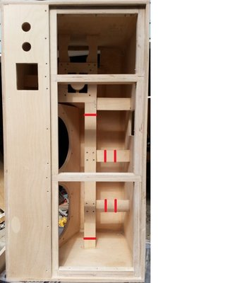

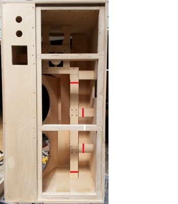

So here's a hack at showing the plan: a 'shopped photograph showing the cuts, and then another showing the moved brace:
The cuts:
The moved and refastened brace:
Sort of Frankenstein-looking but it should work I think, without stealing too much more internal volume.
Plates on both sides of the new joints btw. Once I had a broken leg "fixed" with a plate on one side only. The screws holding the plate fatigued and broke, and so did my leg again when the plate let go. That was an interesting educational experience.
