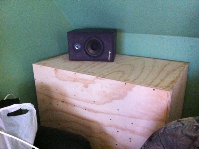

So it is now done!
Havent pu any finishing touches on it yet, and don't know if I will be doing that either.
Too lazy to take it downstairs again when I can watch another movie :hyper:
It's new home :D
It's new home :D

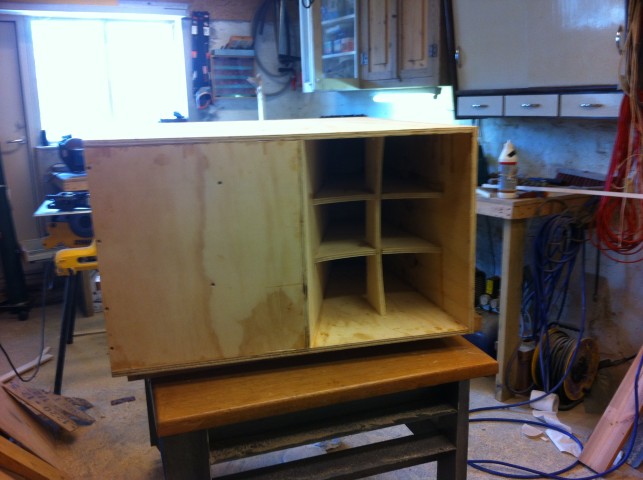

Waiting for the glue to dry.<br />This was yesterday around noon I was done.<br />Not until today was the glue dry, that wait was the hardest for me.

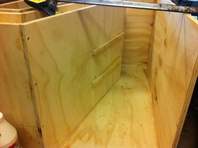

My dad is a genius!<br />We made these trims so we could place the hornmouth bracers more easily :D
My dad is a genius!
