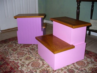

Along those lines.....last week, my neighbor across the street returned one of the two stepstools that I built for his grandkids as they have outgrown 'em. Inside, we had written the date and that he and I built 'em. Kinda' cool seeing that. And now I have one for my grandsons.
They were built totally from scraps in the garage.....
So, yeah....I do understand wanting to put a signature on your work.
