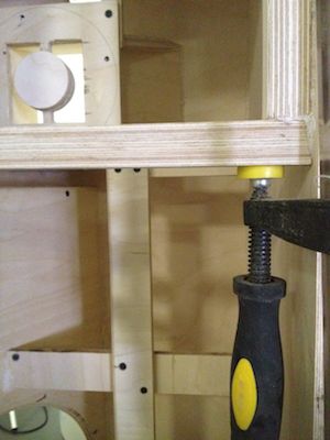

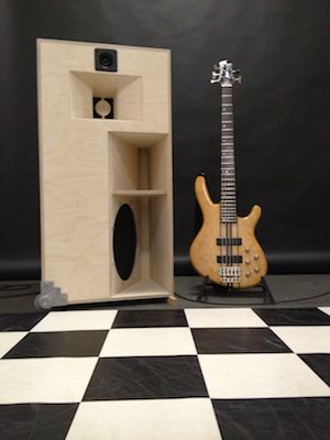

Kids to school again, me back to work again, it took a while to get back at it...
made and installed the braces and flanges, and put on wheels and a handle...
BTW I wasn't able to install the woofer because the tall vertical brace from bottom to mid horn was in the way. It was build according to the plans, and I did not check with the woofer installed. I'll be making an adapted brace but for now I removed a part to get the woofer installed :(
Attached the back panel and impressed every listener :D
Stll need to do the accoustic foam, but I noticed a problem with the mid horn. In my opinion the driver is hitting the phase plug. I hardly notice it when playing recorded music, but with bass it's really annoying because I can hear it at any reasonable sound level...
Still deciding on the color. I would prefer to not use black. Does anyone have any experience with Tuff Cab paint? I might go for white

Bas Gooiker
Posts: 752
Re: Omni 15 Tallboy - my first build
#54 Post by Bas Gooiker »
Wow, that is one sexy looking last picture. The bass and the cab together on that checkerd floor. :clap: :clap: :clap:
I dont know how flowless the sides are but i'd stain the front to mach the bass.
If i remember correctly Tuff Cab is what most of the Aussies use, you should be ok with that.

Bas Gooiker wrote:Wow, that is one sexy looking last picture. The bass and the cab together on that checkerd floor. :clap: :clap: :clap:
The problem here is that I have some sunken screws hidden with filler. You remind me of my wife, she said just the same about staining it to match the bass :D
But I don't know if I'm gonna keep this bass as long as the Omni TB...
Maybe I will paint the front black and the sides white. It would match the checkered floor :lol:
The Tuff Cab technical data says not to paint over anything containing cellulose solvents like filler, primers... I've used the two component type filler with hardener 1:50. It doesn't state anywhere that it contains solvents. Would it be safe to use Tuff Cab then?
