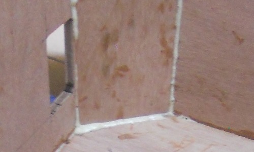

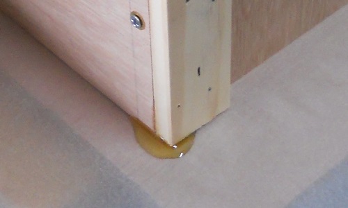

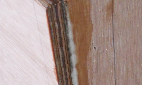

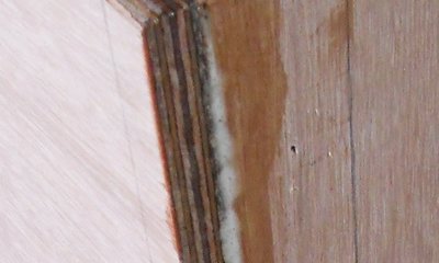

I have not tried either Locktite PL or Selleys Liquid Nails Platinum, but I have used Selleys Aquadhere Durabond:
http://www.selleys.com.au/adhesives/con ... -durabond/
The pictures below show its runniness, fizziness and what cured squeezeout looks like.
It sands perfectly.

That looks like what's called Gorilla Glue here, and it's nothing like PL. PL is very thick, applied with a caulking gun, and resembles the consistency of caulk. I've tried Gorilla Glue, PL is far superior.TrevorMag wrote:I have not tried either Locktite PL or Selleys Liquid Nails Platinum, but I have used Selleys Aquadhere Durabond:

Fair enough. While I have no concerns about joint strength if correctly applied, the runniness makes is suitable for applying to horizontal surfaces only.Bill Fitzmaurice wrote:I've tried Gorilla Glue, PL is far superior.

Make that 'perfectly level horizontal surfaces only'.TrevorMag wrote:...the runniness makes is suitable for applying to horizontal surfaces only.

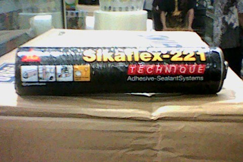

Harley, since you have been using Sika products, do you think Sikaflex 221 can do the job to build any of the BFM designs?
How about Bostik the 'sausage like' PU adhessive ?

The crucial part is that it expands while curing, this probably doesn't.Icecake wrote:Harley, since you have been using Sika products, do you think Sikaflex 221 can do the job to build any of the BFM designs?
