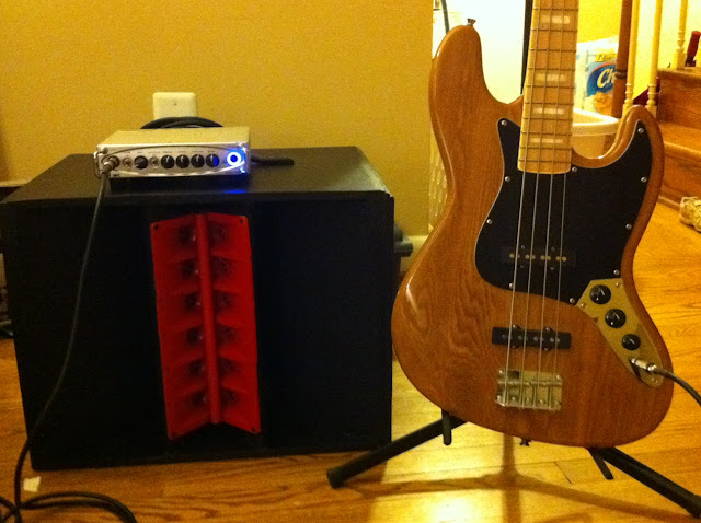

Very nearly finished. The glue is holding the handle on top very well, so I'm going to (sorry) stick with that. Fixed a bad solder connection on the jack plate and did a bit of touch-up painting. Then it was past time... hook it all up and see how it sounds!
The amp is a GK MB200, eq set flat and volume is around 1 because the kids were sleeping. It just sounds terrific. The clarity really shines, I can hear the subtle aspects of every bad fingering I make. Which are a lot. Here are two clips... one has some noodling at the low end, and some slapping to compare it to. The other has a few lines up higher on the neck. The bass is an SX Jazz with a maple fretboard with both PUs all the way up.
This was recorded with my iPhone's Voice Memo app, phone about 2 feet in front of the cab.
http://dl.dropbox.com/u/635475/Memo%282%29.mp3
http://dl.dropbox.com/u/635475/Memo.mp3
