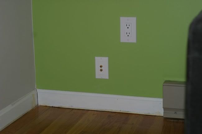

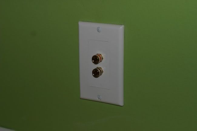

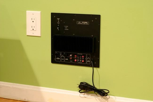

UPDATE! I got my amp installed today! Now I need to go downstairs and finish up the TT
After the amp was installed, I realized maybe I could of put the amp on the other side of the outlet to make it a shorter run for the power cord but in the future, I'd actually like to remove the power cord from the front and have it come out the back into it's own power feed to give the install a cleaner look.
I did put it on the right for a reason though, which is because the AVR will be on the right side of the entertainment center and it will be a shorter run for the subwoofer cable.
Check it out!
Yes, I still need to touch up my trim
I also noticed the last few pictures I took inside that room are way off color, the door is freakin' yellow (yukk), not white like it should be. Oh well, gotta work on my photography skillz :p
Check it out!
Re: Table Tuba build!!
Same color and trim I have in my living room. Looks great. I can't wait to get to a point where I'm installing equipment like this in here. This is inspirational for sure. Nice work!
