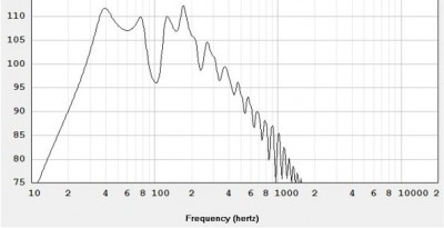

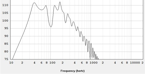

metaverse wrote:Also ... did you ever pair any omnitop 15's with those THT's ??
I'm in the process of getting together a build and after reading this thread won't be building the 12's for fear of the mids missing ...
Metaverse, running a THT without the access panel creates a massive dip from 75-120hz. and response below 38hz dives.. this graph of the THT with no cover tells the story..
with the panel as designed..
