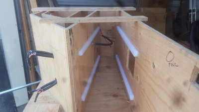

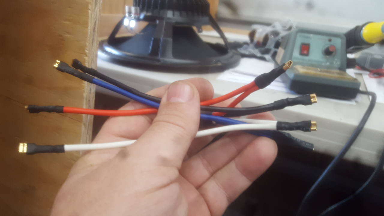

I didn't get as far along as I wanted today. I forgot how long it takes to do a decent job on the wiring. Even after tinning the ends, my soldering iron was at it's limit trying to put enough heat into 2 12ga wires. Had to crank it all the way up to 890ºF, put as much solder on the tip as it would hold without dripping off, give it 10-15 seconds to come up to temp, and still had to heat the joint 20 seconds or more to get a decent outcome. I'm a bit of a stickler for good solder joints. Anyway, got all 20 spade connectors done and shrink wrapped.
I chamfered the hand hold and wiring holes in panel 8. Then cut the 5/8 braces and used the router and circle jig to put lightening holes in them. I know I like things as light as reasonable possible, but I'm beginning to wonder if lightening the braces is worth the time and effort. Maybe I'll just do 'em quick and dirty with a jig saw in the future. It takes a bit of time to make 'em pretty and fairly concentric from one to the next.
Also gooped up the holes the wire passes through with PL. Could have done that yesterday. Oh well.
At that point I started making mistakes, so I called it a day. I'll get 8 and 9 attached tomorrow. Maybe put some holes in 10 for the handle and casters so it's ready for assembly Saturday.

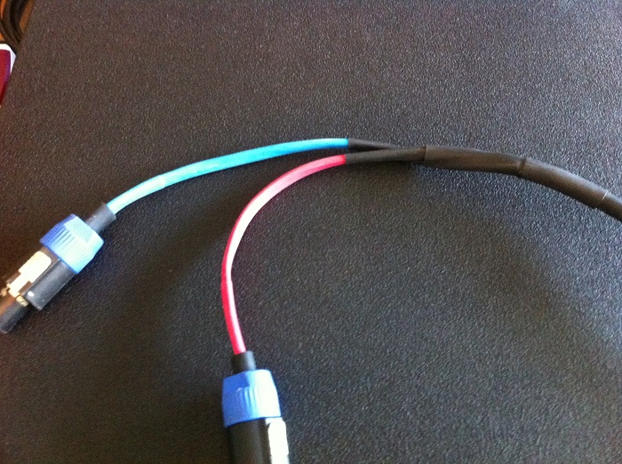

Or, as I've mentioned before - split the pairs using some heat shrink and put an NL2 on each split. One goes to Sub 1 (sub 2 get daisy chained). The other one goes to Sub 3 (sub 4 gets daisy chained). All connectors use 1+/-. No turnaround cables, or adapters and all connectors are interchangeable. You can either split the end at the rack or just use the NL 4 with one channel to 1 and the other to 2.

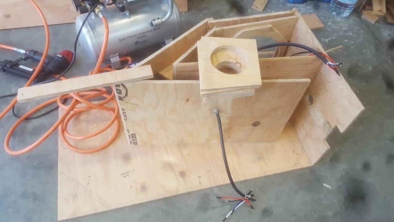

Things went pretty well today.

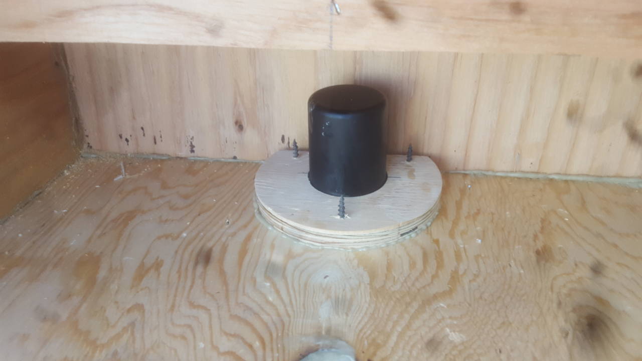

I decided to put an anchor under the Top Hat. Box is upside down in this photo.

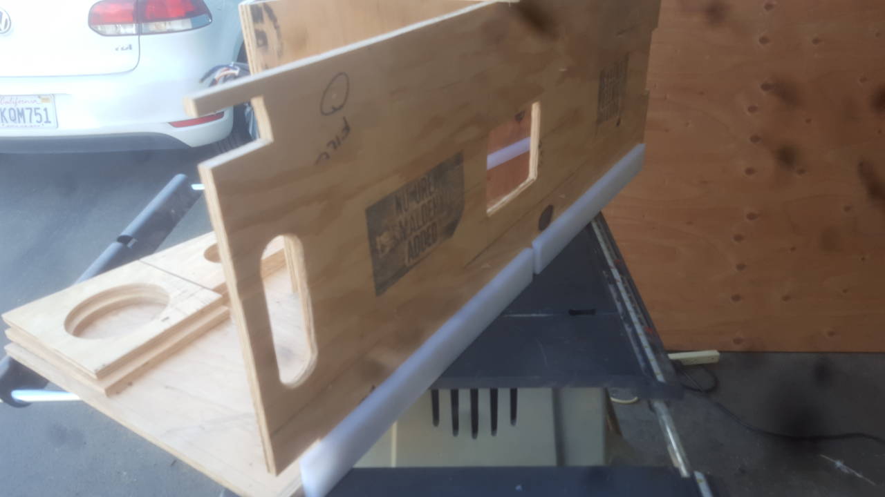

Hot tip! Cut up a HDPE cutting board to use as guides and stops. PL wont stick to it and it's easy to pull brads through once removed from their duty.

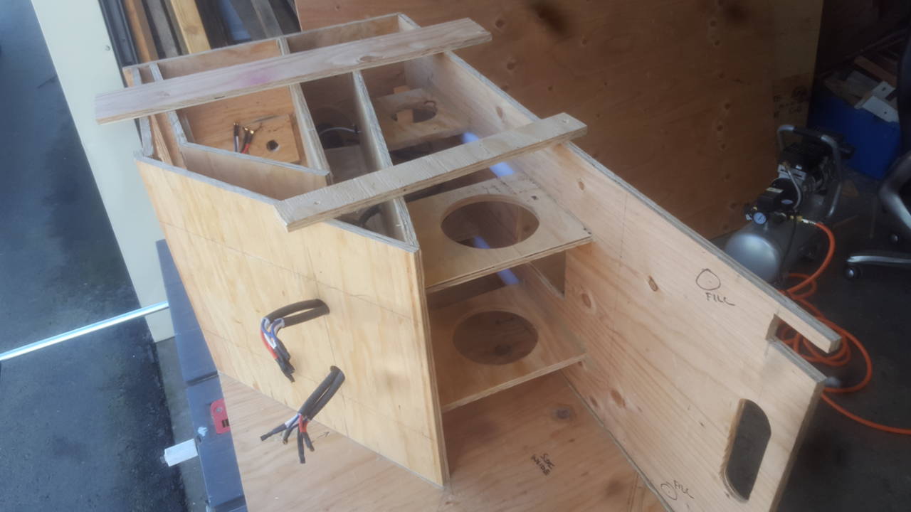

Panel 8, 9, as well as 5/8 braces installed
If you look at it from a certain angle, close one eye, and squint the other... it looks a little like a box now.
I feel like I'm coming down the home stretch, but I know there's a lot of finish work ahead of me to have things look nice. Bondo, sanding, painting...

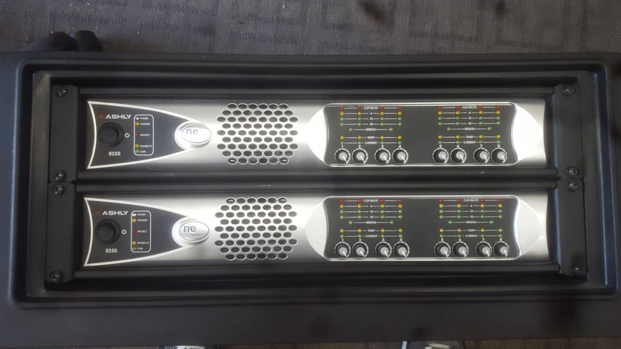

Here's 16 channels
And, with the Dante network, one ethernet cable per 4RU roller is all that's needed to get all signals in. No rat's nest of XLR's to fumble through.
Power, Ethernet, and 4 speaker cables per 4RU roller case (one each side of the stage) and it would be ready to make noise. Doesn't get much easier than that.

I like that. Could even do it as an "adapter", giving the option to do it either way... NL4 or 2x NL2's

Geez....didn't know that you had 8 channel power amps.. But, you can still double up per channel if they are 4 ohm capable...especially for the tops.

How are you gonna' get enough power out of those to run subs?

OMG, that's some serious amp candy! Did you score a crazy deal, or sell a car? Drooooooool :mrgreen:

Bruce Weldy wrote: Sat Mar 21, 2020 8:12 am Geez....didn't know that you had 8 channel power amps.. But, you can still double up per channel if they are 4 ohm capable...especially for the tops.
Yeah, absolutely could double up tops per channel. A while back there was a thread on how much amp DR200's need, pretty sure anything over 100wpc is good to go. J_Dunavin mentioned that he had his limited at 25v and had never hit the limiter.
Bruce Weldy wrote: Sat Mar 21, 2020 8:15 am How are you gonna' get enough power out of those to run subs?
The options are to either double the sub count and run Delta 12LFA or Basslite S2012 loaded cabs limited at 35v or Bridge the channels and run 3012LF's in less cabs.

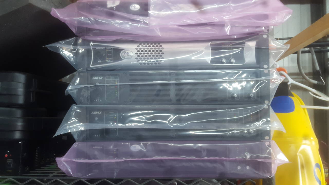

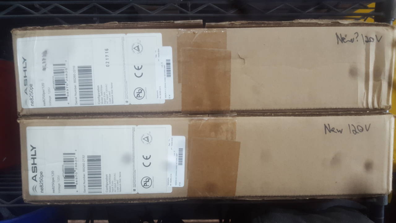

himhimself wrote: Sat Mar 21, 2020 10:17 am OMG, that's some serious amp candy! Did you score a crazy deal, or sell a car? Drooooooool :mrgreen:
Man, I got such an unbelievable deal on these things. Insane. I think that because they're able to be networked, a lot of tech companies bought them up in quantity for their offices or whatever. When they go belly up a salvage company comes in and liquidates all the hardware they can on ebay. And because the amps are so high end, no one is searching for them. That's the story I made up anyway. Makes sense to me.
New, these (ne8250pe) sell for $2700 a piece. The last two I purchased were new and unused in their original box for $357 delivered... for both! NEW!!!
I've also picked up:
2 pe1800's, won the auction for those $105, cost $80 to ship. One has the additional DSP card the other is regular. Less than $200 for both
2 ne800pe's, bought those separately at separate times but from the same seller, best offer. $100 each
1 ne1600pe...$79 plus the ride
All of them have AWESOME DSP (except for the one PE1800) and all are accessed, monitored, and modified via network.
By the way, 24" x 36" 4-6mil bags are great for storing amplifiers.
