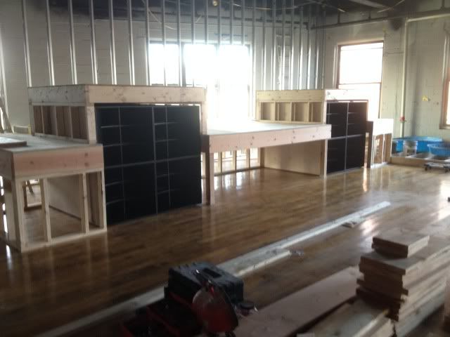

Hey guys.. I've been busy getting the build out finished and I had a last minute revision.. I originally was goin to run 8 tubas side by side underneath the main stage but it looked kind of boring. The last Club Therapy was know for the big Martin Bass Wall it had. So my resident DJ asked me if I could do the same thing so the people who dare, could stand in front of it. We would just stack 4 more FAKE Tubas, 2 on each end. So I re-built the stage to accommodate 4 more Tubas (12 total).. The pic shows only 8 of them cus I have to build 4 more.. So the big question is should I build four FAKE Tubas and just let the bottom row of 8 be functional or does it go against the rules to run all 12?

I remember in one of the architectural drawings you posted the main stage was much bigger. I'm assuming the lowest platform in the middle is the stage? That looks to be about 8'x10' if that big. I'm assuming the DRs will sit on the platforms, in the cage you're making, on top of the Tubas? What goes on top of the platforms on the ends, then?
Will four more (real)Tubas fit under the stage? If so, run'em like that. That way you get little to no power alleys and your DJ gets what he wants, and gets to see idiots go deaf standing in front of the 2x2 stacks. :D I really don't see a point to fake Tubas. It's not like having fake Marshall Stacks on a stage and from 100 feet away they look real. Anyone can walk right up to the Tubas and tell which ones are not playing.

miked wrote:I remember in one of the architectural drawings you posted the main stage was much bigger. I'm assuming the lowest platform in the middle is the stage? That looks to be about 8'x10' if that big. I'm assuming the DRs will sit on the platforms, in the cage you're making, on top of the Tubas? What goes on top of the platforms on the ends, then?
The center of the stage (DJ booth area) is 10x12.. The 2 platforms are for the dancers/performers.. The space on the outer edges of the stage will be where the the cage holding the DR's will mount..
Yes 4 more tubas go under the center of the stage, So there will still be 8 functioning tubas side by side like the original plan..

OK, I get it now. The "stage" is a DJ booth. Got it. Plenty of room in that case. I was just trying to imagine fitting a 4-piece band up there with amps, monitors and everything else.
Four Fake Tubas you could probably throw together in two days, especially with your jigs and your skills. I'm thinking just the outside box with the braces inside the mouth, and a couple pieces of 2x4" inside to brace the "box" left/right/front/back.
Making "real Tubas" is well, making real ones. Baffles, internal panels and all the assembly mess and stress that goes with it. Maybe I'm looking at this the wrong way? I'm looking at this "problem" like ONE OF US looks at it. First thing I WOULD DO in your club is walk up to every cab and stick my head in it to see if it's playing. And I think MOST folks on this forum would do the same thing. But your customers are not "sound people" or "musicians" per say. I'm sure some are but not the majority.
I guess one of the possible pluses (aside from adding to the eardrum-crushing bass you already have) to adding more real cabs is that even if you don't have them plugged in, they could always be used as spares for either that club or one of your other places. Just a thought.
