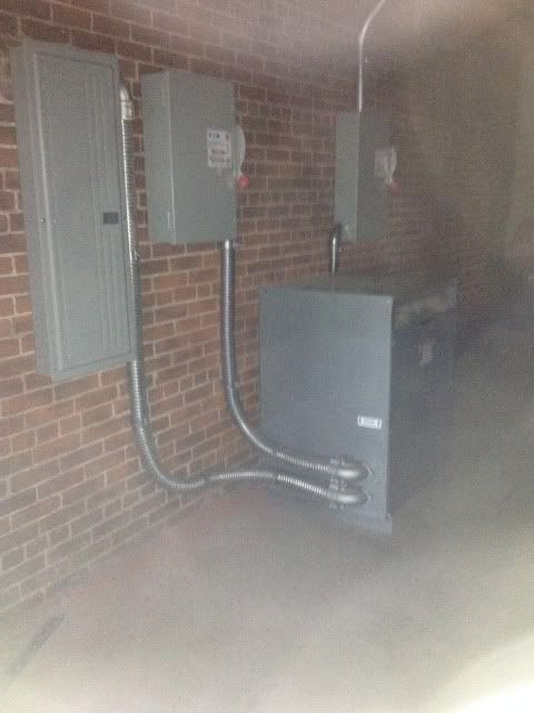

Now that's a beautiful thing. You've even got your own step-down transformer. Shiny new breaker panels and everything! Congrats!
- Scott Brochu
- Posts: 2473
- Location: Maine
Now that gives you the 1.2 Gigawatts you need!

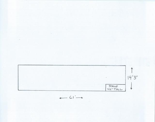

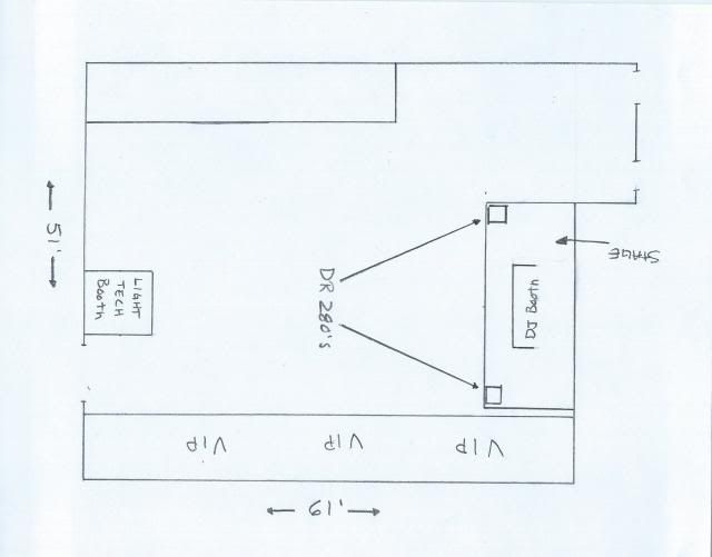

Ok fellas, I'm about to weld up the cage that will hold the DR's.. I need some advice on placement and height of these.. They will be located on the outer corners of the stage which is 25' wide. My ceiling height is 14' 3" so they can go fairly high. Here's a few pics to get a better understanding.
Am I better off getting them high up to the ceiling and keeping them curved or locating them lower on the stage and keeping them straight?
Assuming I keep them high, do I aim the top speaker in the array at the rear of the dance floor or is it more important to aim the lowest cab to the dancers closer to the stage?
HF more than anything else gets chewed up by running into objects like people.
Put it this way, if you had just one cab a side, the bottom of that cab ideally is 6 foot or so above the dance floor in your case.
But you have 3 a side, so the top cab should have it's face perpendicular to the floor, the cabs underneath that in a J (so the middle cab is roughly aiming between 1/3 and 2/3 to the back) leaving the bottom cab aiming towards in front of the dance floor to about 1/3 to 1/2 way back (Melded array for this cab if applicable).
Imagine equal space, say 2", between each cab bottom and top, working your way down and see how that splay works out for the bottom 2 cabs and coverage.
That should work out with your ceiling height and distance above dance floor height.
No brainer, adjust downwards (and mess with the lower cab angles again) if it doesn't fit lol...
Thanks for the tips Grant.. I'll have to figure out a temporary method to hold the cabs and test with.. I'm building a steel cage to hold the DR's so adjustments cant be made once its welded up.. The cage will be kind of artistic and will be mounted to the stage below.. This will solve the problem of not "hanging" the speakers and worrying about the inspectors.. Besides this ceiling is not to friendly to hang from..Grant Bunter wrote:HF more than anything else gets chewed up by running into objects like people.
- Posts: 29054
That. Aim the top speaker at the back of the room, tilt the others as required.hifibob wrote:Am I better off getting them high up to the ceiling
Ok thanks Bill.. So top cab will be slightly tilted down, basically aiming it at the dancers at the rear of the dance floor? Also should I toe the cabs in slightly at the center of the dance floor or just fire them perfectly straight out?Bill Fitzmaurice wrote:That. Aim the top speaker at the back of the room, tilt the others as required.hifibob wrote:Am I better off getting them high up to the ceiling
- Posts: 29054
Aimed at the furthest point in the room where you want it heardhifibob wrote: So top cab will be slightly tilted down, basically aiming it at the dancers at the rear of the dance floor?
With melded arrays I doubt toe in is required. In some rooms they actually give the best coverage toe'd out a bit.Also should I toe the cabs in slightly at the center of the dance floor or just fire them perfectly straight out?
Thanks Bill.. I'll have to try experimenting with the toe, even once the cage is all welded up i can easily rotate that, it was just the aiming of the cabs I cant change once welded up..Bill Fitzmaurice wrote:Aimed at the furthest point in the room where you want it heardhifibob wrote: So top cab will be slightly tilted down, basically aiming it at the dancers at the rear of the dance floor?With melded arrays I doubt toe in is required. In some rooms they actually give the best coverage toe'd out a bit.Also should I toe the cabs in slightly at the center of the dance floor or just fire them perfectly straight out?
