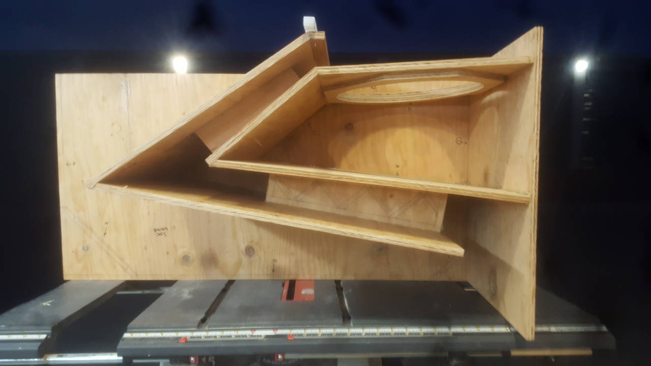

5, 3/5 brace, 6, 4/6 braces, and 6 extension installed today. Overall, it's all much smaller and more compact than I imagined it would be.
I also realized I made a goof, but I'll play it off as intentional. Because I'm just a wild rebel like that :roll:
Anyway, in reading forward, my next steps are to frame the access panel. I'm looking at the two options for the vertical supports I realized I chose a size that is not within the parameters of the plans. Went back and re-read the beginning of the plans again... "You must make a wide cab at least 1½ inches wider than a narrow cab." OOPS! This cab is going to be 16"wide (instead of the minimum 16.5" for anything wider than a 15" narrow model), so I'll have to trim a quarter inch off the vertical supports to get everything to fit properly. Shouldn't be too big of a deal... unless there's something else it will effect too.
Also picked up a bunch of brushes and rollers, a gallon of flat black outdoor latex paint, a gallon of bondo, and a few other odds-n-ends... spreaders and whatnot.
This thing's coming right along.

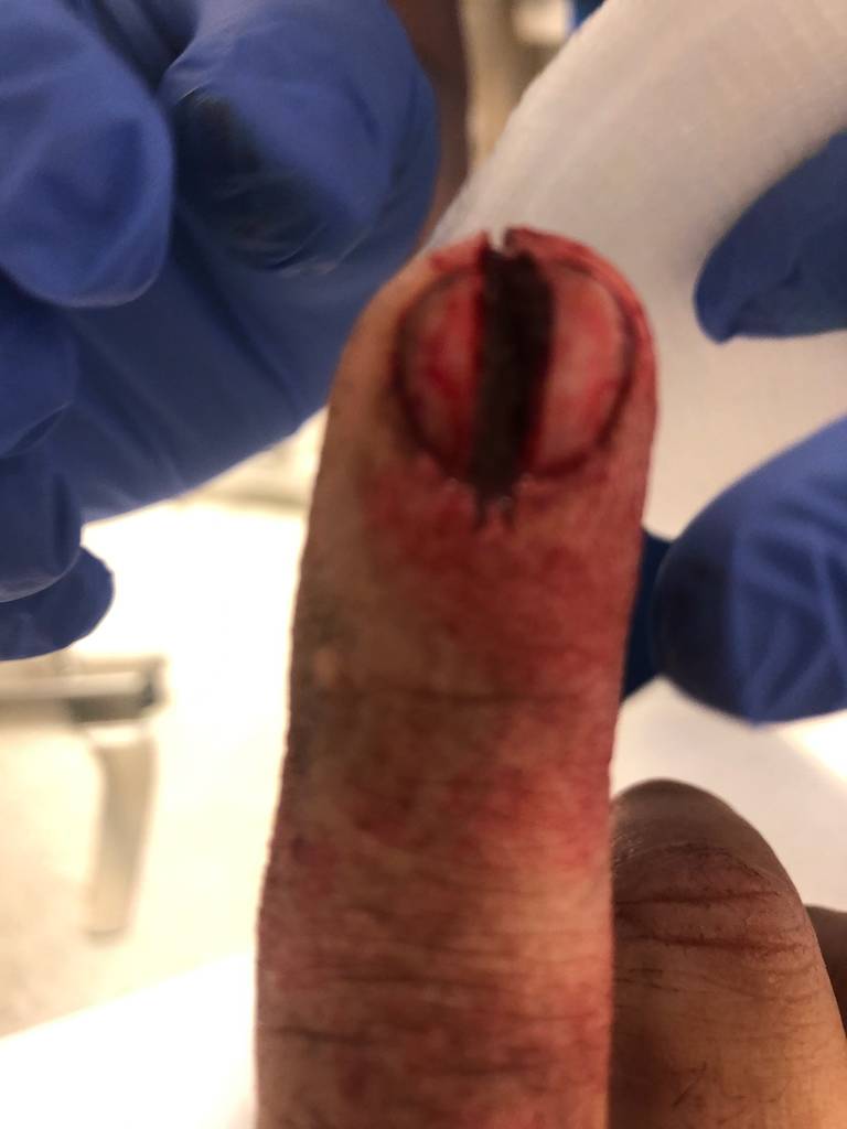

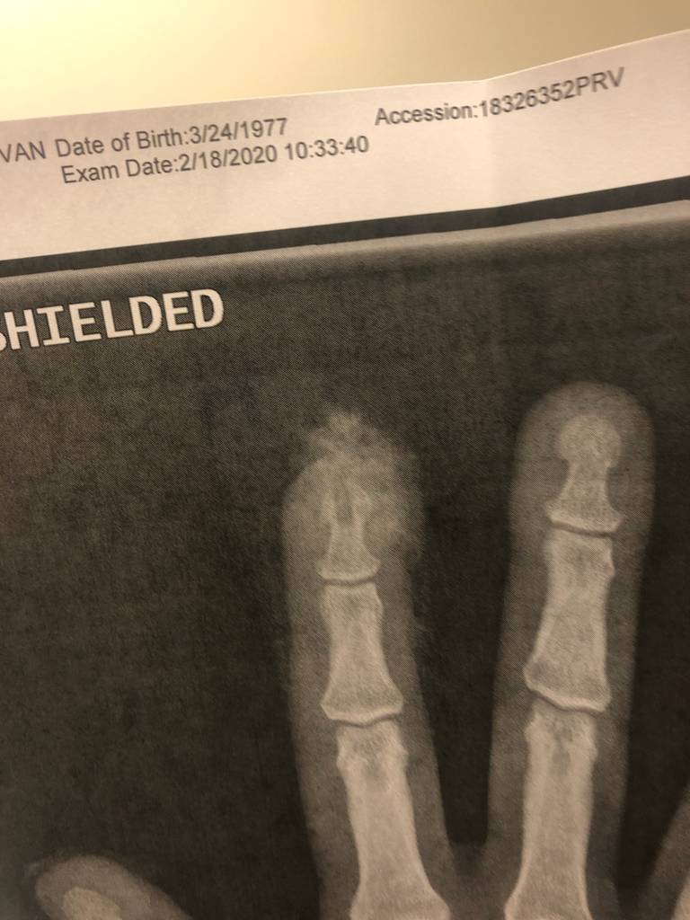

So, my Dad's (erm.. bio Dad, not the musician step Dad)... anyway, my Dad's brother, my uncle, has been a carpenter all his life and his son, my cousin, has followed in his Dad's footsteps. I was telling him about the build and he told me he cut his finger on a table saw not too long ago.
His young son bumped the end of the stock, it climbed the blade and rejected, his finger ended up you-know-where.
Note the blade pattern in the skin just past the cuticle, same as the leading edge when cutting wood. Also, the x-ray... cut right down the center of the bone! Precision carpentry at it's finest.
Enjoy.

Ewww. That's why I make sure no one is around when I'm using my big saws.

Looking great, Seth! And you can't really see much warp. Keep em coming.

Yeah, panel 3 shows a little, but overall... not too shabby.
